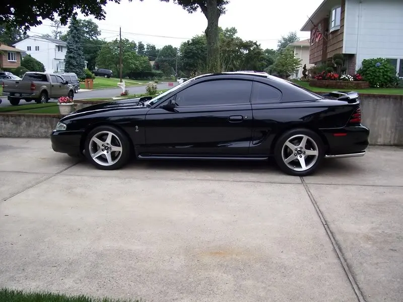

255/40/17 on the front, steeda sport springs.

95Cobraguy - Thanks for the picture. Every time I see your car I say to myself that I want mine to have the shine. I need to get painting!
