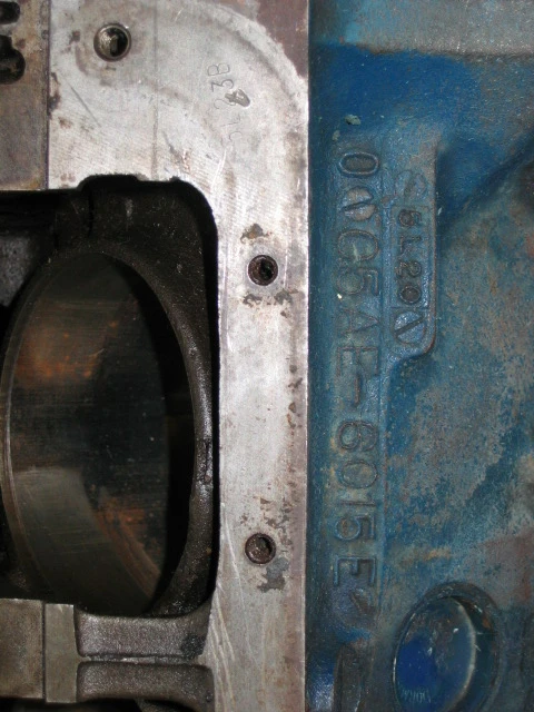

Look for something like this:
5L20
C5AE-6015E
(It is behind the starter if the block is still in the car. And you MUST remove the starter to see this.)

You've got a 289 block there. Cast on November 20, 1965. So I doubt it's the original block to your car, being cast nearly a full year before the 67's went into production.

that pic above isnt my block....thats runawayabc123's....mine does have a date of nov 3 1966, i looked up the heads today too, they were also cast on nov 3, then the engine build date of 11/4/66, i believe thats all the original componants, also have the intake tag, but i dont have it handy to list what was on it...
