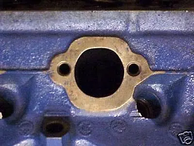

(2) The greatest performance weakness of the 289/302 is the Ford heads, with their tiny, restrictive exhaust outlets. These need to be opened up right at the constriction at the gasket mating surface. If they are later "smog" heads, the "bumps" for the smog ports have to be smoothed off, too. Doing this and this only will make the engine run as if you put a slightly better cam in it, and adding a cam without doing this wastes much of the potential of the new cam.

I have done the port-matching on my engine myself. Took me less than 2 hours, excluding R&R of the heads. If you are doing intake, cam, and headers, R&R the heads will add less than 2 hours to the job. Anyway, the port matching job made such a difference I could feel the difference before I left the driveway. Runs smoother at every speed, from idle to highway. The shift lever has noticeably less vibration on the highway.
I agree on the port job on the heads, but even that is more than your average weekend mechanic wants to tackle. It's really easy to screw up a good set of heads doing this job without knowing what you're doing first. Better left done on an old set of heads first, then moving to a serviceable set. I've done two sets myself but didn't use a running set of good heads the first time. I started with a $50 set of E7TE's for that. Also you have to add in the cost of a die grinder, air compressor and bits if you really want to go all out and open the ports up and bowl blend the areas under the valves.
Well, I'm not talking about a full port job, just trueing the opening to the exhaust manifold/header flange, and removing the Thermactor bump if any. There's a lot of meat at the opening flange, Crane proved that with their truly huge "Fireball" port, which started out as a stock Ford head. You can get a cheap die grinder at Sears that'll do the job. Fine for the hobbyist, they have half a dozen under $50.
This is the 289 Fireball, a truly excessive size, which required special headers:
Yea, but just opening the port flange seems a waste when even more power can be realized by opening the port roof and walls down into the bowls (which is what I did with the E7's and a set of D0OE 351W heads) I left the floors and short side radius alone, except to polish the floors and remove casting flash. Also need to add in the cost of a compressor to feed a die grinder, that's another $200 to $300 at least. It's another slippery slope involved here........................................:rlaugh::rlaugh::jaw:
