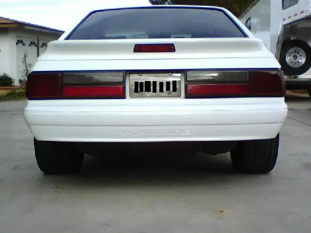

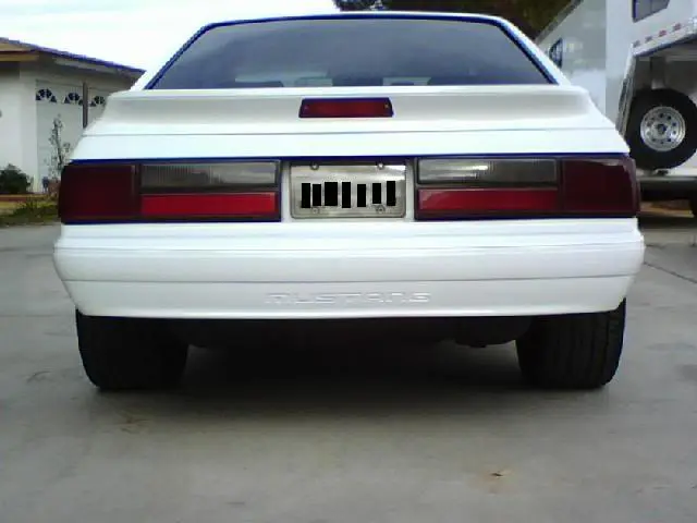

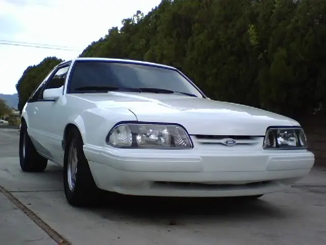

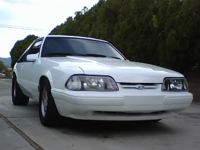

i got 295/50/15 on the rears and 265 50/15 on the front...I had to massage the inner fenders alot(not bad at all), I had the fender lips rolled, Removed quads, Eibach lowering springs, Lower control arms, The will rub if your speeding fast 80mph and hit a big dip or dip in the road. sometimes in parking lots the fronts will rub on max turn and I hit a dip in the road, not bad at all...As for on the stock rims the Im running 1 in bigger than the rim will allow The tire shop said it really should be on at least a 8" rim at the bare min, But he said it will be ok. Nothing bad will come out of going a 1in bigger. an inch wont hurt. I was pretty concerned when asking the tire shop, the rule of thumb for 295 tire was 8-10" rim and its mostly for liability purpose. He said it will be fine and nothing will happen, only the possibility of tires wearing alittle faster, it should be fine.

Regular street tires, I did LCAs for better traction, and because I heard If you remove quad shocks youll def need LCA's...Stockers suck and give wheel hop esp if you remove the quads...Pics yea..
