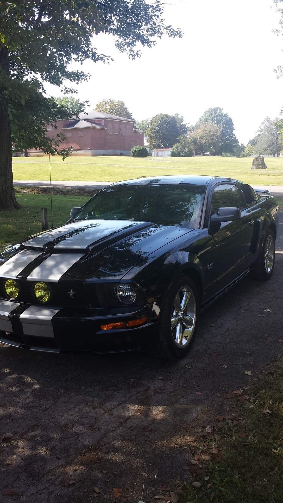

Hello all,
my searches take me to irrelevant threads so my apologies if this has been addressed. I am pondering a 3:31 to 4:10 gear swap on a 2008 GT with auto trans. According to Ford parts site the cruise control will not work afterward. Can anyone confirm if this true after tuning the transmission to adjust shift points and speedometer.
Thanks in advance for any input,
Michael Marshall
That doesn't make any sense at all. You recalibrate your speedo using a programmer, and they don't even specifically ask for a rear gear ratio. The outer diameter of the rear tire and the gear ratio determines how many revolutions per mile the tire spins, and that number gets used to adjust shift points, speedometer, and cruise.
Ford doesn't offer 4.10 gears as an option, so that's why they say it doesn't work. With an auto the shifting is based both on rpm and mph. When you change to 4.10's you can change the gear ratio in the tune and the speedometer mph will be correct but the rpm will be off. For best results you need the tune for the automatic functions modified for drive ability, based on the 4.10 gears.
Earl
I'm inclined to believe shifts are based more on load and RPM than speed. It is possible the computer senses data out of parameters (Load and RPM relative to speed) if the speedo isn't calibrated. I would be too curious, I would want to test it on the road before calibrating.
Ah, misunderstood what you said. Yes, this is what I was thinking as well, which leads me to believe that 4.10s wouldn't be an issue as long as the car was programmed with the proper revolutions per mile.
