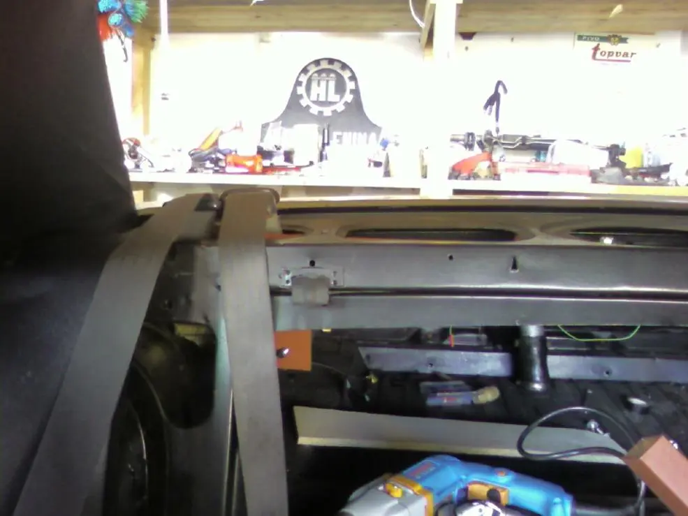

I would place the belt assembly to the trunk, under the rear windshield, similarly as in 90s lx stangs, and route the belts from there, using two factory mounting points for remainning ends. Anybody tried this approach? Are there any catches that I am possibly overlooking?
One thing you need to consider is the angle that the belt will be at. If you have the belt mounted to a point where the shoulder belt will be below the shoulder, when you are in an accident the force will not just hold you back, but can push you down causing major injuries to the spine and more.

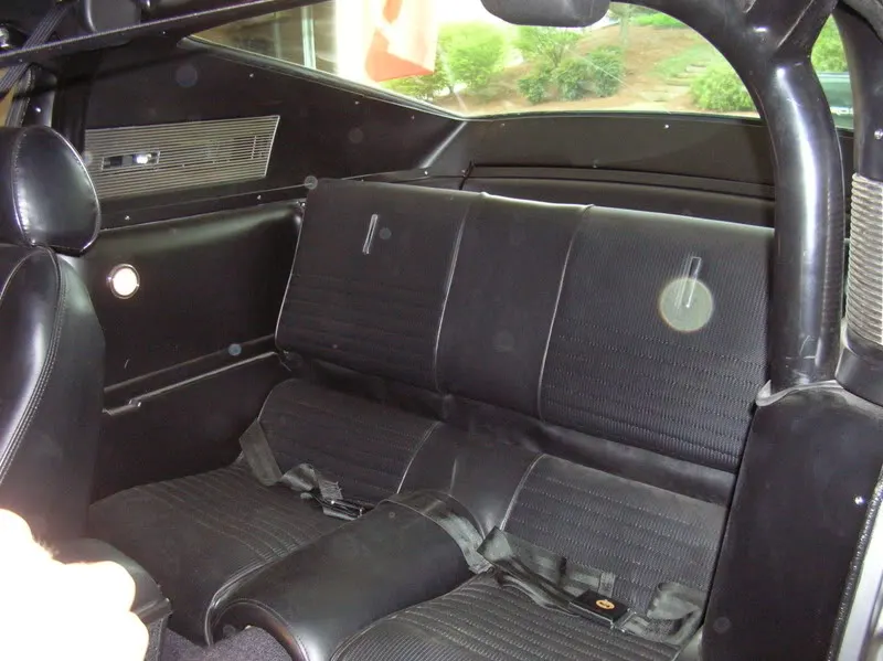

One would be to get a roll bar. Mustangs plus sells them. But those are huge and stick out like a sore thumb What i was thing was maybe if i could get piece of steel tubing and and get it welded along the top of the roof and perhaps have it come down on the sides where the rear window and front window meet (that chrome piece) right behind it so it's somewhat hidden. Paint the tube the color of the headliner and then attach the seat belts to there. possibly even a 4 point.

The important thing to remember is that they need to be attached to a place higher than your shoulder, if its lower in the event of an accident your spine will be compressed.

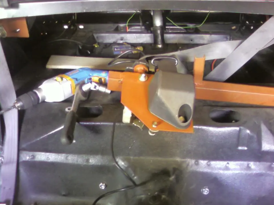

This is the first prototype (let's call it). Those belts come from mid 80s toyota. Length is OK, but it has some weird tensioner that I have to work on. There is a ball that needs to be perfectly seated otherwise the belt is locked. The structure seems to me pretty solid and ios almost invisible from the trunk.

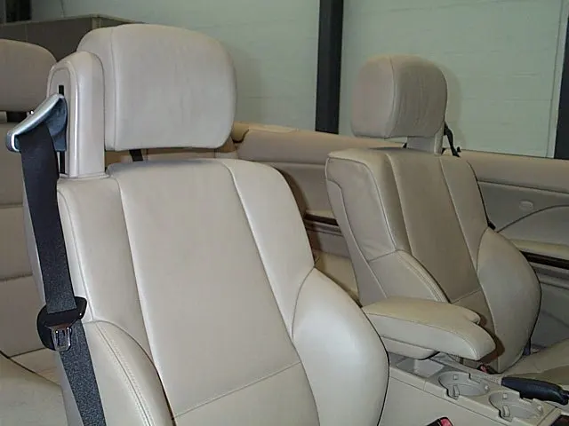

I installed seats from a 3 Series BMW Convertible (2003).
Yes, holes need to be drilled in the floor, but its a clean setup that has the shoulder harness built into the seat. The belt goes down inside the seat back.
Also check out Sebring Convertible seats.
nice looking, but I can't imagine having those in anything classic. even if, probably underseat floor would have to go and stronger floor would be needed too to hold the weight

Yes, the seat bottoms are higher. So far, I have only installed the passenger side, and I am having an upholstery friend thin out the padding from the bottom cushion. That should allow me to have a helmet on an not touch the headliner. The seats weigh 70 lbs a piece, but they are full power. They were originally grey with leather in very good condition, but I'm dying them black, so people wont notice that I have BMW seats.

1967 Shelbys came with a rollbar that bolts to the roof. I added a Shelby rollbar to my '67 and yes there were captured nuts already there. Maybe its Fastbacks only thing.
Isn't having your belts going through the package shelf going to make it unihabitable for rear passengers?
Bad photo, but you get the idea..
