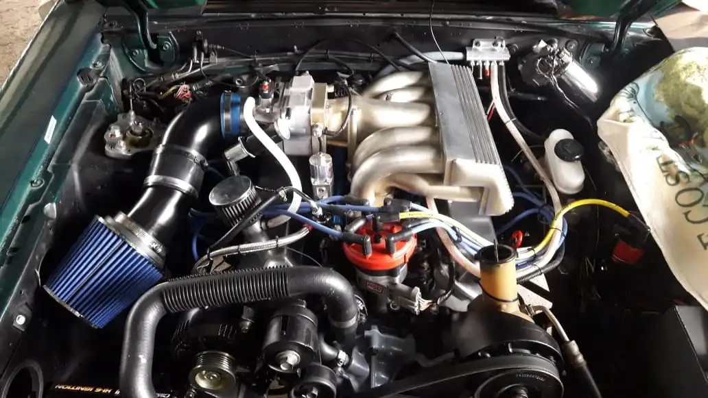

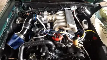

I run a a 331cu with F cam and ported 185cc Flotek heads ported Tubular, 70mmTB, 373 rear, alu DS, and AOD trans with 10" TCI street Fighter converter ... MT 255/60-15 SS tires ..and Car goes easy into the 12s at street and not even reving to the possible top ...(Dragy Times)
