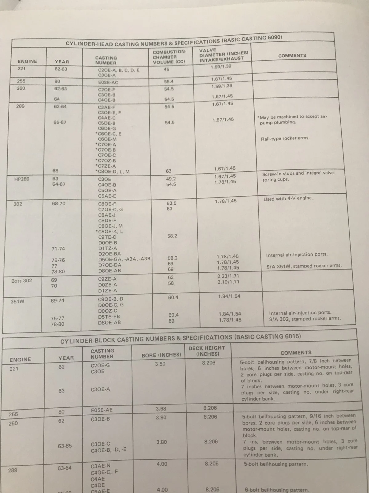

The casting number on the heads off of the 289 is C6OE, which means they have a 1.67 intake valve, a 1.45 exhaust valve and a 49.2cc combustion chamber. Not trying to seem rude or anything lol just letting ya know that those are the facts I've found on the heads. I believe that if I took a day or two to port them myself it would be worth it. I'm not looking for insane power I really just want to get to that 300 rwhp mark.
My book lists it as follows, but take it with a grain of salt. Ford has always had some castings with odd/wrong numbers as well as one offs.
C60E = 54.5cc,
The only head with 49.2cc was a 1963 hipo head casting
Mild porting and gasket matching is a good way to go on 289 heads
the problem with accepting what is written about ford combustion chamber size is that often times they are wrong. so until you actually measure the chambers, you have no real idea what you have. heck it has been found that chamber volume varies not only from head to head, but cylinder to cylinder as well.
