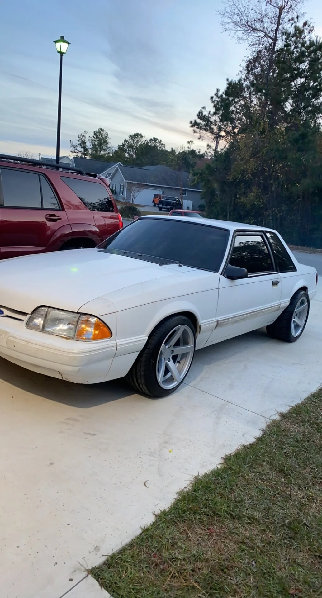

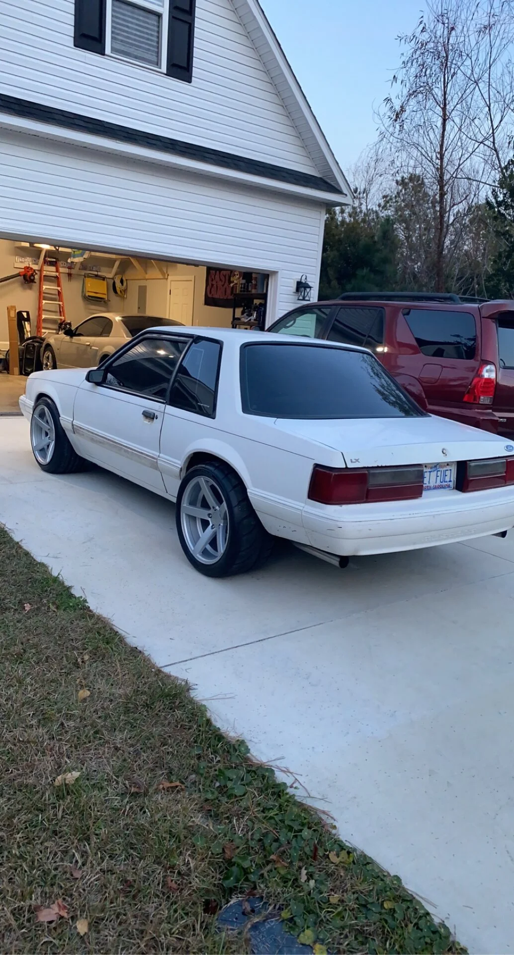

Managed to squeeze some r888r 315’s under a worn out 93 notchback. Some minor rubbing on the outside of the tire and was wondering how to stiffen up the rear. It has newer, cheaper shocks on it and some old worn out springs.

Better shocks will help, but only so much. You need a way of limiting axle movement. The rear axle is still going to articulate and cause the tire to hit the fender lips. The wheel is protruding past the fender lip, so fender flares may be the only solution as there's not much you can do when the wheel sticks out past the fender by so much.
Is there room on the inside of the wheel to spare? If so, are you running fox-lenght axles? If you are, you could look at having the inner mating surface of the wheel machined to draw that wheel in a bit as well.
Only other solution is a wheel that fits better.
That is a bunch of wheel sticking out the wheel well. That 315 is not actually fitting...its poking out.

My guess is that with those wheels, that size tire, there isn't a scenario where there is no rubbing.
There have a been a few members that have battled 315's and i don't think any of them officially eliminated rubbing.

Looks like those wheels are past the point of rolling the fenders, or even a different tire size. Those wheels are the wrong offset for the car plain and simple but I guess that's the new fad... If you are persistent on keeping these wheels, you could lift the car. The donk community does this often with large wheeld cars. New urethane isolators could give you what you are looking for.
