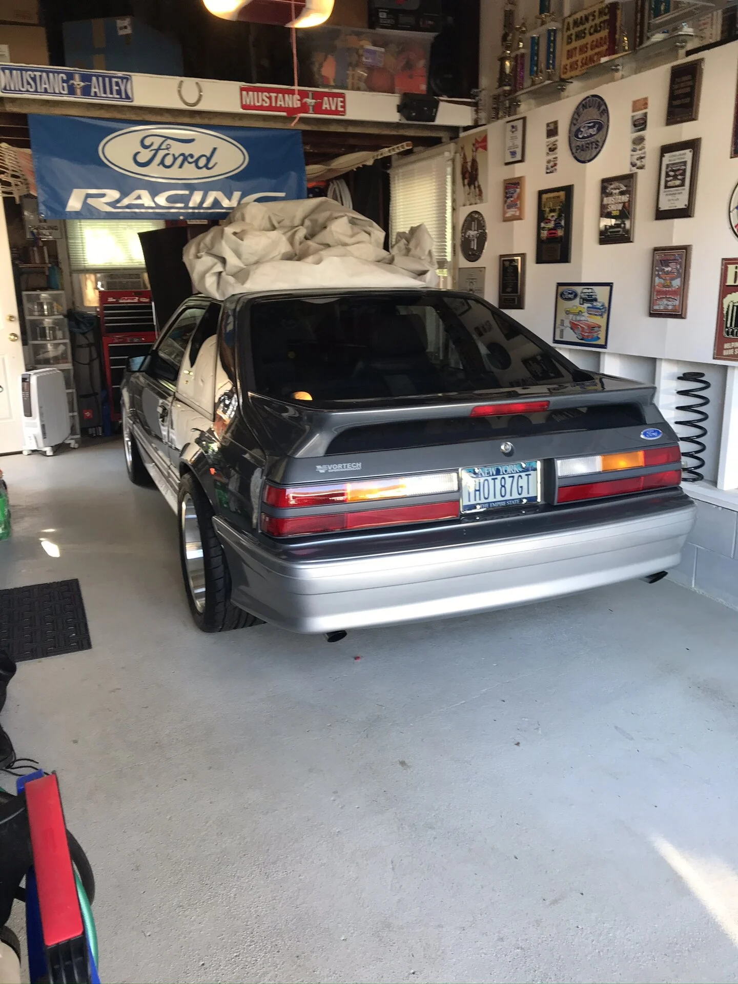

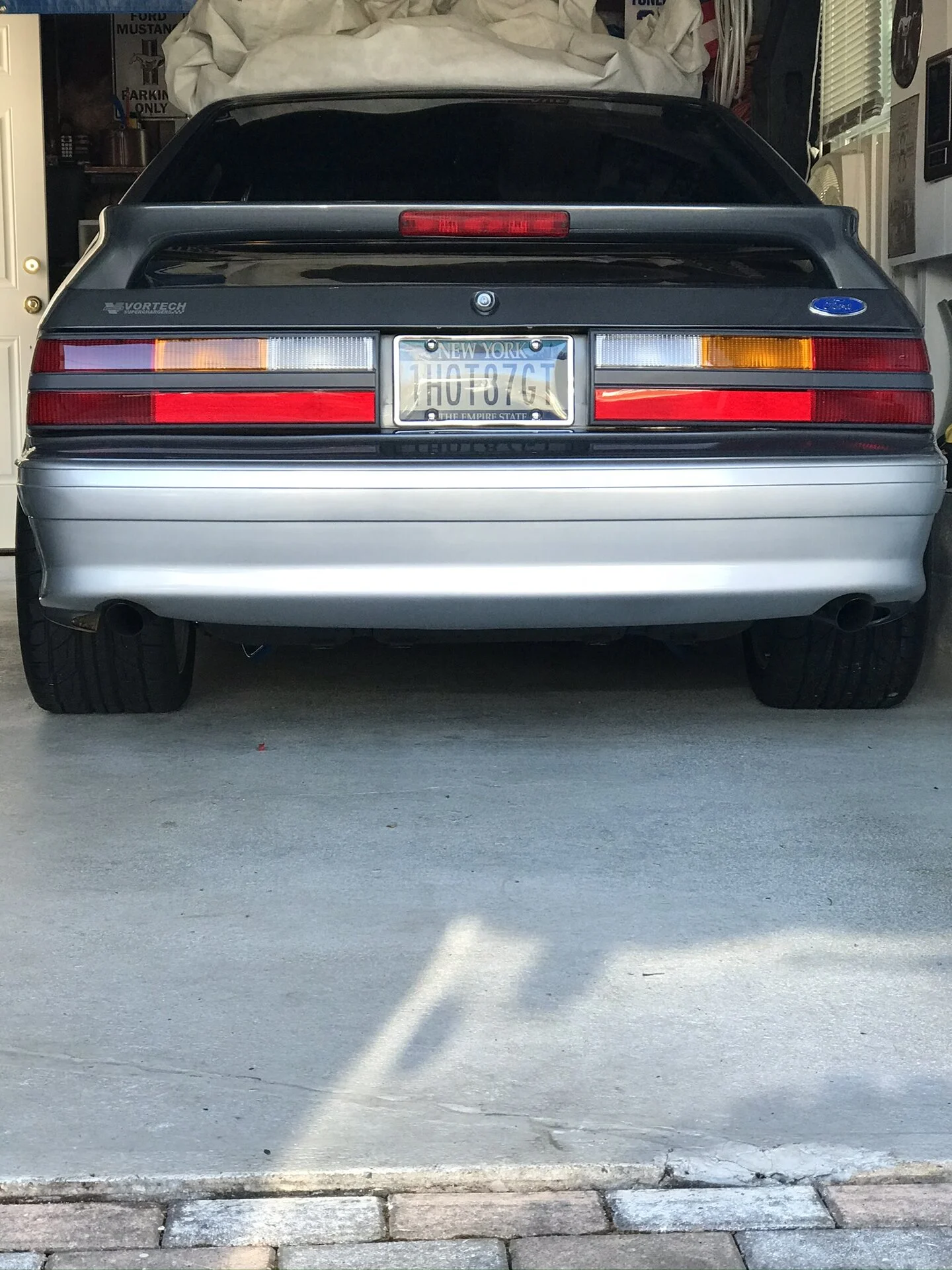

Qa1 adjustable rear coil overs. Turn them up to a high setting. Limits travel of suspension which doesn’t make for the best ride, but it should solve your problem.
These are my 315’s on 17x10 SC replica wheels. No rubbing.

I should add there is a lot of other stuff going on there. First of all Bilstein quad shocks which are very narrow. ARP long wheels studs so I could run a Baer 1/2” wheel spacer. And like I said the QA1 coil overs set on 6 I think which really limits the amount of rear travel downward. Very close to the coil overs, quad shock and exhaust pipe on the inside but all fits and didn’t have to take a hammer to the car or roll the fenders. Overall pretty happy with it.

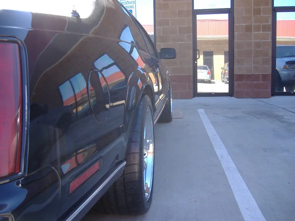

As usual I dig into a thread with good info too late. I'm trying to get my foxbody suspension lined out againafter many years in hibernation, but seeing right now I may have made an error. I see what Warhorse is saying about understeer/oversteer in relation to staggered wheels, but I too am running a staggered setup. 265 upfront and 315 in the rear. I was just on the phone with MM Tuesday inquiring about a Torque Arm and Adjustatble rear sway bar to help me achieve a more neutral balance for mixed driving. If what Warhorse is saying is correct, I may have just set myself up wrong before I even hit the street. These two were the last pieces of the MM catalog that I needed. Won't know if this all correct til the driveline and interior go in. I don't have the luxury to go to foxbody mustang axles, as the Lincoln Mark VII has longer axles to begin with. In the pic below I'm running a 1/2 inch spacer to get the tire to sit as it sits now. I have Koni adjustables in the rear, set on a soft setting. My MM panhard bar does it's job keepig things from rubbing for the most part. Old pic before the tear down 8 years ago.
