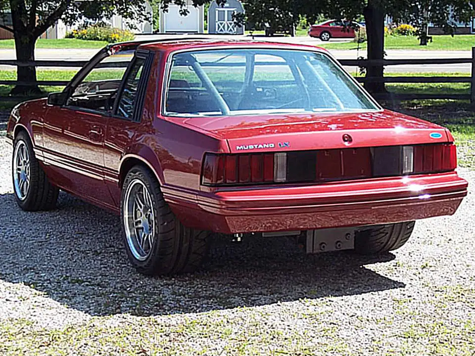

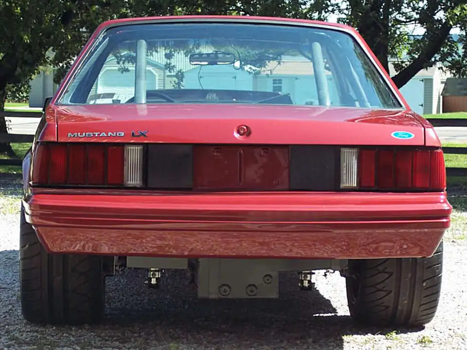

Go wide
nvr2low
Apr 17, 2007
syracuse ny
Mar 21, 2010
  • Mar 21, 2010
Trbofox said:
Go wide
that car has come a long way! are those 315's?

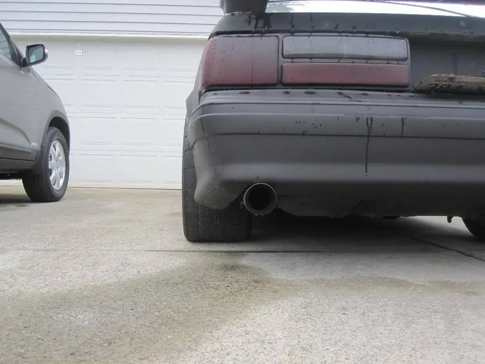

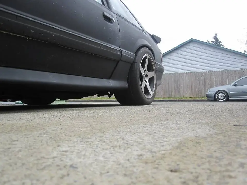

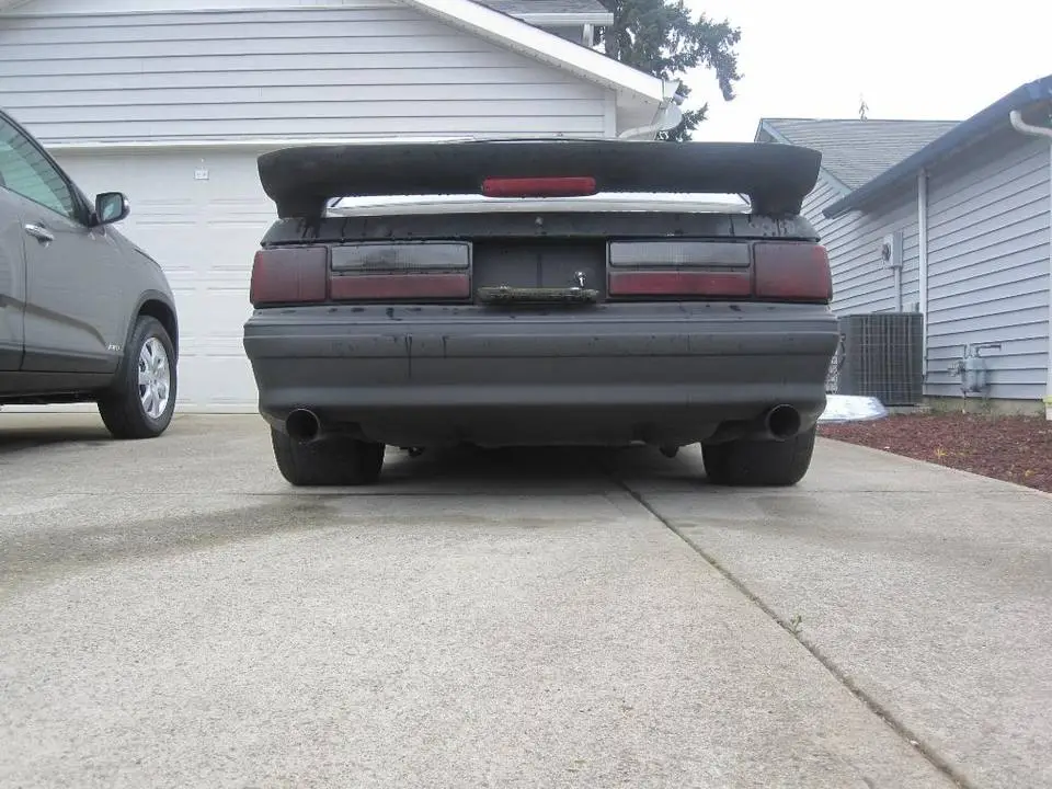

Im running nitto 315 DR with a 17x10.5 wheel with stock fox length axles, rolled fenders, and beat the inner fender with a BFH, and also running 1/4 inch spacers

Looks good! I have my battery kill switch where yours is. My car was a race only but now is street and I want to keep the switch. What do you do about your tag? Are going going to drill a hole in it?
