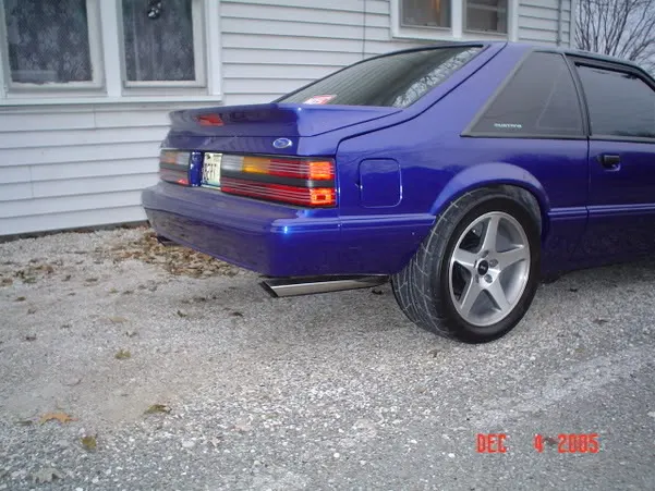

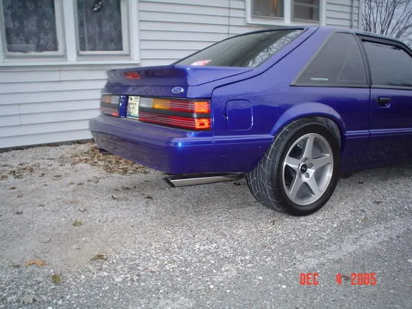

Alot of people wonder if 315's fit on a fox: YES they do. I didn't think my tailpipes would fit but, YES they do:

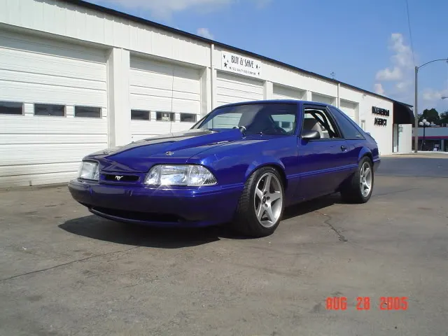

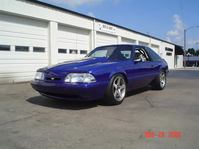

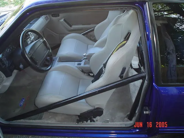

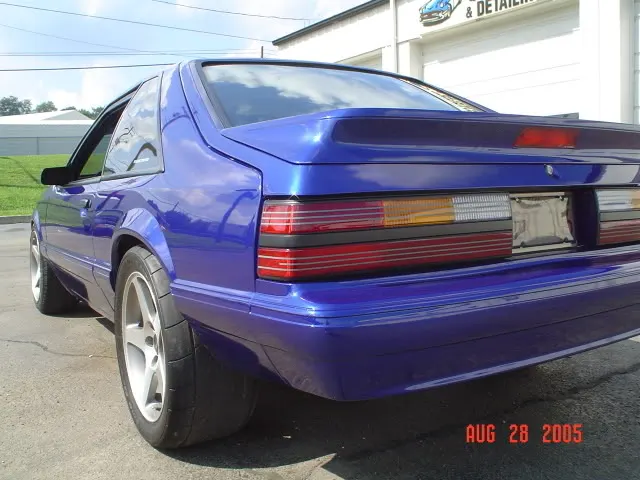

and some random pics before tailpipes:

Please give some more description of your set up. What axles did you use etc...
Stock length ranger axles, no quads or spacers. I had to do some clearancing on the inner fender w/a BFH. Did not roll the outer lip at all.
Up front i used 5/16" spacers w/lincoln rotors and a 245/45 tire.
:SNSign:
17X9's front AND back. The nitto's run small so i don't think i'd get a BFG drag radial on there.
Flowmaster Cat-back, and hacked-up factory springs (I immediately regreted that decision BTW) Lookin to get some Eibach pro's and some strange adjustable struts/shocks.
Thanks for the comments!:Word:

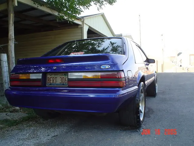

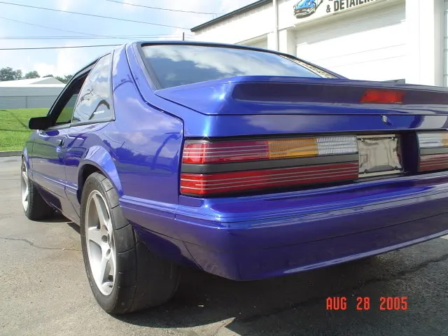

Here's the only rear pics i have other than the one i already put up:
And before tails and hackin o the springs:

hmm, I may be wrong but I dont think that roll cage will pass tech. The bars look to be way too low.
I don't think it's fast enough to require a cage anyway. It was in there when i bought it. Any higher and i would have cut them out already.
