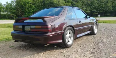

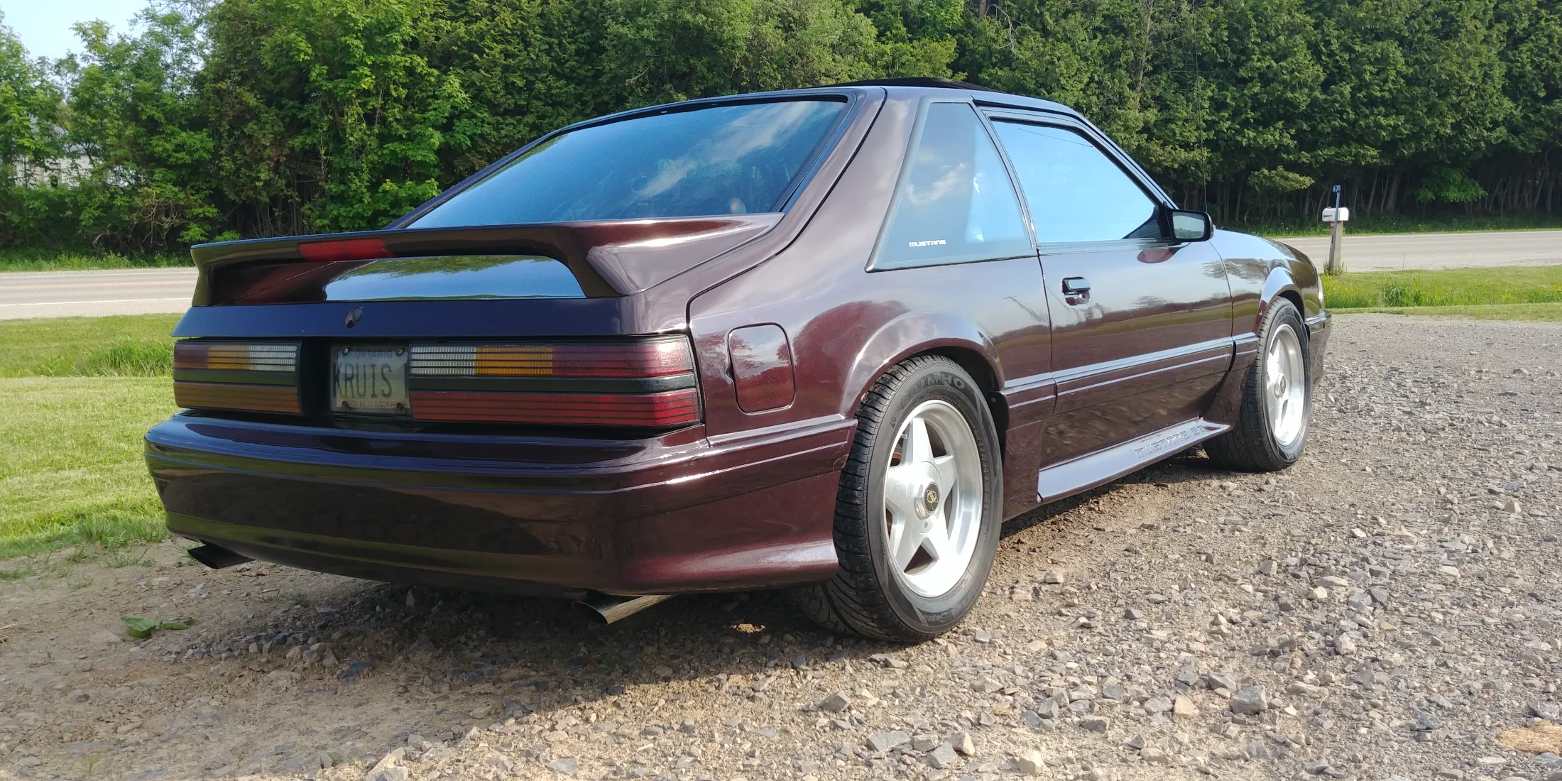

Aftermarket Cobra bumper with 2.5" Flowmaster LX tailpipes

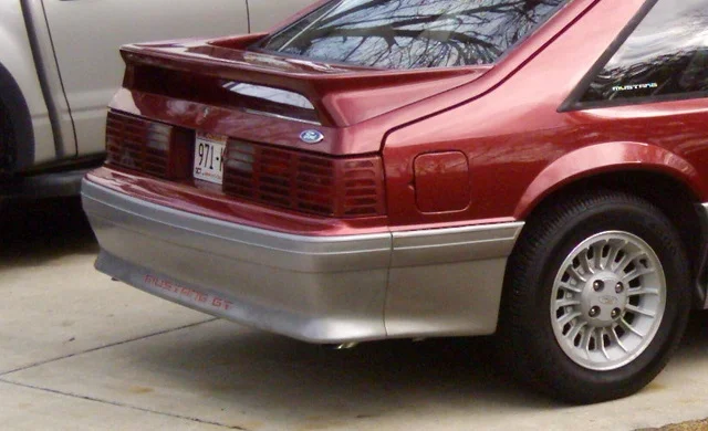

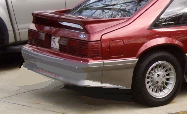

I am planning on experimenting with a damaged GT bumper cover from my son's GT we are putting together. A few years ago I played with a pic I found on the internet to visualize the concept...
My thought is to take 2.5-3" out of the middle of the bumper cover, plastic weld it back together and then modify the stock side skirts to connect/blend the lines. It will be a bunch of body work to finish it off and make it look right, but it will definitely be unique. Then I would use LX polished tip tailpipes. Kind of a Cobra bumper cover look but retain the MUSTANG GT scripting, might even fool a few people.

Aftermarket Cobra bumpers are usually held on with double sided tape on the sides (not the greatest). For my bumper I added (fibreglassed in) the factory side mount brackets to better secure it to the car. It was a bit trickier to install but it went on (not sure if it will come off someday easily though).
