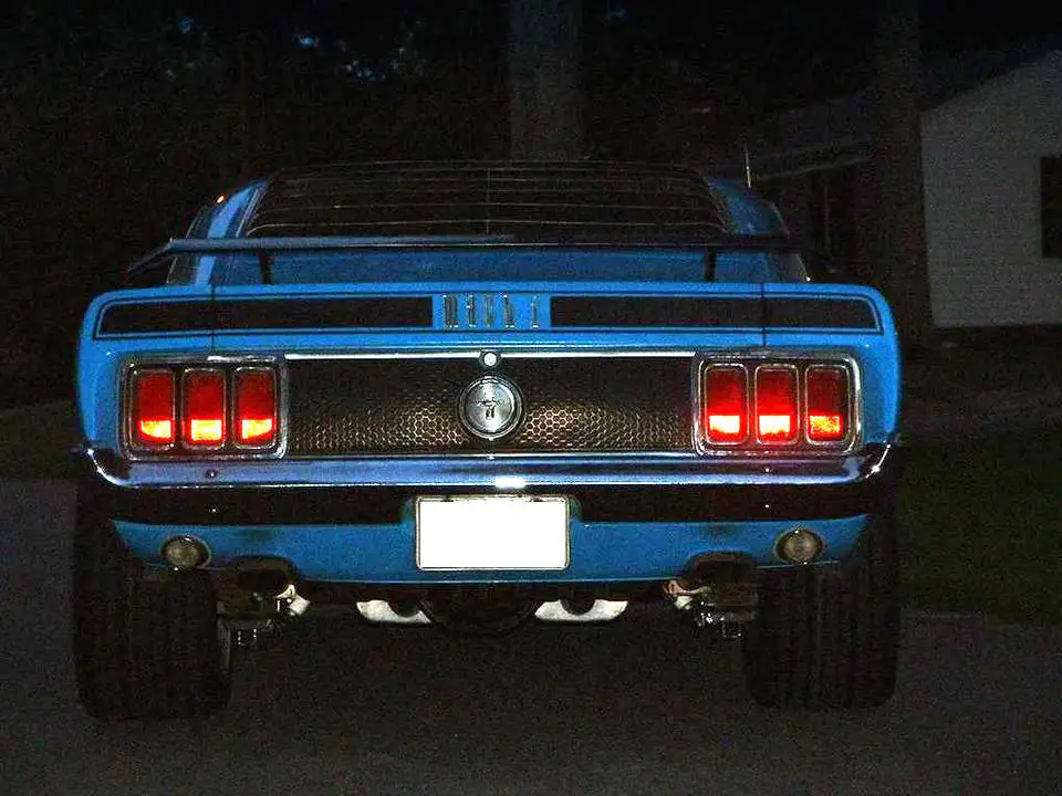

That is a pretty wide tire for a 67/68 car. I don't think you will get it to fit without flares or mini tub. I have 275's and think I could go to 285's and not have problems. To answer your question I would leave 3/8" min clearance. If you want to look at my setup with a Gbar to judge how much space you have left to play with I live in Camas and you can come over and take a look if you want.
70 w//315's

Thanks Grabber.
I found this pic online:
