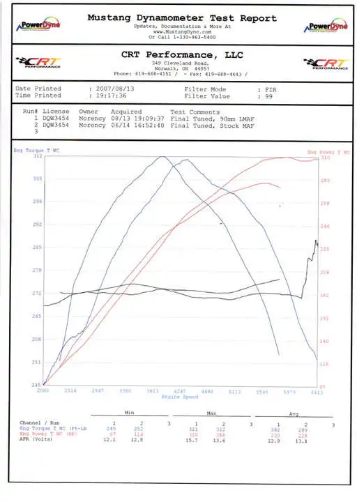

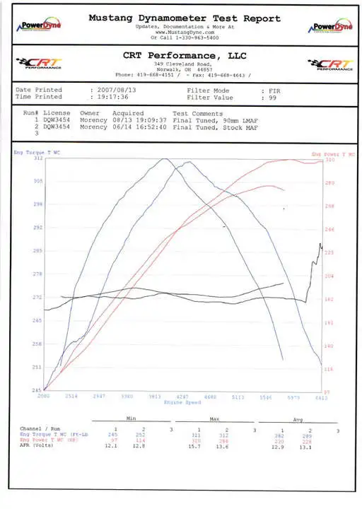

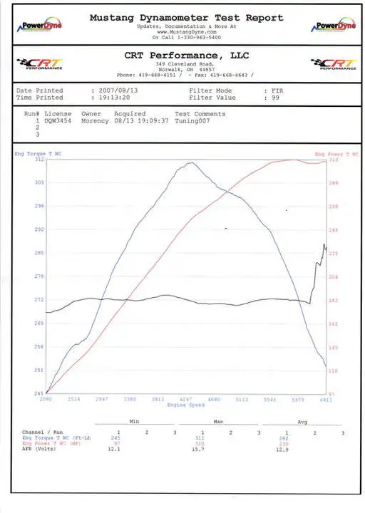

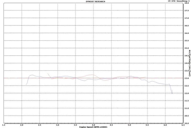

According to the air fuel ratio I go really lean @ around 6k. I'm not sure what the dyno uses but they can see my duty cycle is at it's limit. If I get a chance I will show you guys the graphs.
UPDATE: Sorry I tried to downsize them a little but you still need to read 'em :nice:

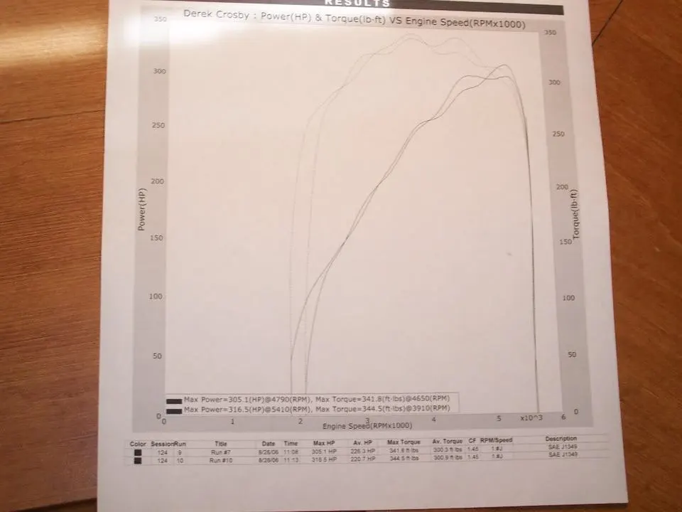

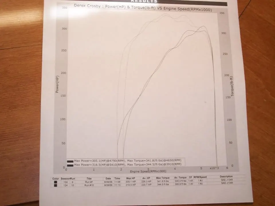

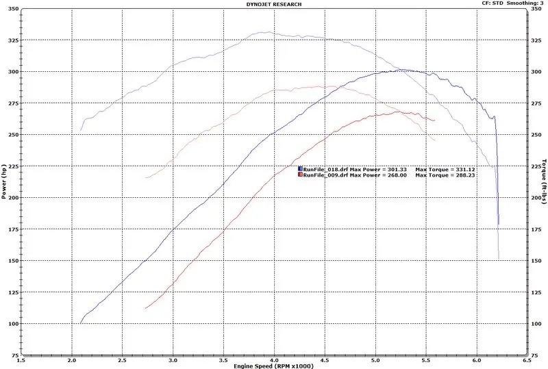

For myself...255 pump and 24's. With my setup I'm only using 41 PSI and A/F is perfect at 12.8-13 on my 94octane program with aprox 34 degrees total (12 initial) on the SCT tune. Combo is 306 with small valve eddy rpm heads with some exhaust side work, combined with the XE270HR-12 cam (though using a smaller rocker than recomended) and typhoon...oh and should add every available bolton I could find :). Larger version if hard to see is in my sig...

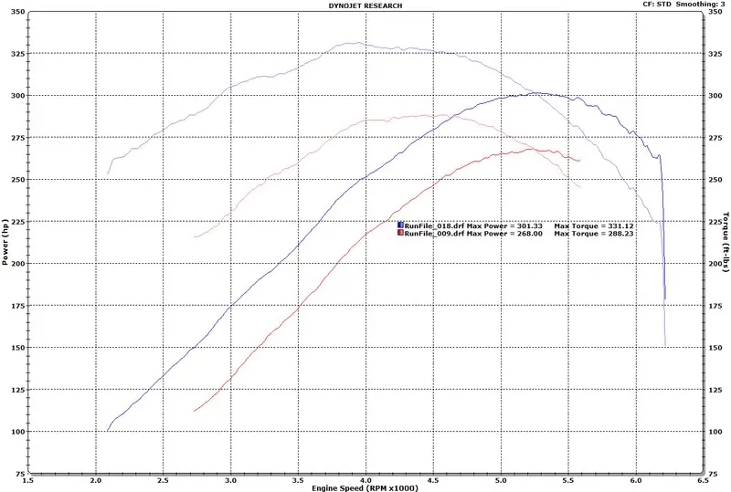

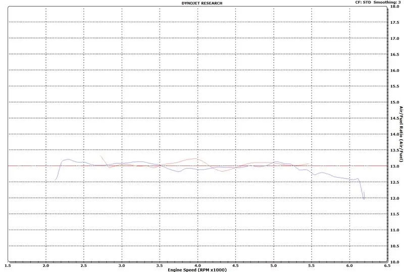

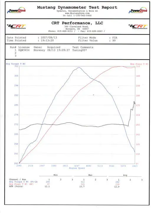

Im doing it RIGHT now..Stock fuel pressure regulator at that..With a 255lph high pressure pump(plan on a power adder later).
Mine is tuned ,screw trying to "fool" a stock computer like most do with "matched" mafs.Got a real maf with a tune beats a matched setup anyday..
Also BOOSTED fuel is WAY different than n/a fuel..THere is no compairson between the two requirements.
DMAN302-we have close to the same combo:nice:
