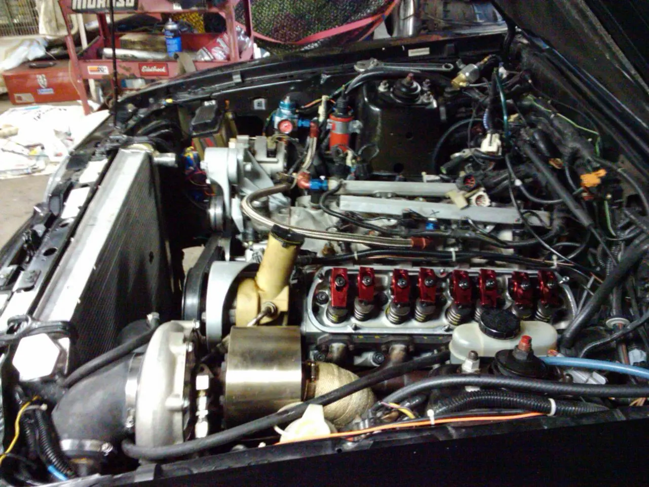

I totally agree with you im just saying that I have looked at and tried pretty much all that and the w/p is just about the only thing I havnt replaced yet. Here is a pic of the radiator if you can see it its a good sized one and is clean as hell inside. The cap is a Moroso 14-16lbs i think and my antifreeze to water is right about 50/50 Maybe a little more water. Also do new motors run a bit hotter than a motor with more miles on it? Im guessing my motor has about 1500 on it right now. Belive me I dont want to go and buy another Dart block just yet.

I think if you ran through FD's list you'd stand a good chance of figuring out what the problem is. That being said, yes, new engines with tight rings do run hotter until they wear in a bit. Though with 1500 miles on it, I would expect it to be starting to loosen up by now. Also, I was going to put a stock replacement pump on my 347, but ended up buying an Edelbrock instead, lemme tell ya, you can feel where the extra money gets spent, it is a very nice piece.
