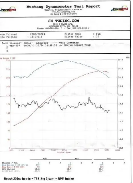

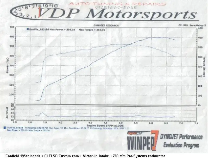

2500-6000 rpm range in a 302 is ~ a 2175-5220 rpm range in a 347. The areas you might want to consider are heads and cam. The following is a 331 the owner was having problems trying to make it perform.
Same 331 with the changes noted at the bottom.......
Difference was night and day on the street for the owner, and it ended up costing him a T5 transmission.
