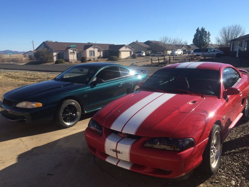

wondering if 350hp to the rear wheels is actually possible with just bolt on mods? i want to get my sn95 on the dyno here soon but live an hour an a half from phoenix. this is what i have installed so far on my manual 95 gt 156k miles.
-bbk CAI
-bbk LT headers
-bbk 70mm TB
-bbk off road xpipe
-bama 4bank eliminator chip
- flowmaster cats
i plan on installing a cam and gt40x heads here soon as well. any ideas of what im pushing for rwhp as of now with my current mods?
