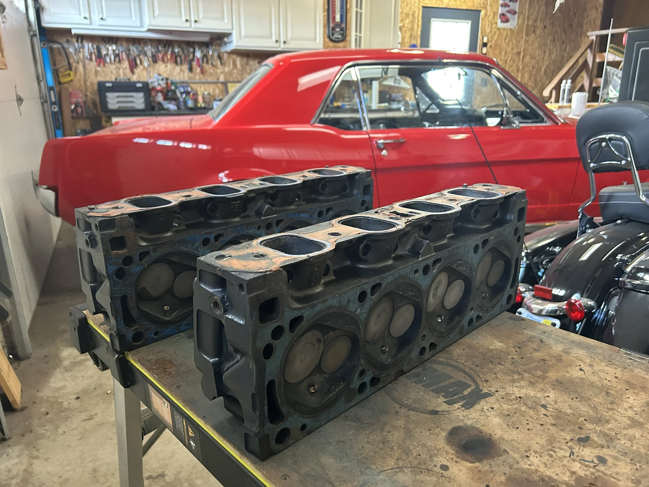

Well, the holidays are behind us and I can now get my focus back on this project. Over the weekend I scored a set of 4V closed chamber heads. The original build was going to be with 2V heads. But I found these at a great deal and couldn’t pass it up.

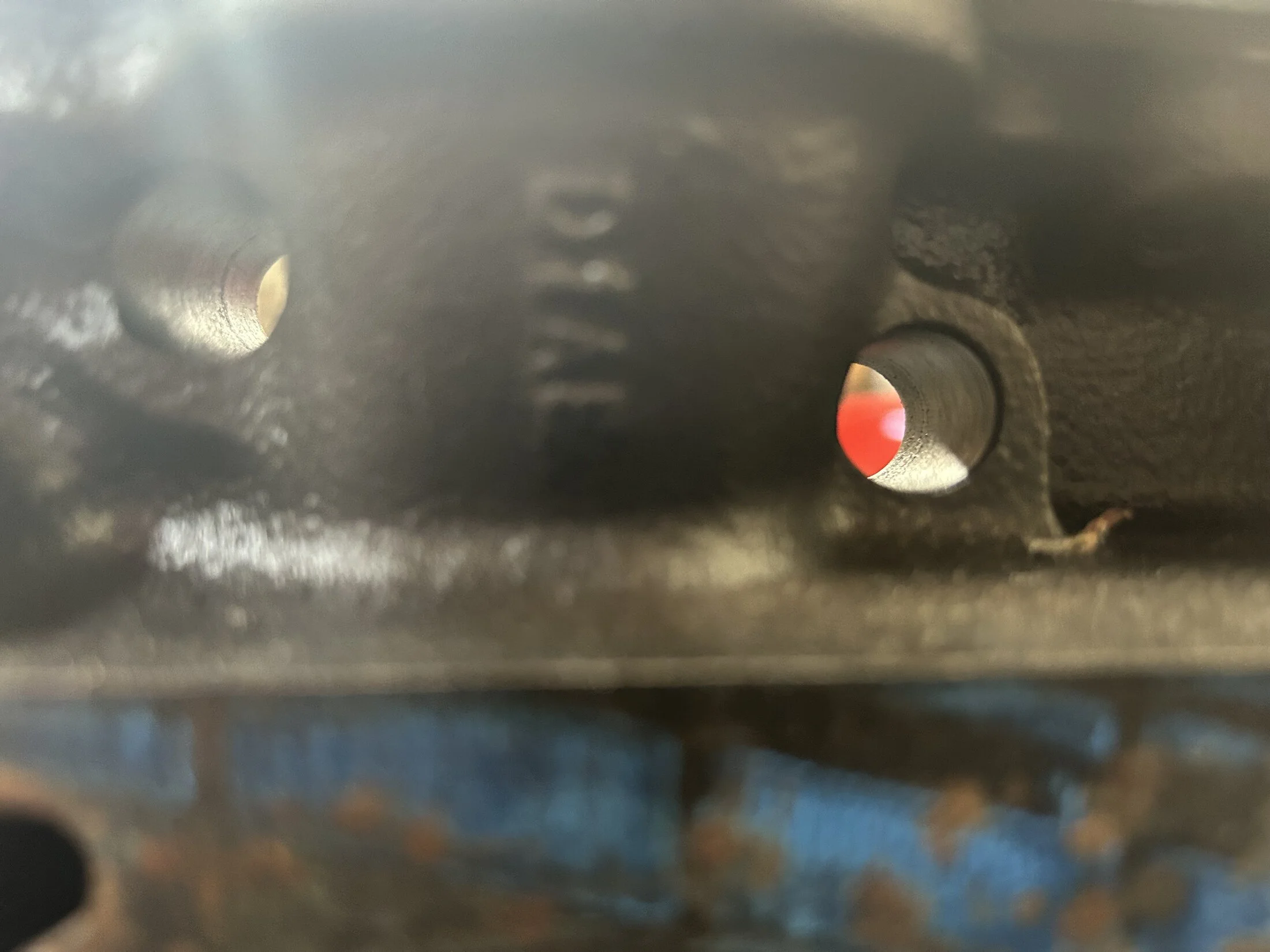

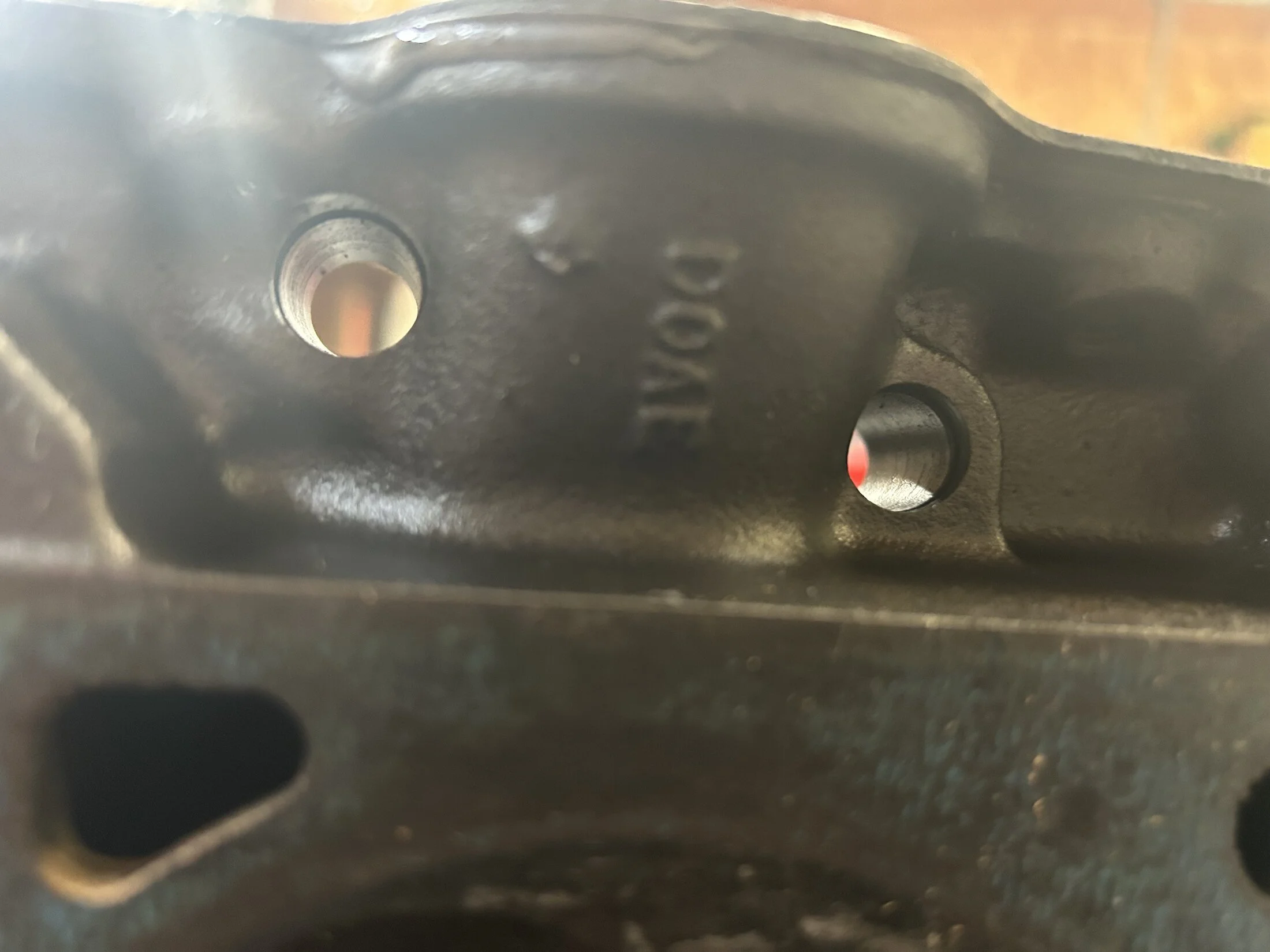

I’m assuming they aren’t a matched pair since one is D0AE and the other is D1AE.
Unless Ford did put two different date code heads on the same engine. I honestly don’t know.

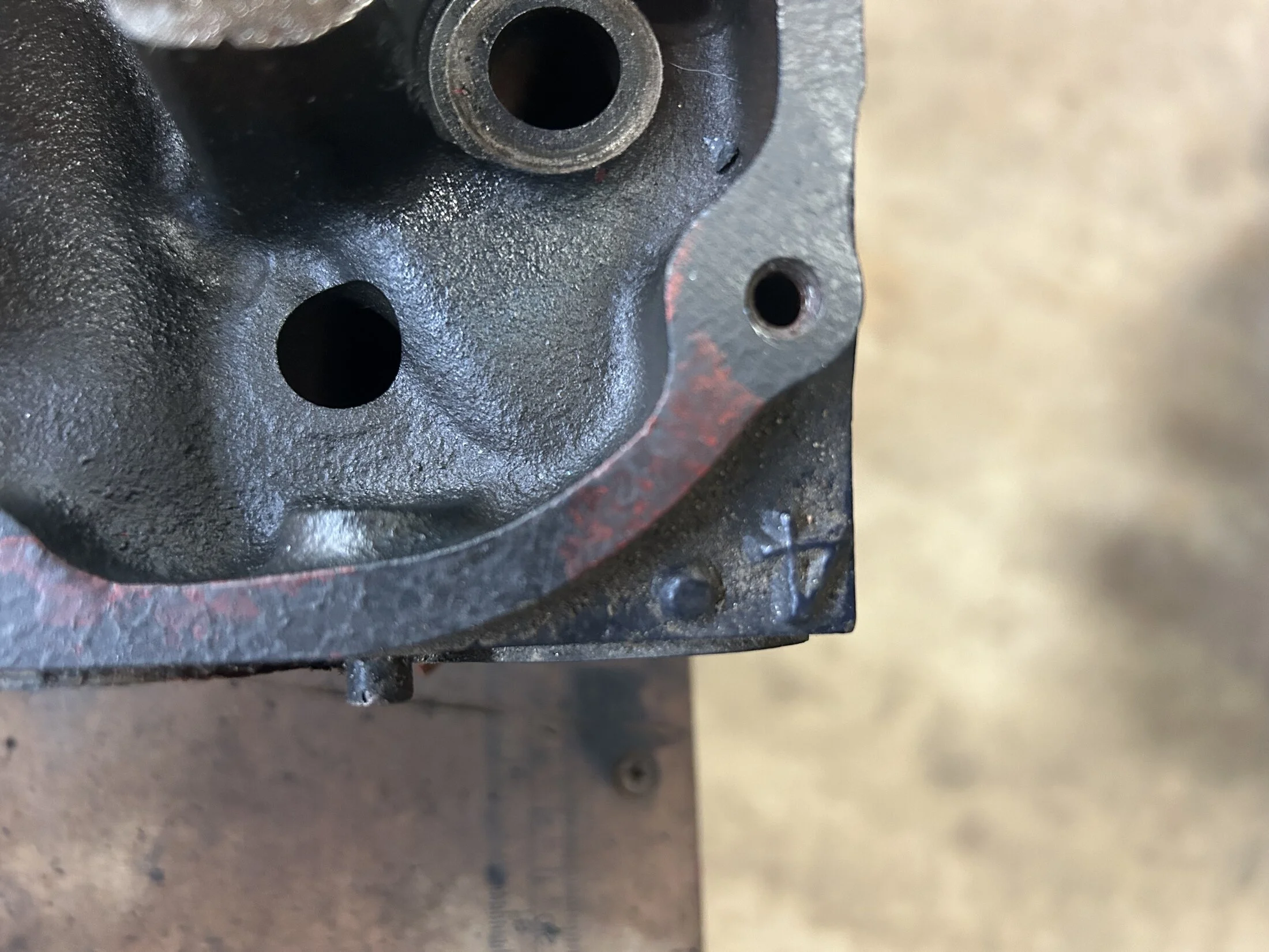

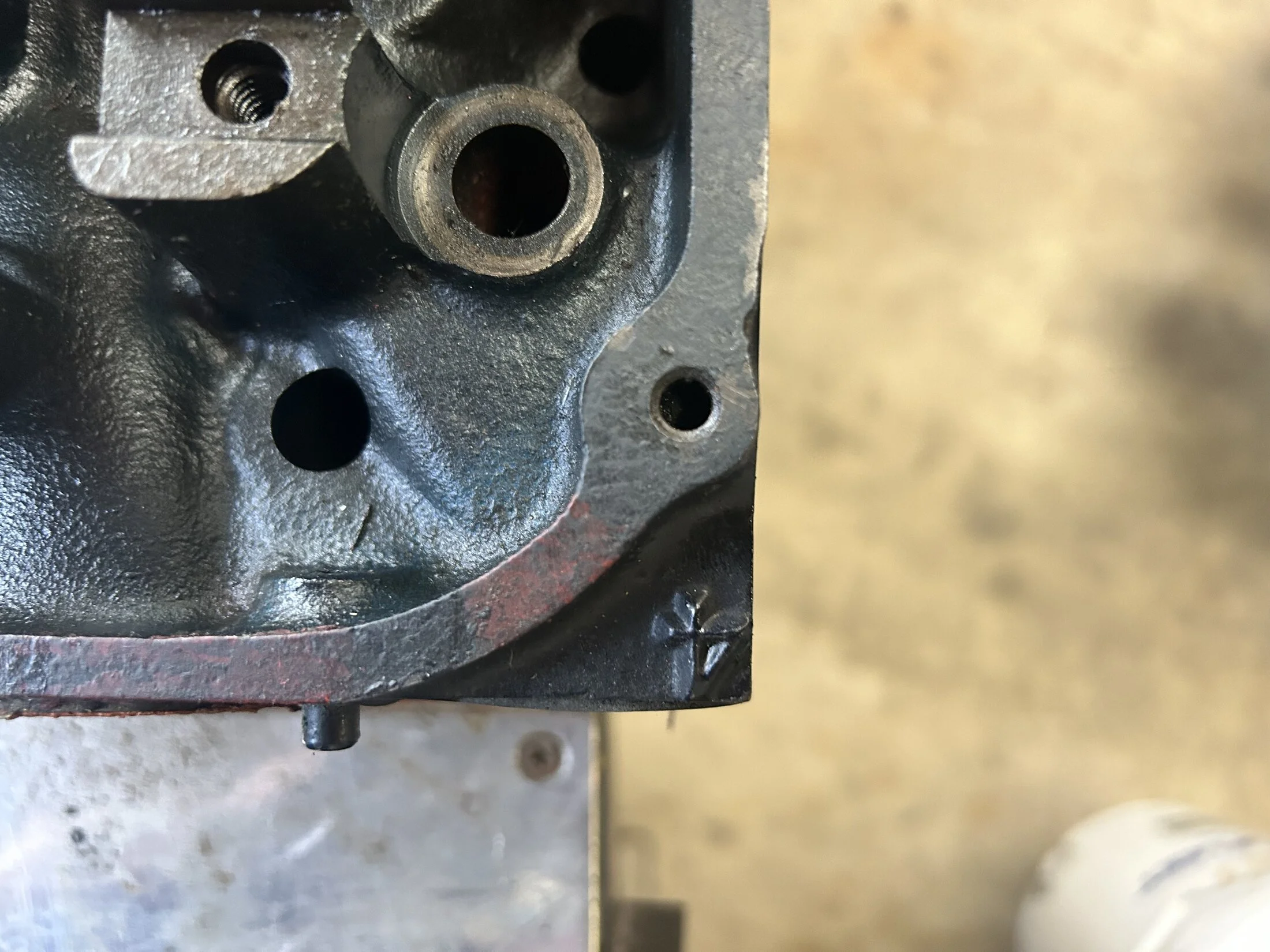

What I did find interesting is the designation in the top corner of the heads. I’ve always been told a 4 and bubble means open chamber and a 4 with no bubble means closed chamber. Here I clearly have two closed chamber heads. One with a bubble and one without. So I guess that’s not a 100% true method of identifying closed chamber heads.
If there are any Cleveland experts reading this post. Please chime in. I also have a couple other questions to prep these heads for installation. So I welcome advice to help me along the way. These came off a running engine. There for I am assuming no real machining is necessary. Other than I want to install Harland Sharp roller rockers. So my plan is to get the pedestals milled, drilled, and tapped for 7/16” studs and guide plates.
Its possible they just used what was in front of them at the assembly plant.
