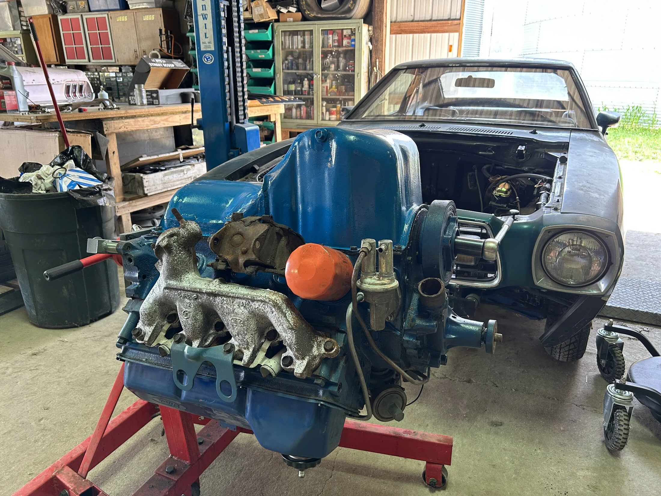

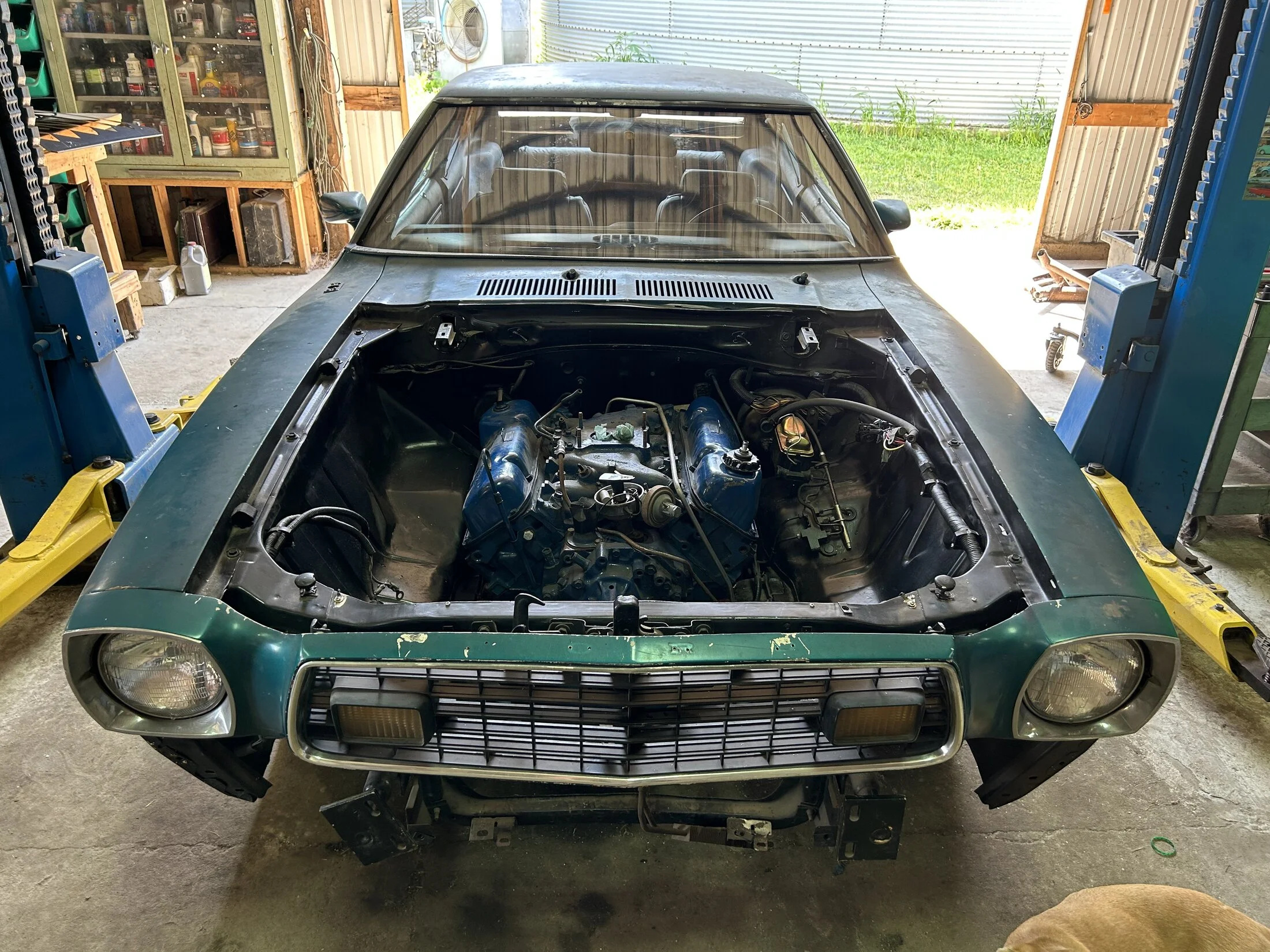

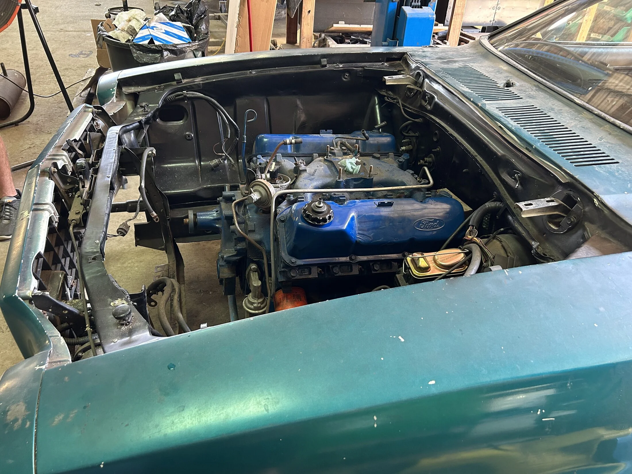

351 Cleveland swapped MII

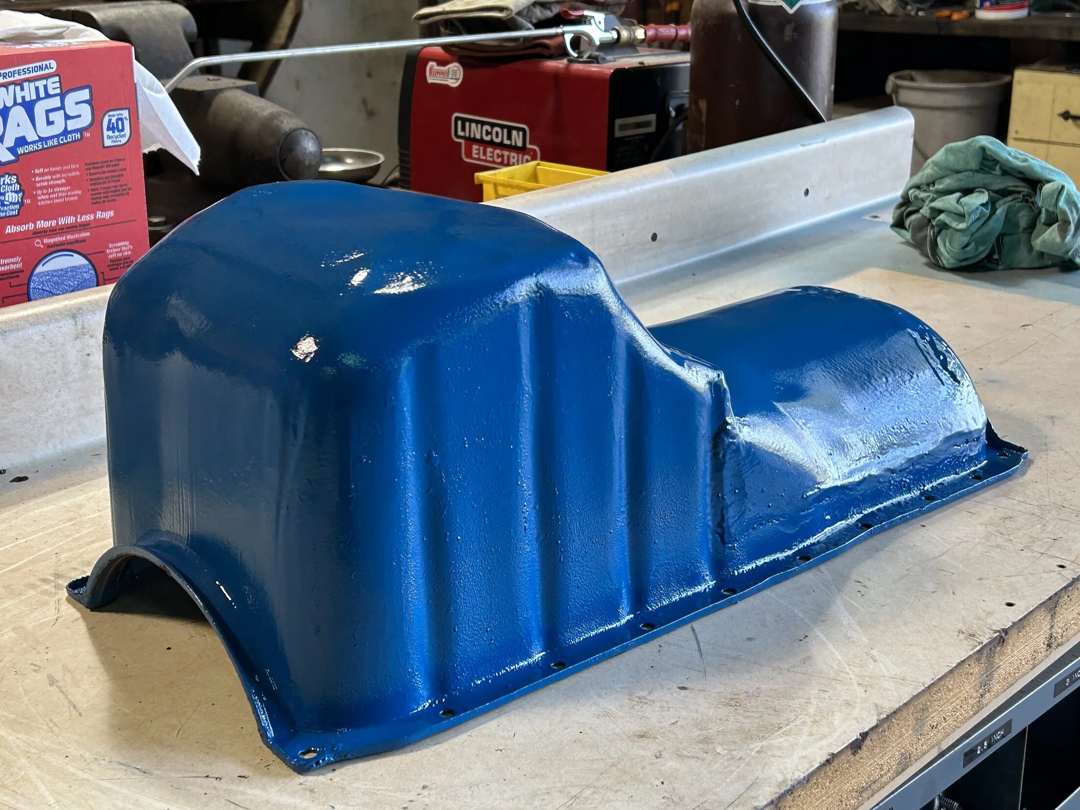

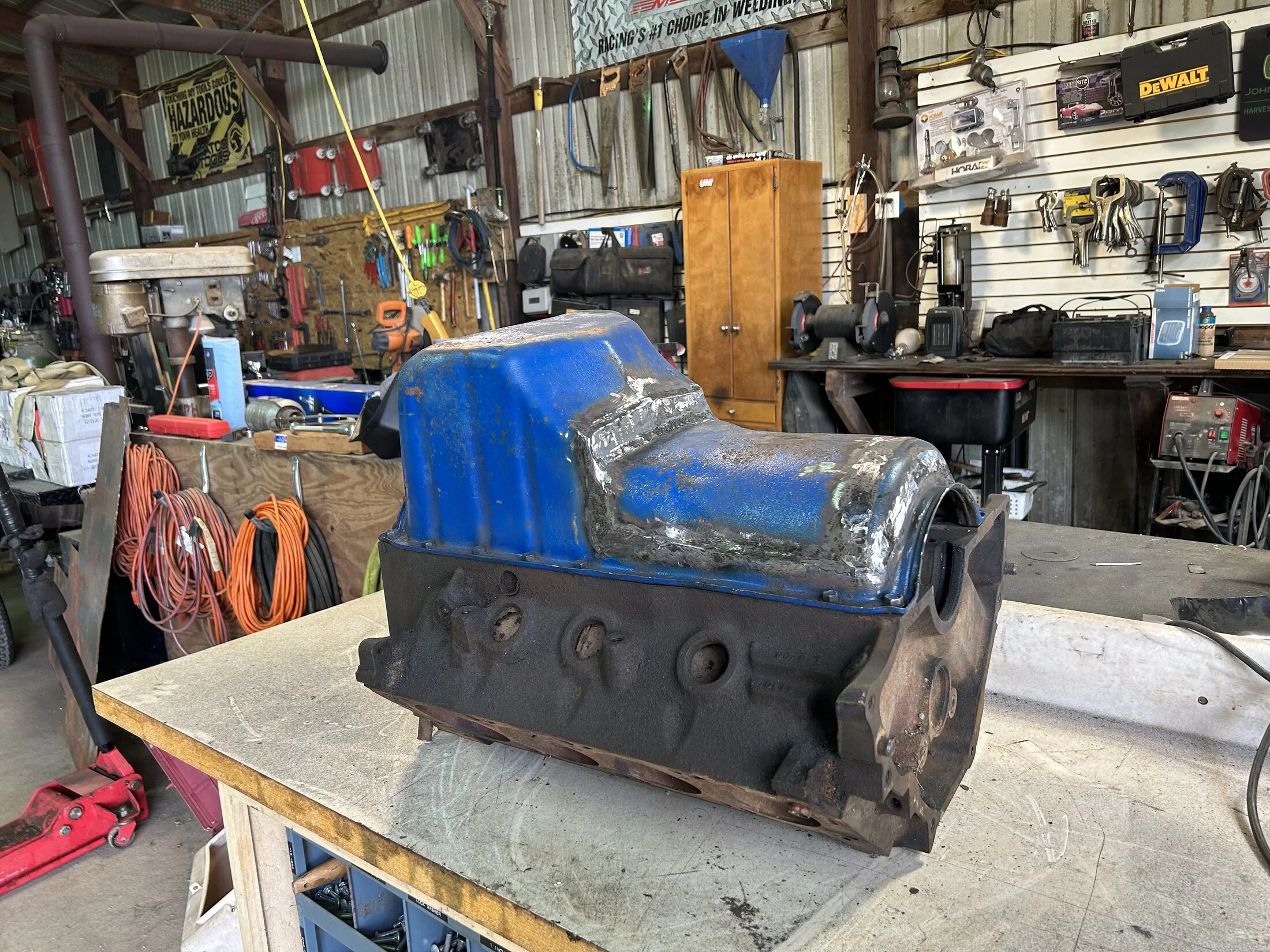

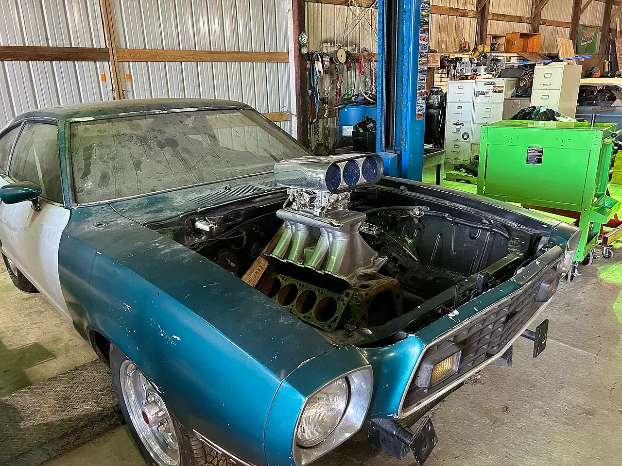

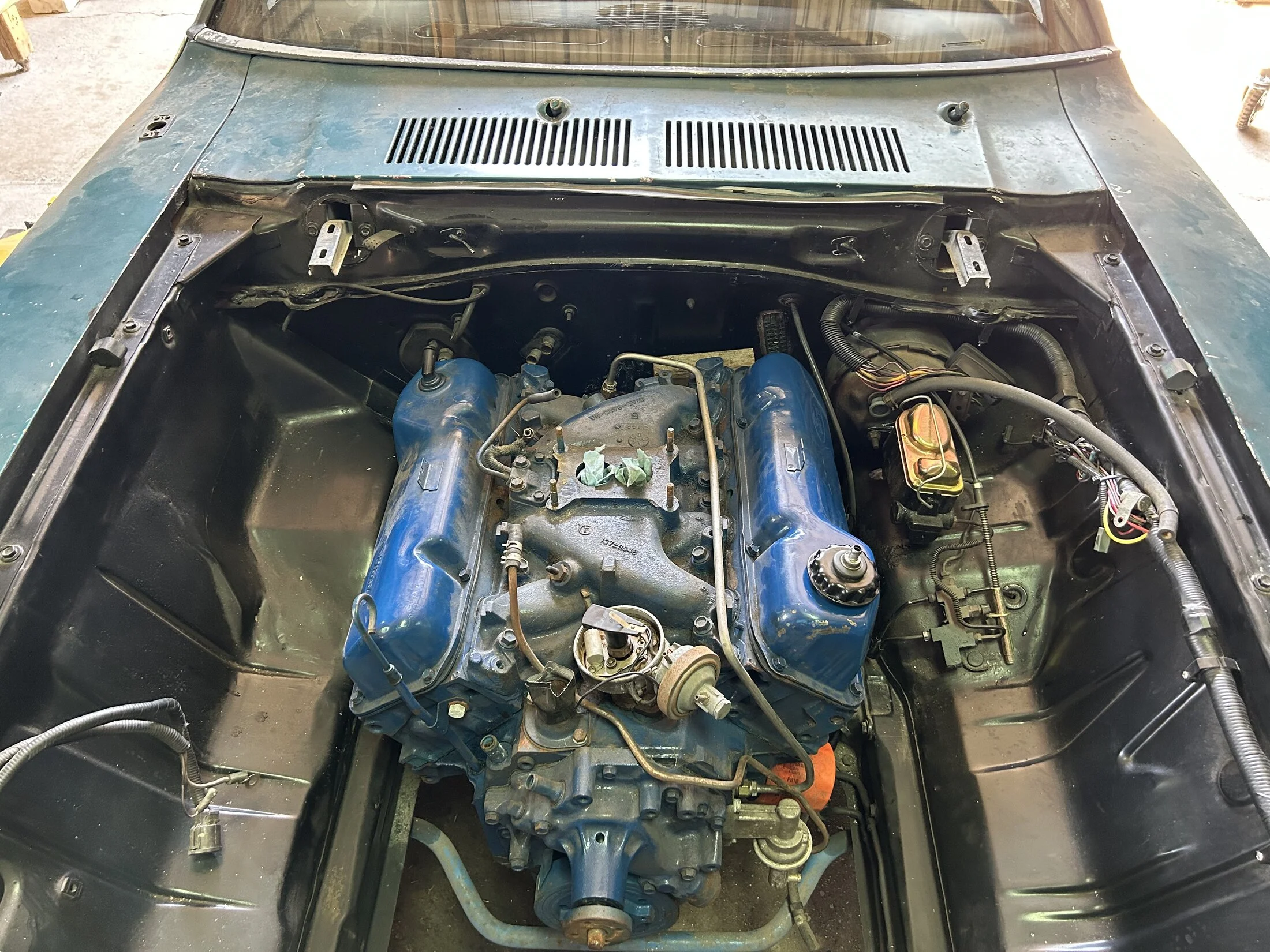

I have the pan completely welded up. I’ll be water testing it for leaks today and most likely painting it if all goes well. But I have to look at the wife’s truck as well. So hopefully I get it all done today. I don’t like my fresh motor sitting open any longer than it has too.
Have you leak-checked the pan? Discovering a pin hole after installation would suck balls. :fuss:
He did.
It’s a bit of a Frankenstein since I had to Mig instead of Tig. But it passed the water test and will allow the motor to sit in the car completely for the first time. Hopefully I can get it bolted on and motor dropped in today.
Yes sir. Not positive how good it was. I filled the pan with water and let it sit for 4 hours. Found a couple pin holes. Welded up those spots and retested. All was good after second repair.
I definitely agree, in the car is not when I want to find a leaky weld. Lol. I do appreciate the reminder though. That’s what this forum is for me. To have anyone help me from doing something stupid.
Now with that step complete. I’m looking at the next step of installing the transmission and starter. I have the factory original V8 C4 that came with the car as well as the torque converter. I did not get the flex plate with it when I bought it. Through my research, I believe the factory 302 was 28 oz balanced until around 1981. I also believe all 351 Cleveland’s were 28 oz balance. I have also read the 302 flex plate will bolt to the Cleveland crank. If all of this is true, I should be able to order a factory stock 1978 Mustang II flex plate and it will bolt right in for me. Also if this is true, I should be able to run the factory starter. I’m confirming my research and understanding with all of you to make sure I’m not missing something here. I’m so used to reinventing the wheel at every step on this car. It scares me when something goes easy. Am I missing or forgetting something? If not, I’ll get the flex plate on order.

After your reply, I remembered I had the Cleveland flex plate and a crank out of a 289 in my spare parts. I just went out and confirmed the Cleveland flex plate bolts right up to the 289/302 crank.
Rockauto claims to have flex plates for the 78 Mustang II. I assume in factory form. Nothing special. But then again, flex plates never are.
I’m going to order one from them and see how it turns out. Hopefully better than a flywheel I purchased for the 69 Mach 1. That stupid thing was out of balance and caused me all kinds of heart ache.
