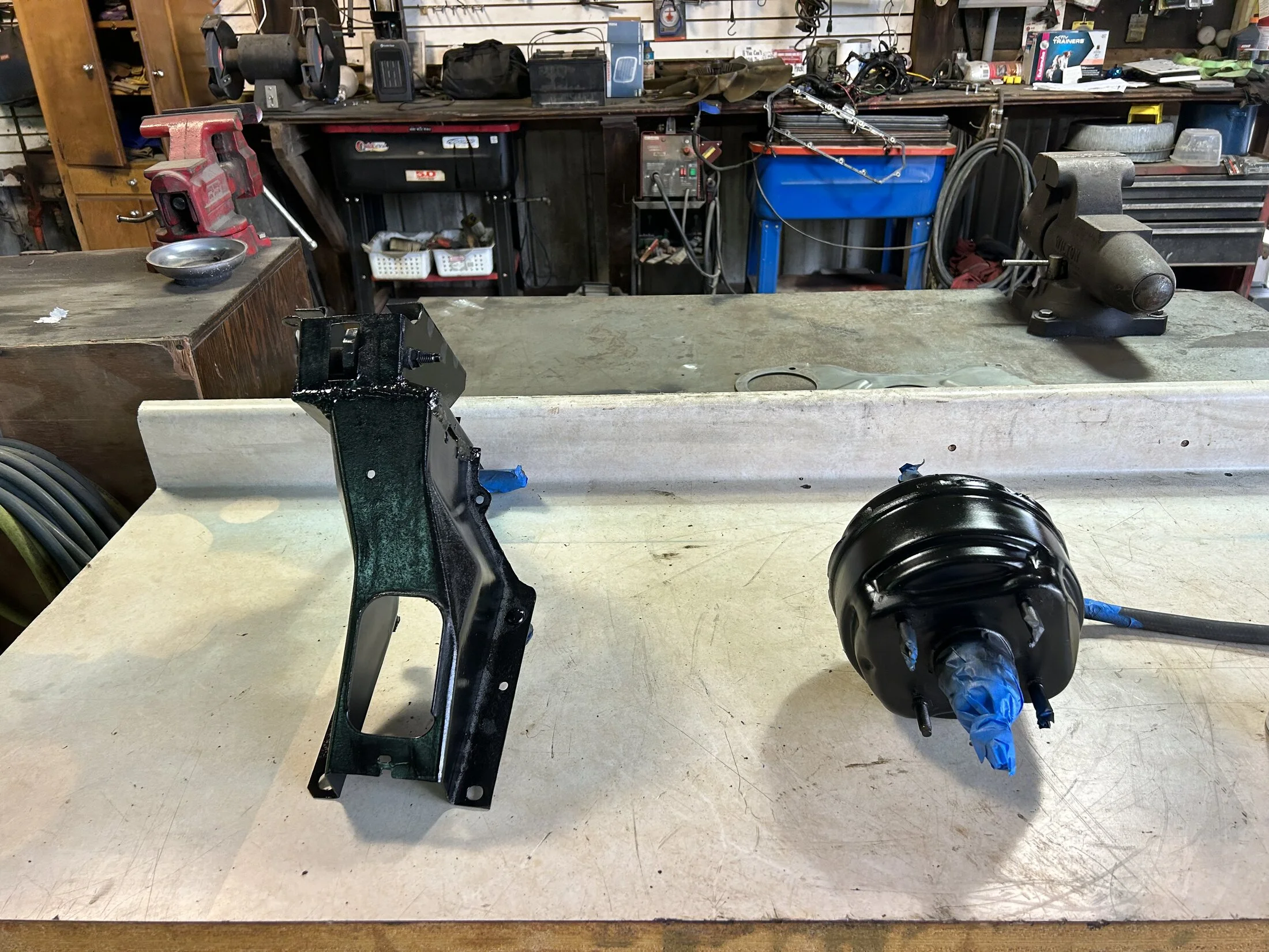

Here’s the brake pedal bracket and booster all painted ready to go back in.

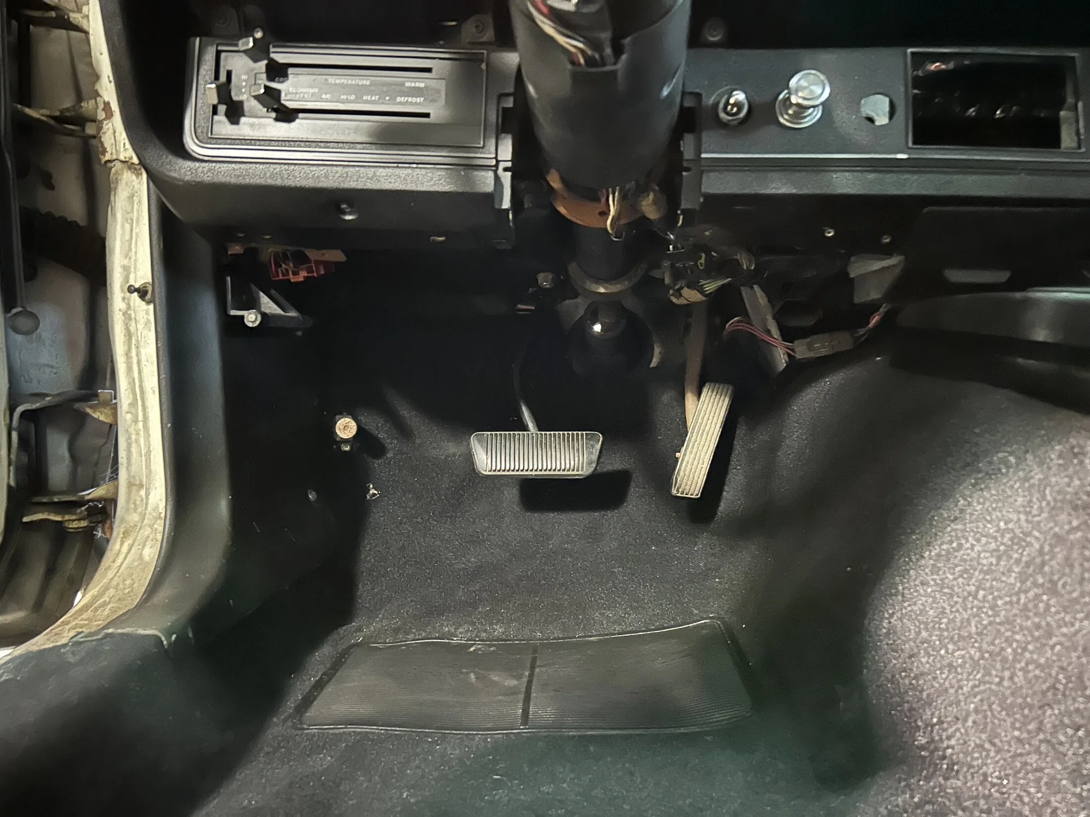

Here’s everything reinstalled and brakes bleed and working perfectly. Unless you really look closely, you can’t even tell it’s been moved I assume anyone with a Cleveland in their MII would know something has been done to make more room but your average person looking at this car would never know the brake booster has been relocated

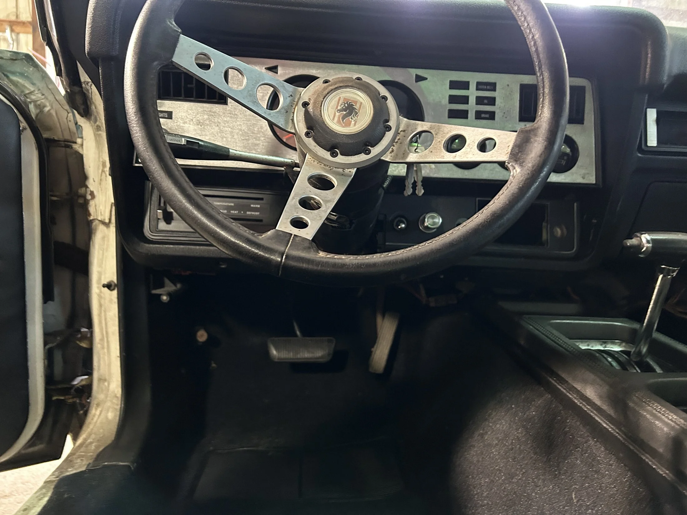

Just for reference, I measured the space between my gas and brake pedal on my 65 Mustang and it is 2.5”. The current space between gas and brake of my MII now is 3”. So it’s pretty close to factory of the average car anyway. It does feel much more comfortable moved than it did before.
