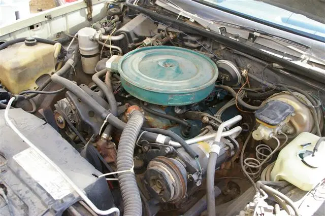

Yeah, I was thinking a four-eyed fox, so carbureted. My friend's got an '84 (?) with a 5 speed, and he's considering selling it to me for $100. By the way, Nice motor(that fuel rail is huge!)... Looks alot nicer than mine...for now hehehe
