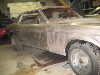

I just bought a 67 mustang project car. I was offered a 351C with a top loader 4 speed. The car now has a 289 / c4 trans.Will it fit and is there a site where to find all the information on the swap.Thanks for all your help
