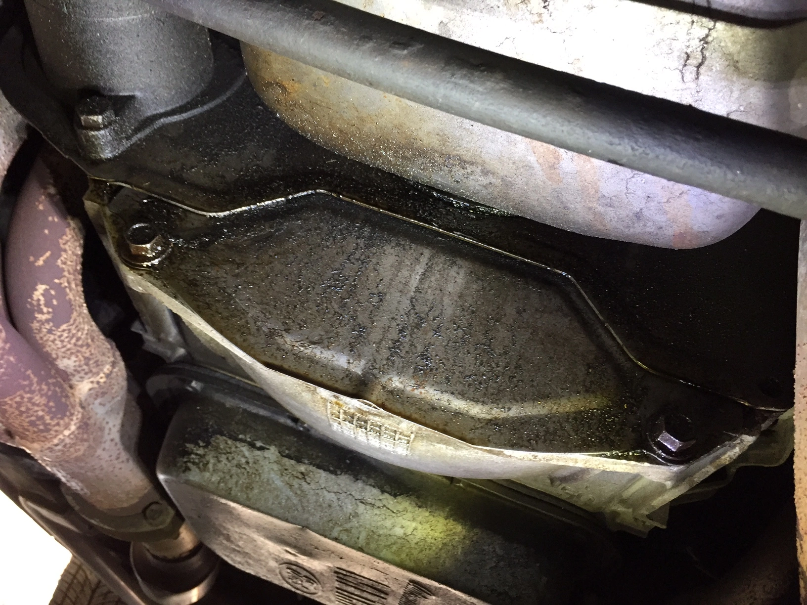

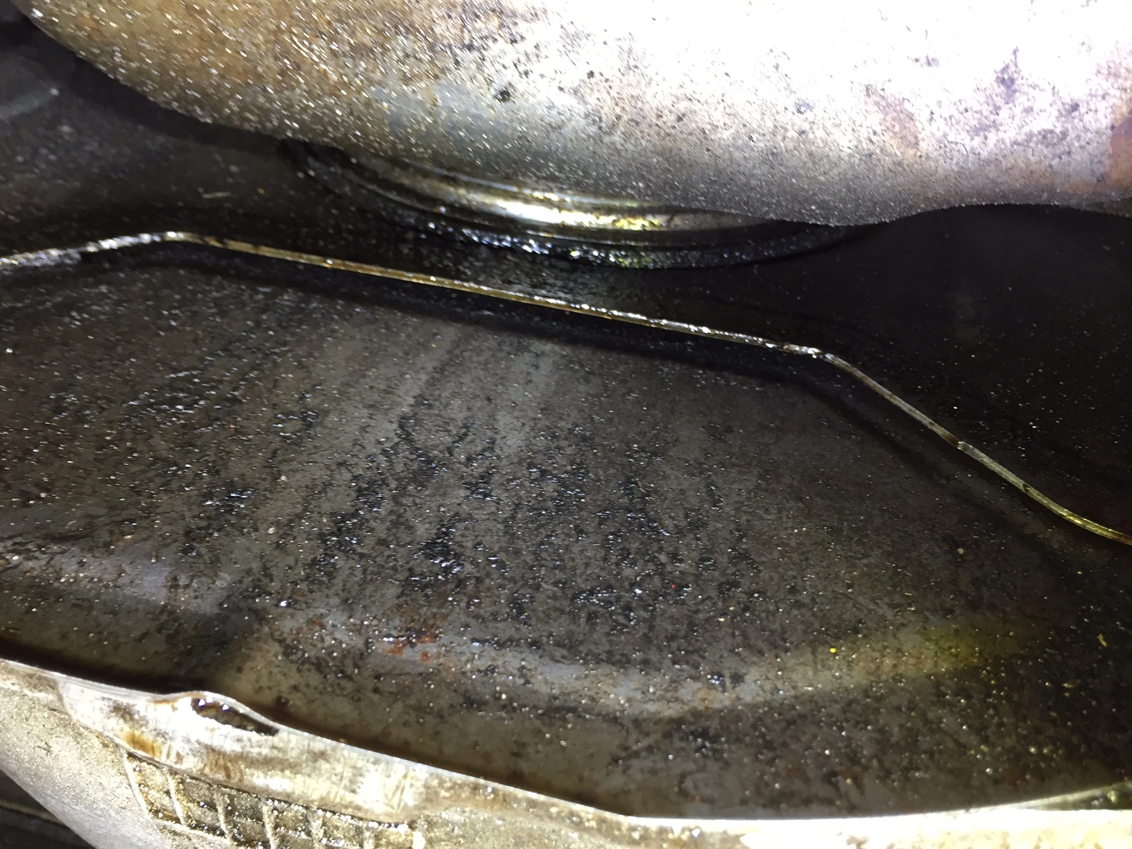

Ok i got up under the car to do an oil change today and found a mess. im guessing this is where my oil has been going. prolly not enough to make a puddle or its burning off. considering that whenever i drive the car, after its hot and you get out i often smell something burnt, kinda like burn popcorn. im guessing this is what it is. judging by the location, right between the tranny and engine, im guessing its the rear main seal. everywhere else is clean, except for the around the filler neck on the head cover. for some reason i always have to clean up oil around filler neck. see pic for underbody oily mess.
