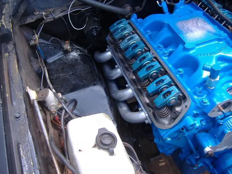

Swapping in a 351w isn't all that hard, if you use the factory exhaust manifolds. The two different headers available for the swap involve some work. I think (not 100% sure) that the Hedman's require the motor to be repositioned by using a plate. Another brand requires a battery relocation and some modification to the fender wells.
Also, depending on the intake/carb setup you go with, cutting the hood for clearance may be needed. If you go with a low rise intake, you can manage it without cutting.
Other than that, it's a drop in and go. No changes needed to fit the radiator, shroud, starter, etc. I did buy a bracket to adapt the 302 power steering bracket to the 351, but only because I wanted something that looked better than the hacked piece that was in there.

the headers that hedman offer, i'm pretty sure they go right underneath everything, so from the heads straight down, so it can clear, cuz i guess they cant fit through where the tranny is..and how does that whole motor plate thing work..

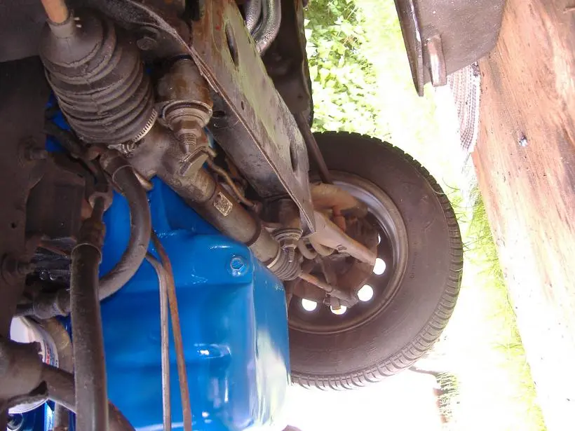

The 302 oil pan will not fit the 351w, so the oil pan for the 351w must be used and modified to clear the rack and pinoin steering.
You're absolutely right, I totally spaced that. I had a 351w pan customized with a baffled 7 qt. deep sump. Cost a bit, but looks and works great.

The headers I used are old Blackjacks that came with the car.
The oil pan I modified myself. I cut out the section that wouldn't clear the steering, and welded a section in that did.
so what do u have to do get a 351w pan and take it to a shop and have a modified to fit cuz of the steering rack,
That would be really expensive. Even with my new custom pan, after they mocked it up I brought it home and bolted it to the motor. It needed a bit more massaging to clear the crank. Then I dropped the motor in the car, and it needed more clearancing to clear the rack. I went through that process twice, but in the end if fit like a glove.
