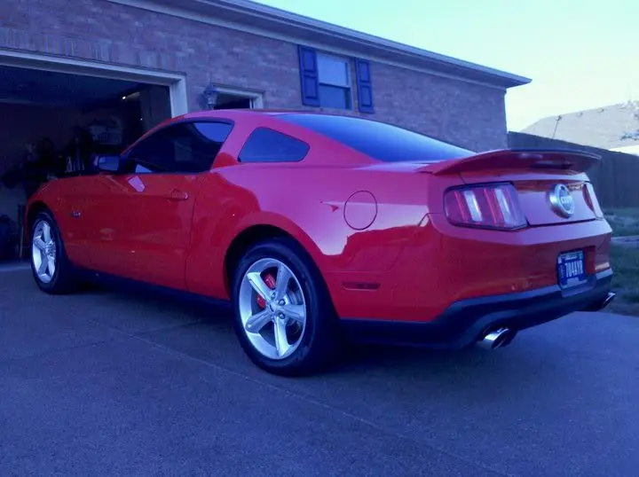

Here is the before pic...
And an after pic...
It was dark when I got done last night and my garage is a little tight, so the pics aren't great. I'm off work Wednesday and will get some better shots of it.
I'm glad I did this myself because it really wasn't that hard.... it was just time consuming.
