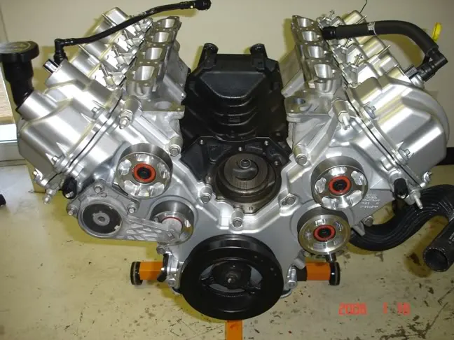

First I want to thnak you for having the ballz to swap this thing into you car.
I am currently studying that motor to see if it can be installe into a Lightning.
So here is my question:
When the intake manifold in removed on the 3v 5.4 .. Is the intake port area on the heads completely flat compared to one another ? Are they angled like a 302 ? Or sitting flat like a 2v 5.4 ?

BTW: I found the answer to my own question.
As flat as my truck 2v .. good start. I would have scred me to star plaing with adapter plates that compensate for difference in angle.
I'm gonna go buy a gasket for both motor and compare the that way as well.
Bill: does the 5/v 3v have 3 threaded holes in the lower pulley ?
