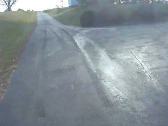

I'm running a 4.11 with an AOD in my 65 Stang with a 408c stroker....you want to have some fun.....get your AOD built up with the 4r70w gearset ;)
Off course traction in first gear will be a severe problem with a 2.84 first gear and a 4.11 rear gear...ask me how I know :D

This evidence is better than my other evidence
(plus its actually 1st gear traction problem and not OD gear traction problem ;) )
