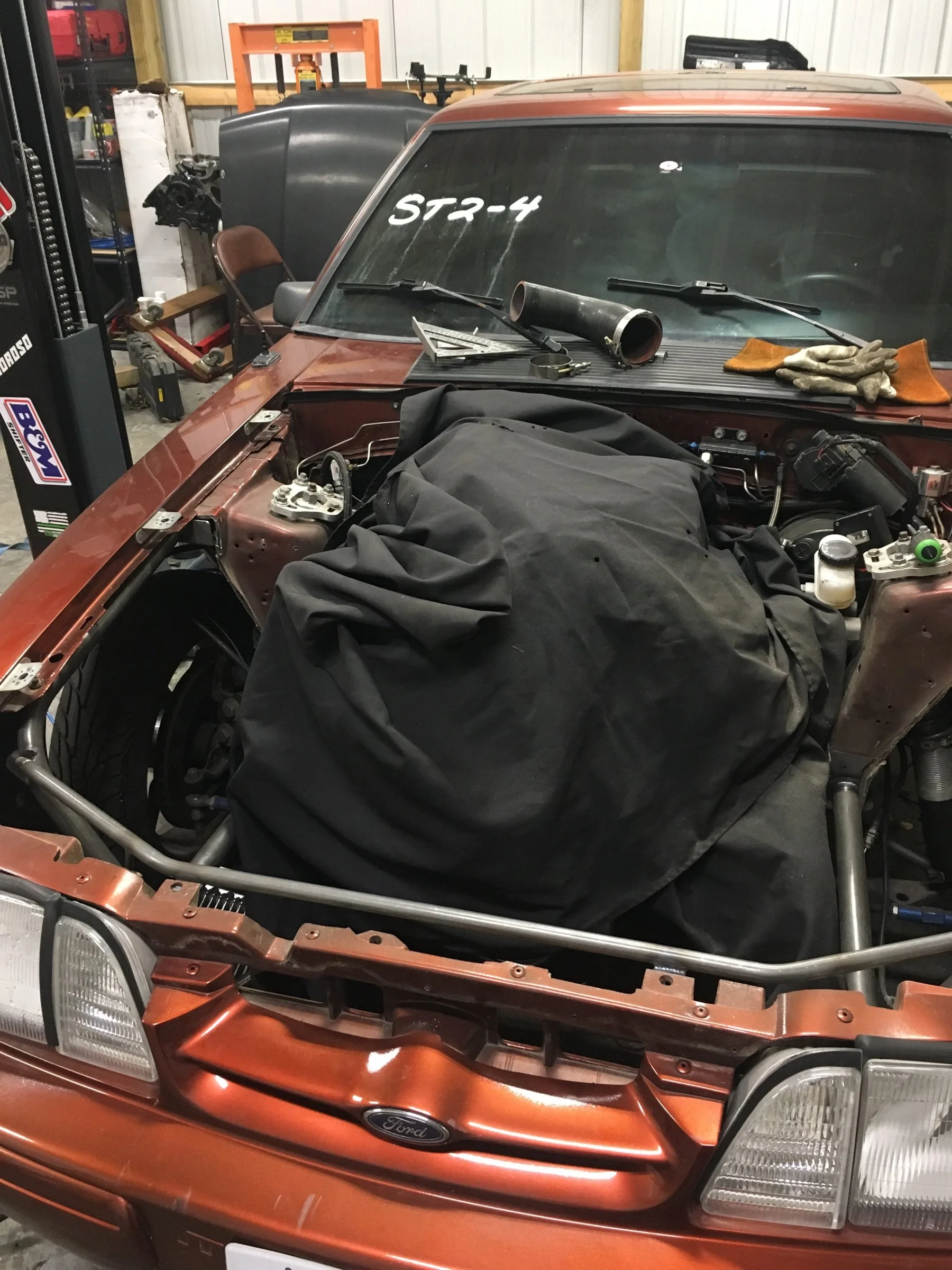

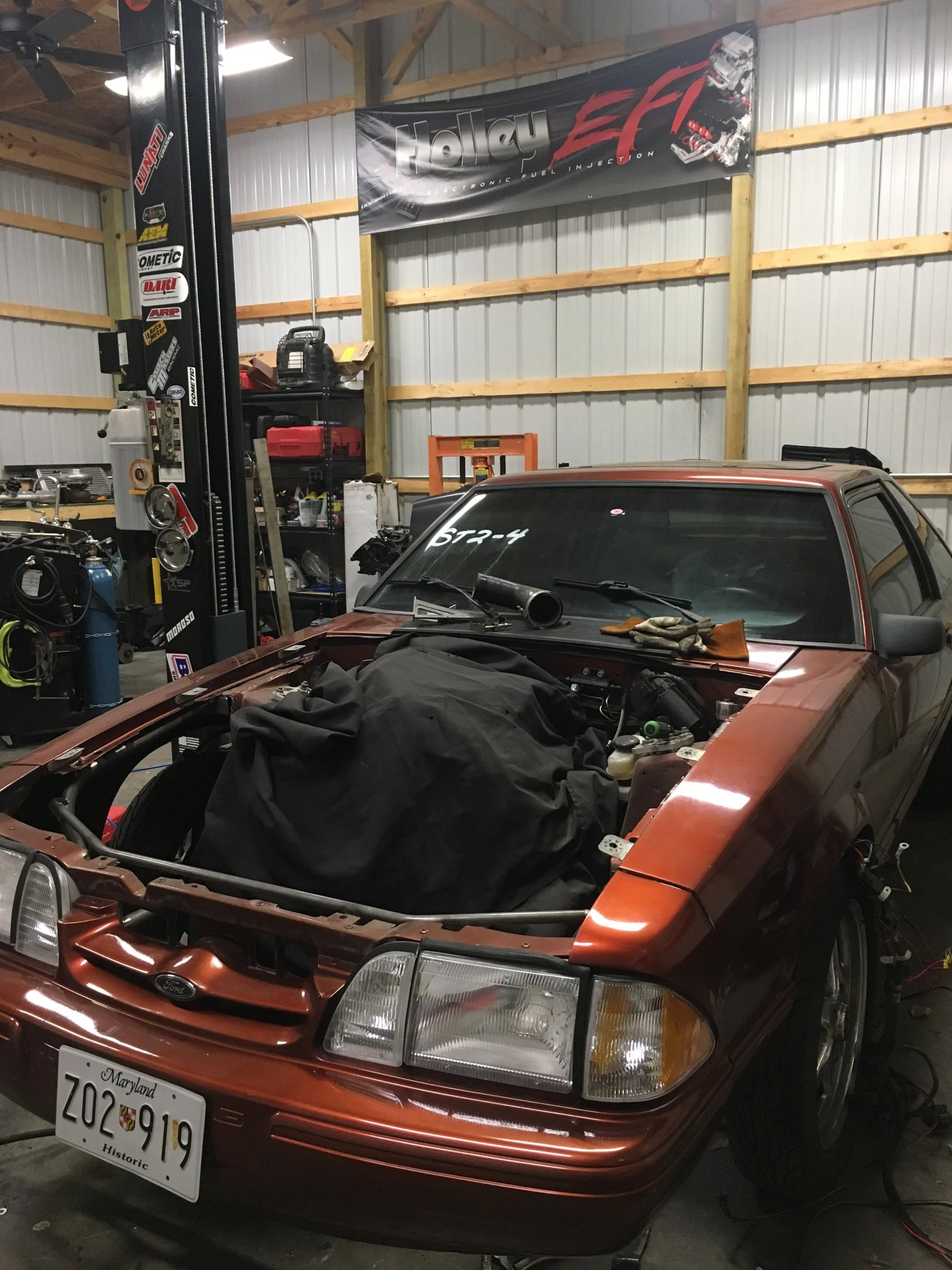

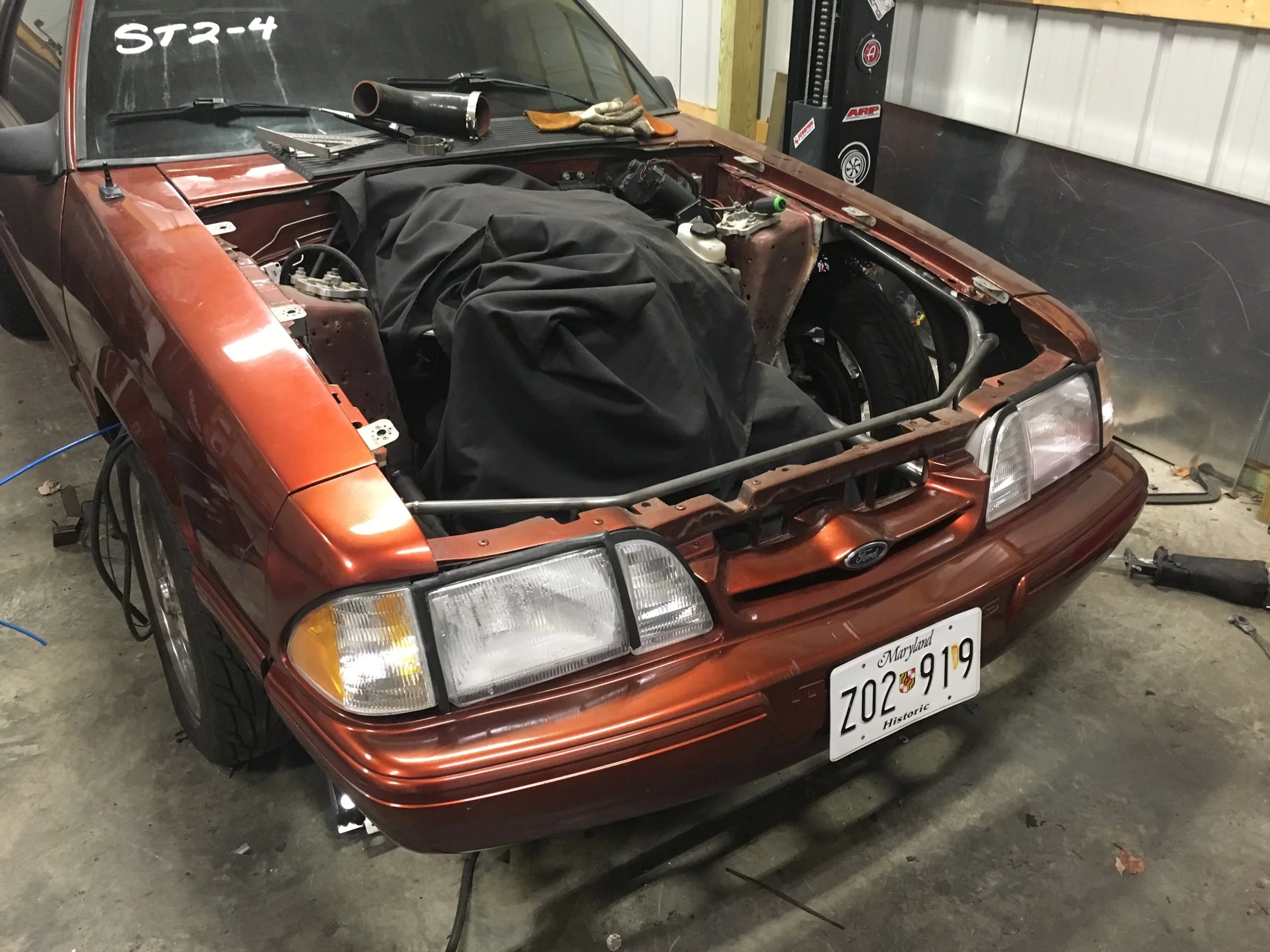

Those first cuts had to be a little nerve racking I would guess.
It was at first but I decided it was what was needed for the car and what I wanna do with it.
so how bad of a job is it?

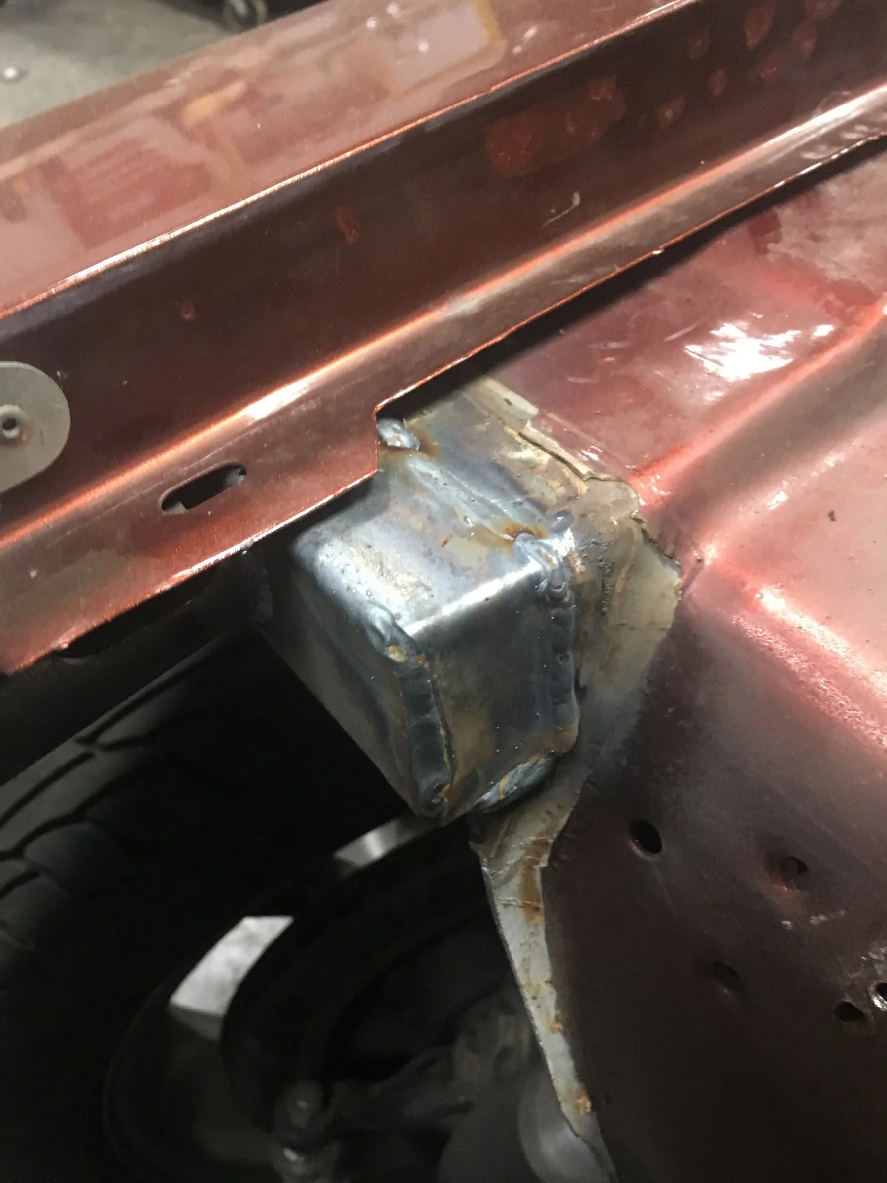

It's not really I used a cut off wheel from top to bottom once I got to the frame rails I did the cut off wheel and finished it with the sawzall since I still have the headers on the car.

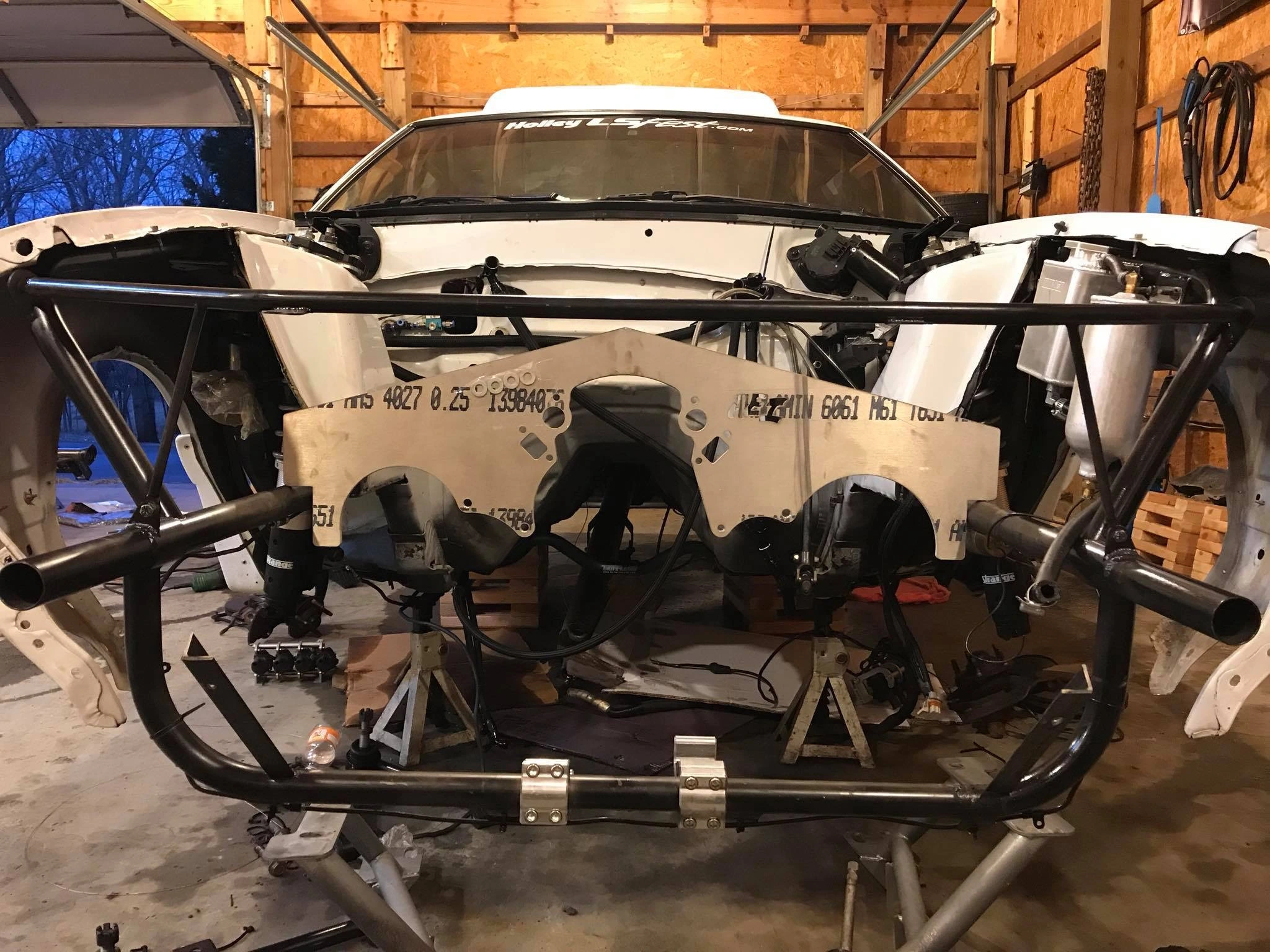

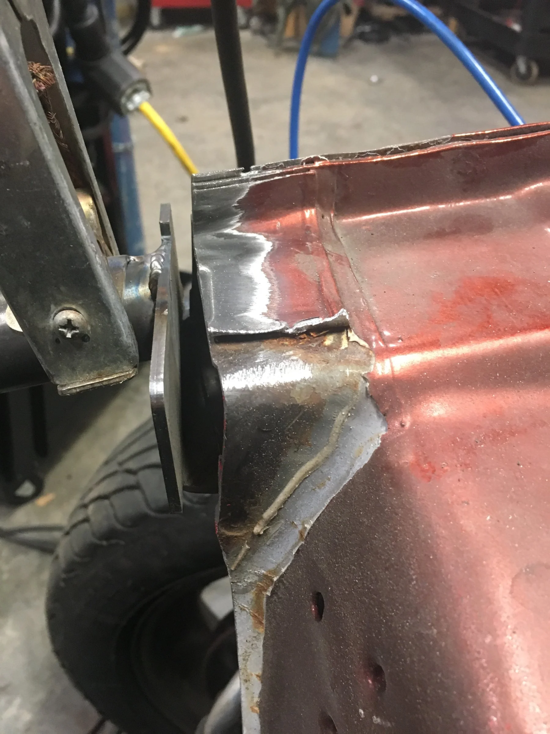

That is a wrap this install was a lot easier then I thought it would be. I messed up the top side frame rail but a few bent plates and I was back in action.
looks great man! my only issue doing it would be putting motor plate tabs on the tubes vs the square frame rail. i dont have access to the CNC plasma anymore so cutting tabs is a lot harder than it would have been before
I didn’t think it looked like that much of an issue but I’ve never had CNC access to begin with lol. Mine was never gonna be that fancy.
I wonder... For someone like myself who'd like to keep the sway bar - Can I leave the frame rails a little long and then weld the tube frame on past that, or does it defeat the purpose entirely?
im sure you would have to modify what they make or have them do it. but the frame rails on the X car are stock till the motor plate per the rules. then its all tube after that.
