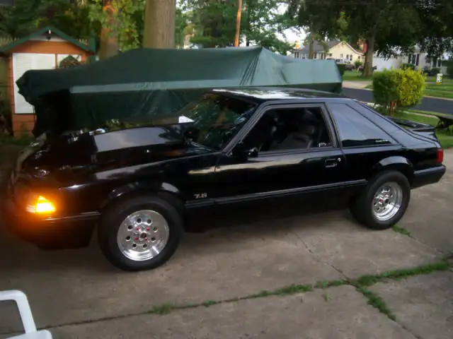

i can tell most of you bashing bb motors have never owned one or built one, there very cheap, and can stand up to LOTS of punishment. Oh and my swap costed me about $6500 for everything, i do have connections at ford racing too.
If your building this for a DD, then forget it. If its a weekend car like mine, then go for it, im glad that SmockDoiley and a few others on here helped cheer me on when i brought this up in 2004.
I own one of the most unique foxes in Ohio now.
Heres what you can do if your creative:

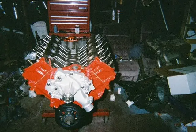

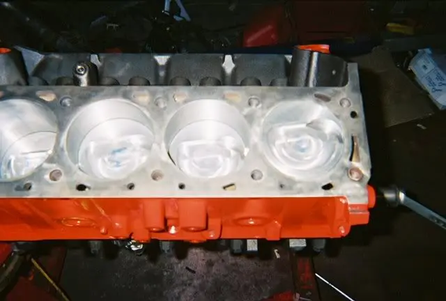

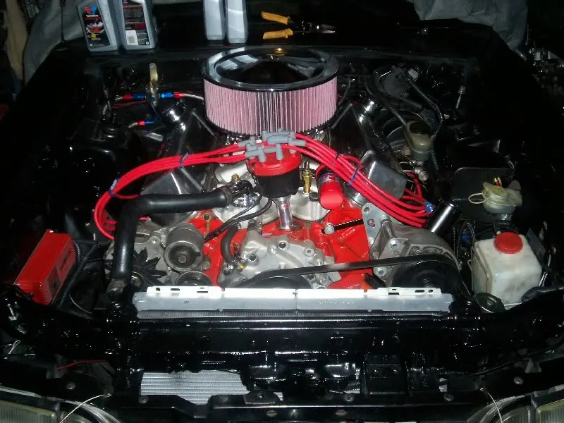

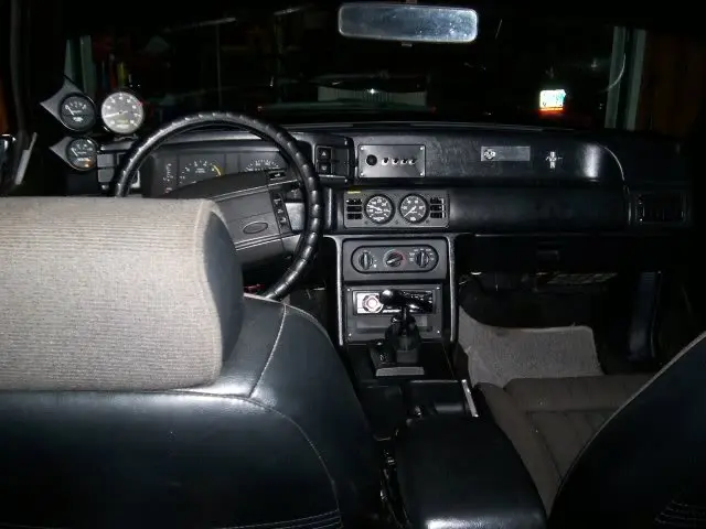

I went from this (have a special plan for the 5.0 in another car):
To This:
