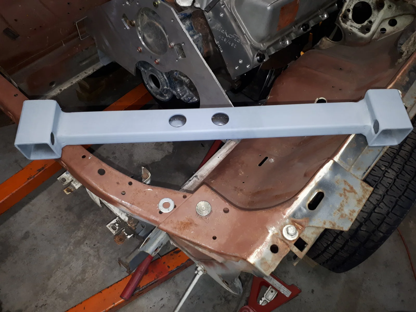

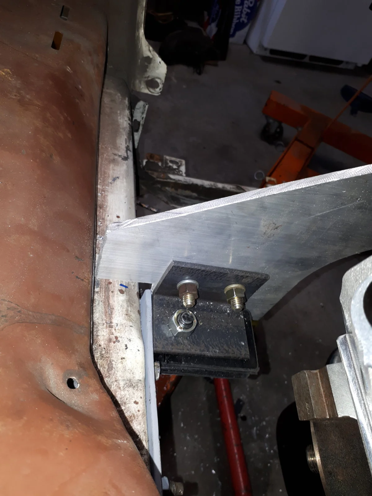

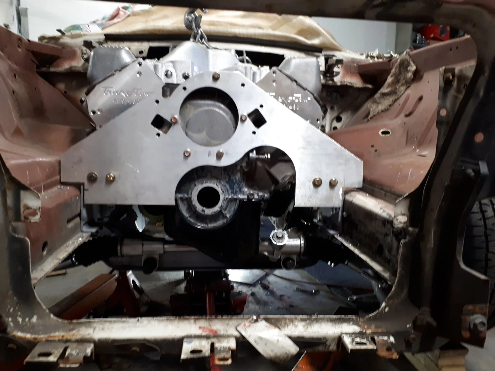

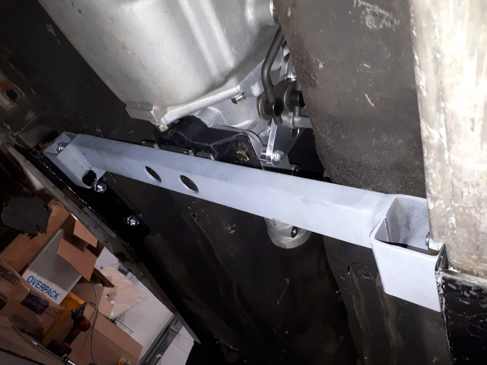

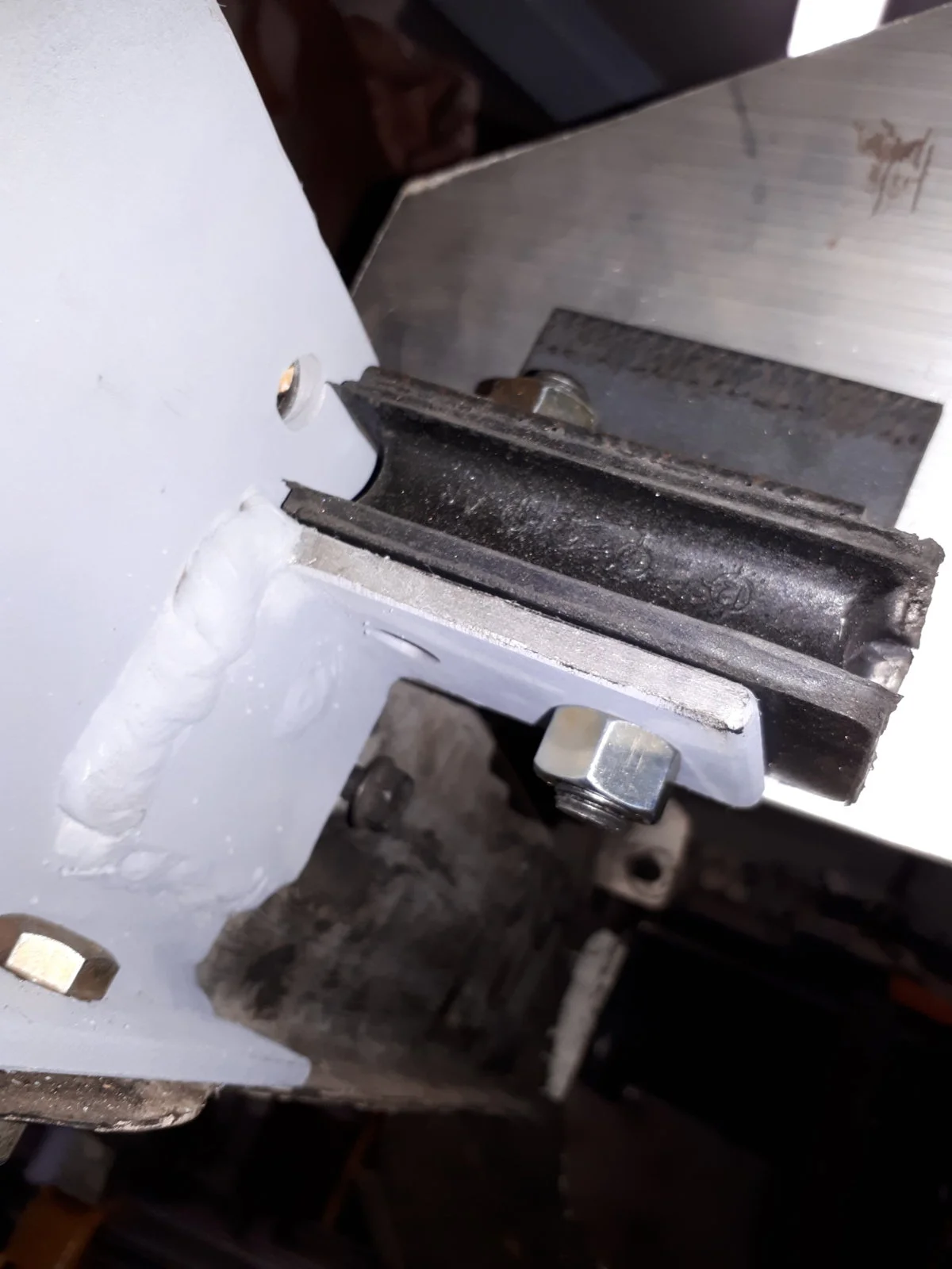

Engine and trans mounted. Now waiting on the mid plate. Got the engine set at 2.5 to 3 degrees incline.

Man, even with that plate in the way you can still tell that you're gonna have fun trying to figure out your exhaust routing!! Otherwise that engine looks like it fits fairly well considering..... :D

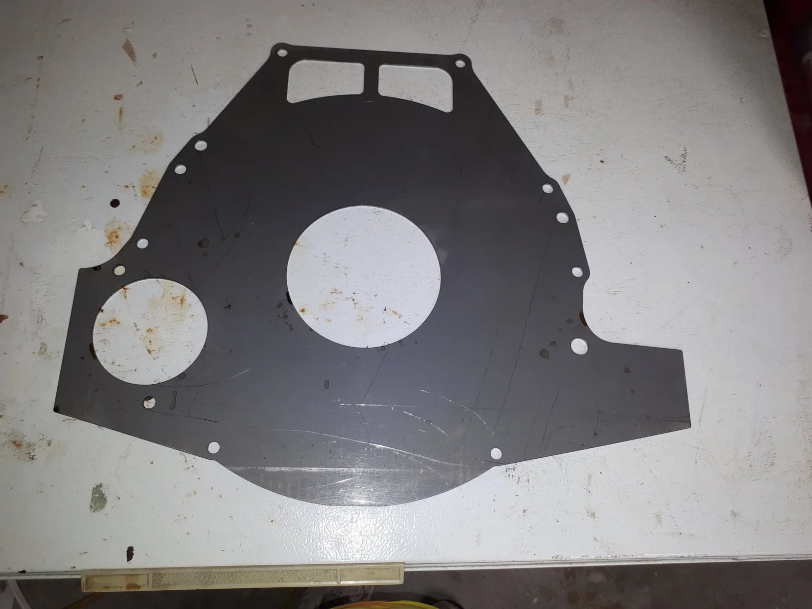

Ordering header kit today..Mid plate is almost finished, Started mocking up shaker and cut the hood. I think I may have to order the Starter so I know what room I have to work with as it is going to get real tight in there.
