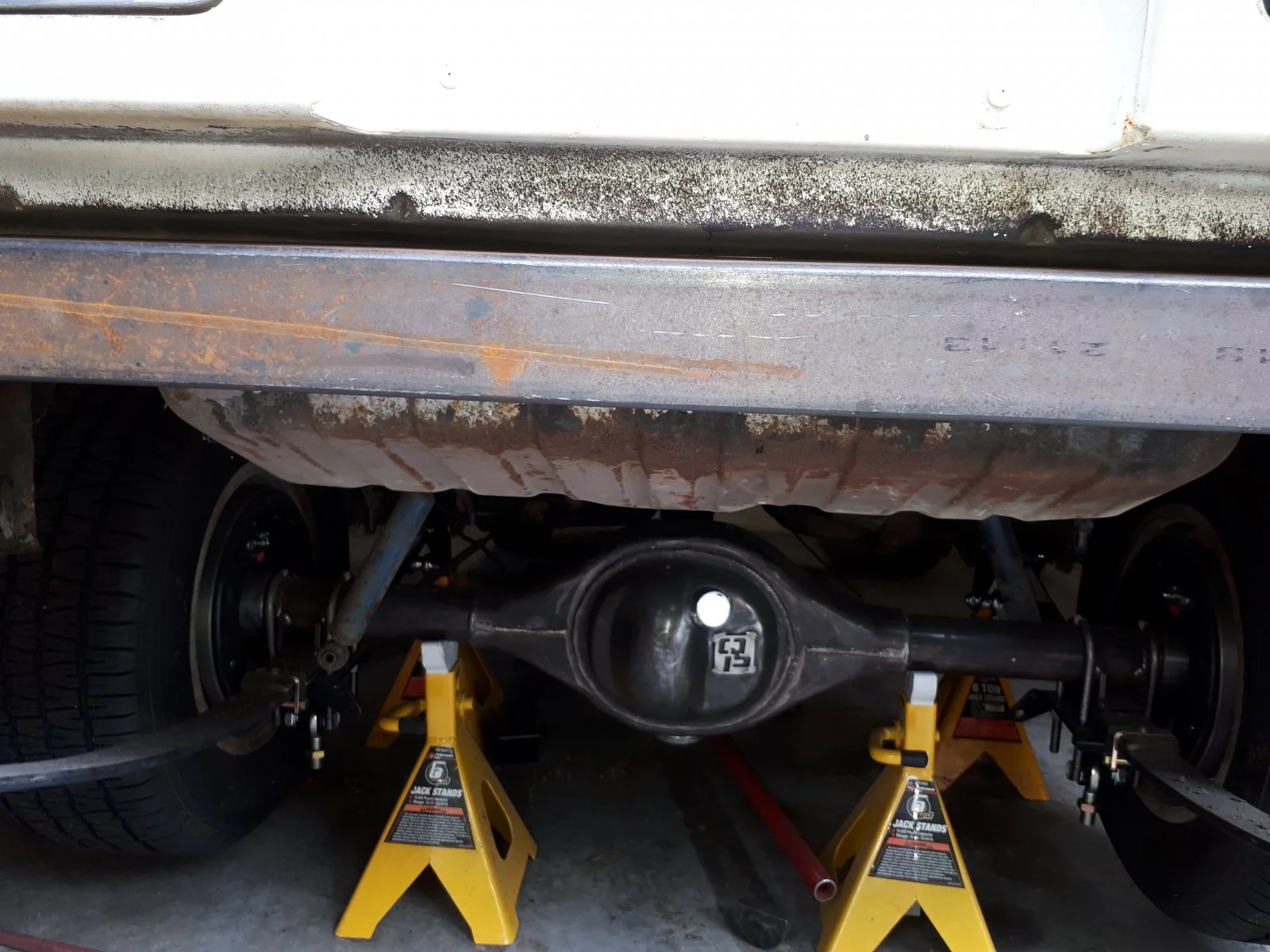

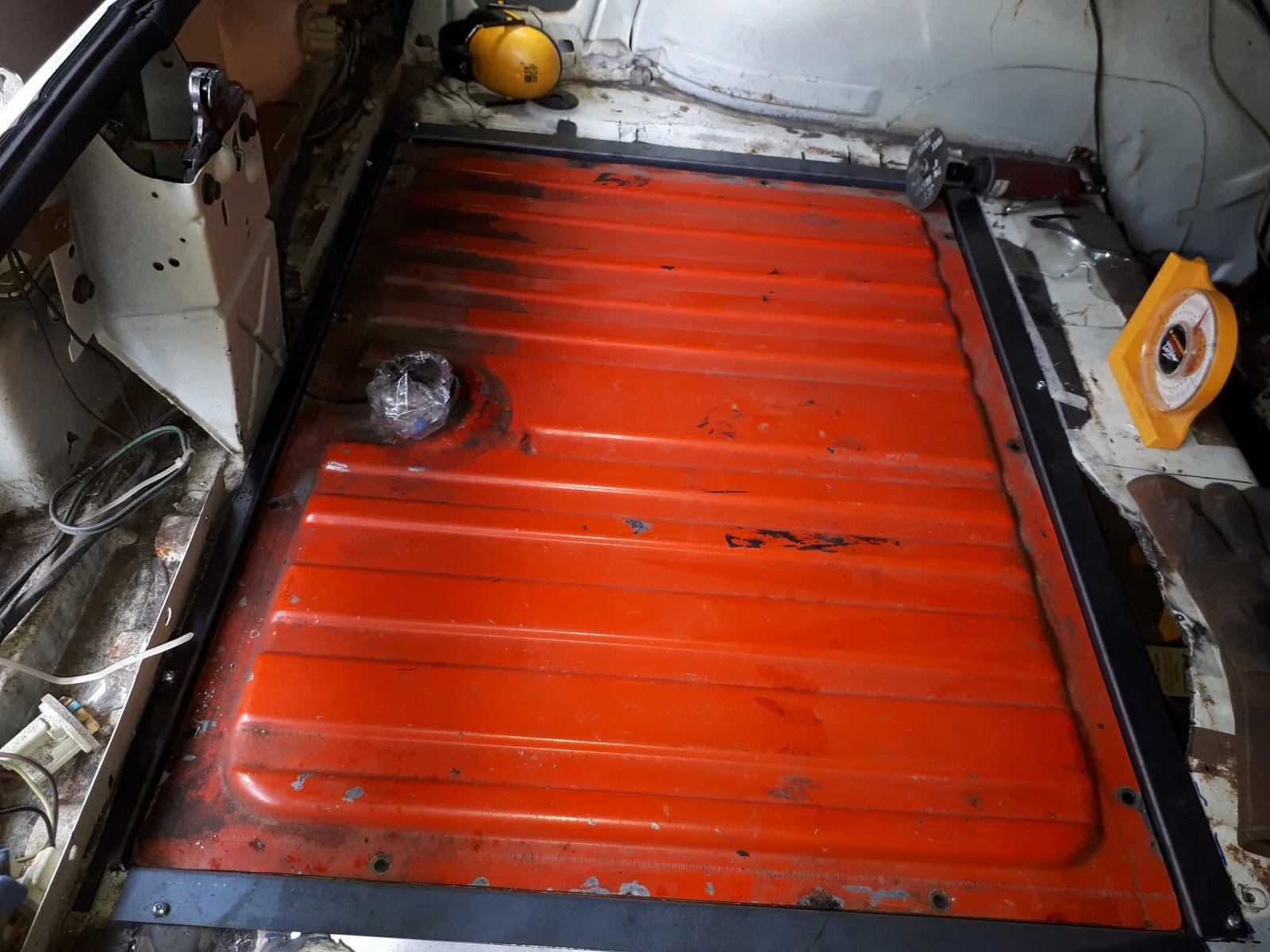

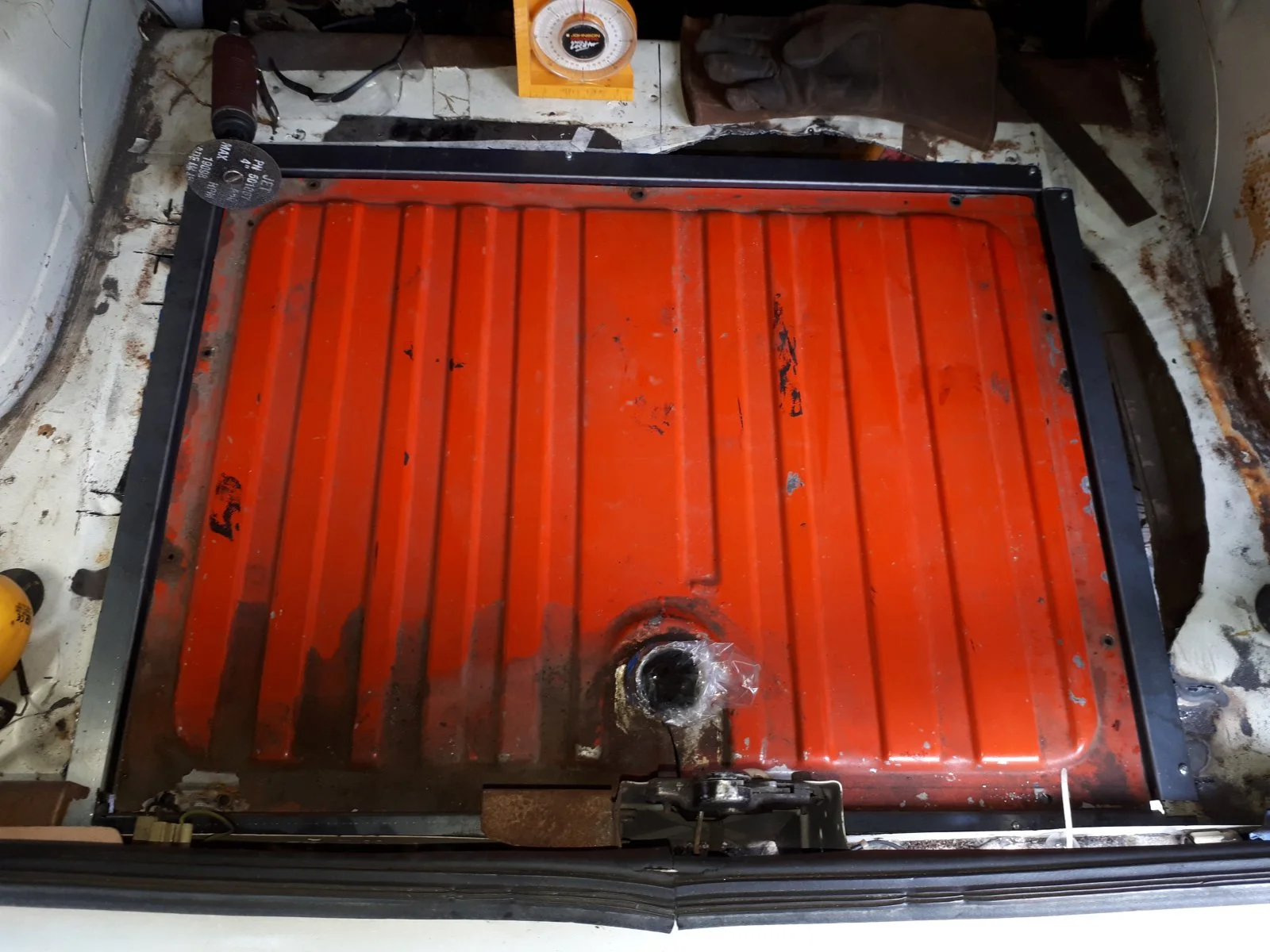

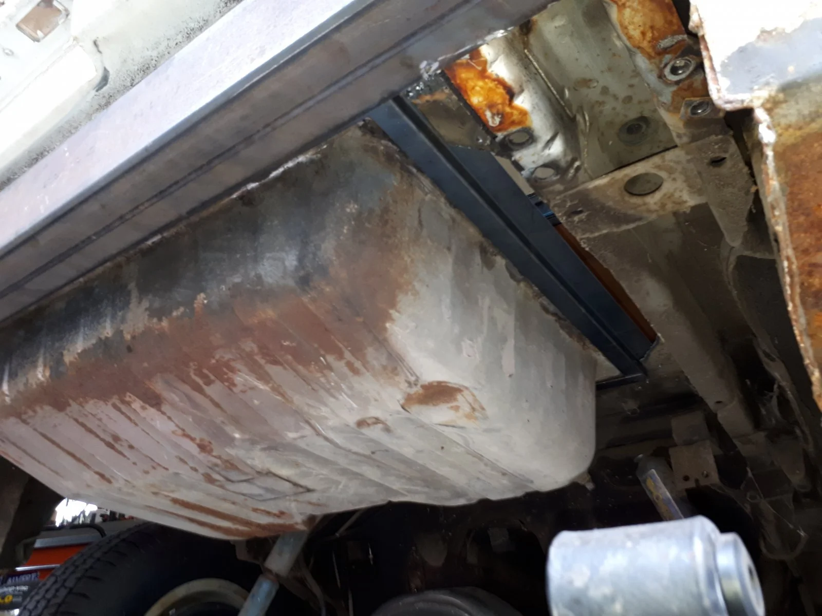

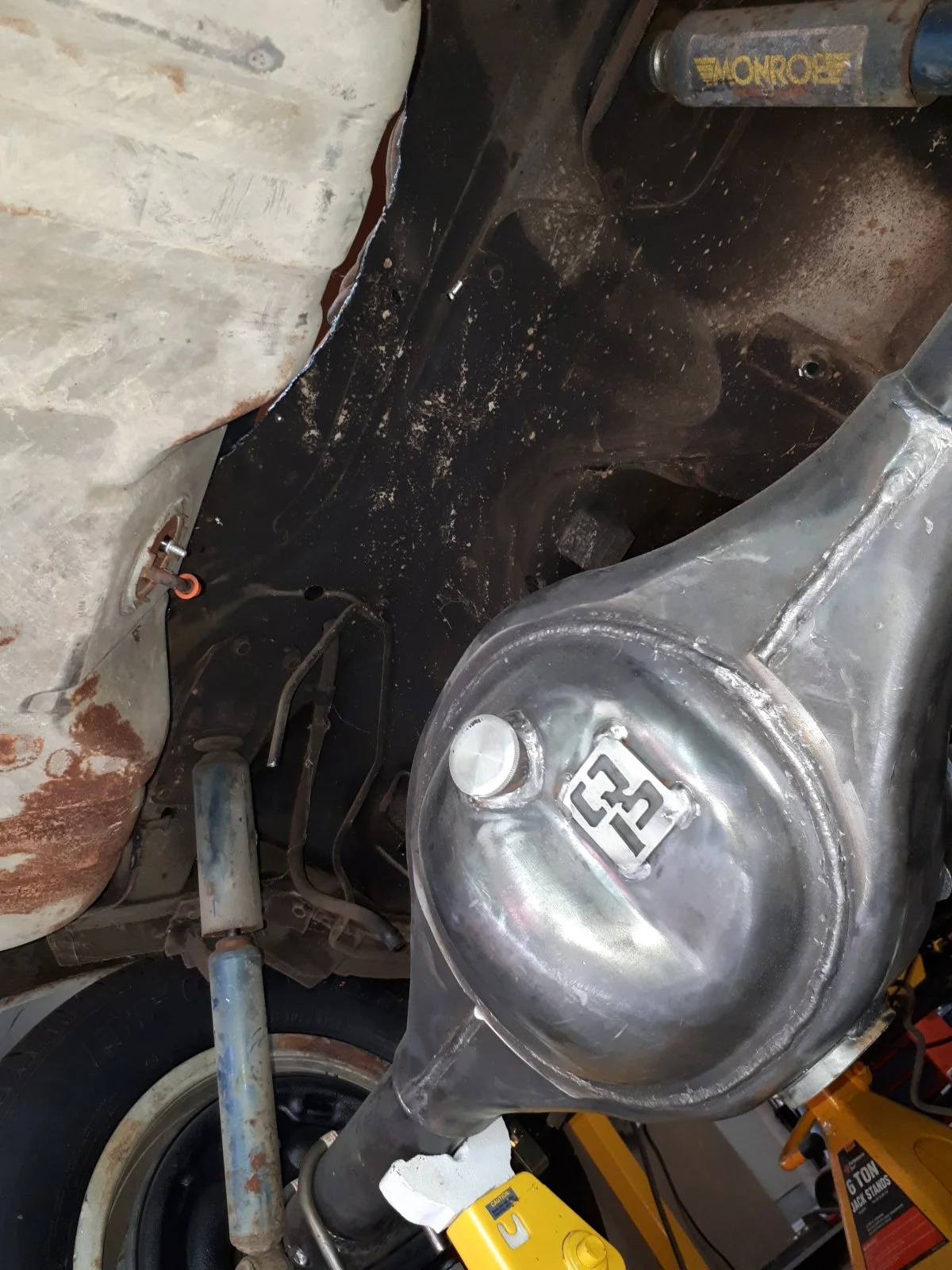

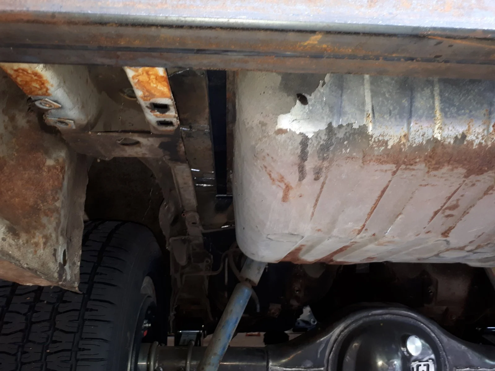

tank is in...now to take it all back out and welderup nice

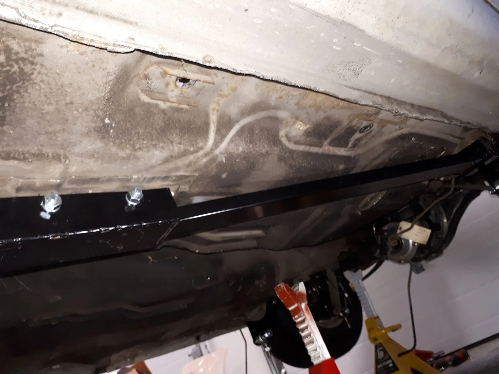

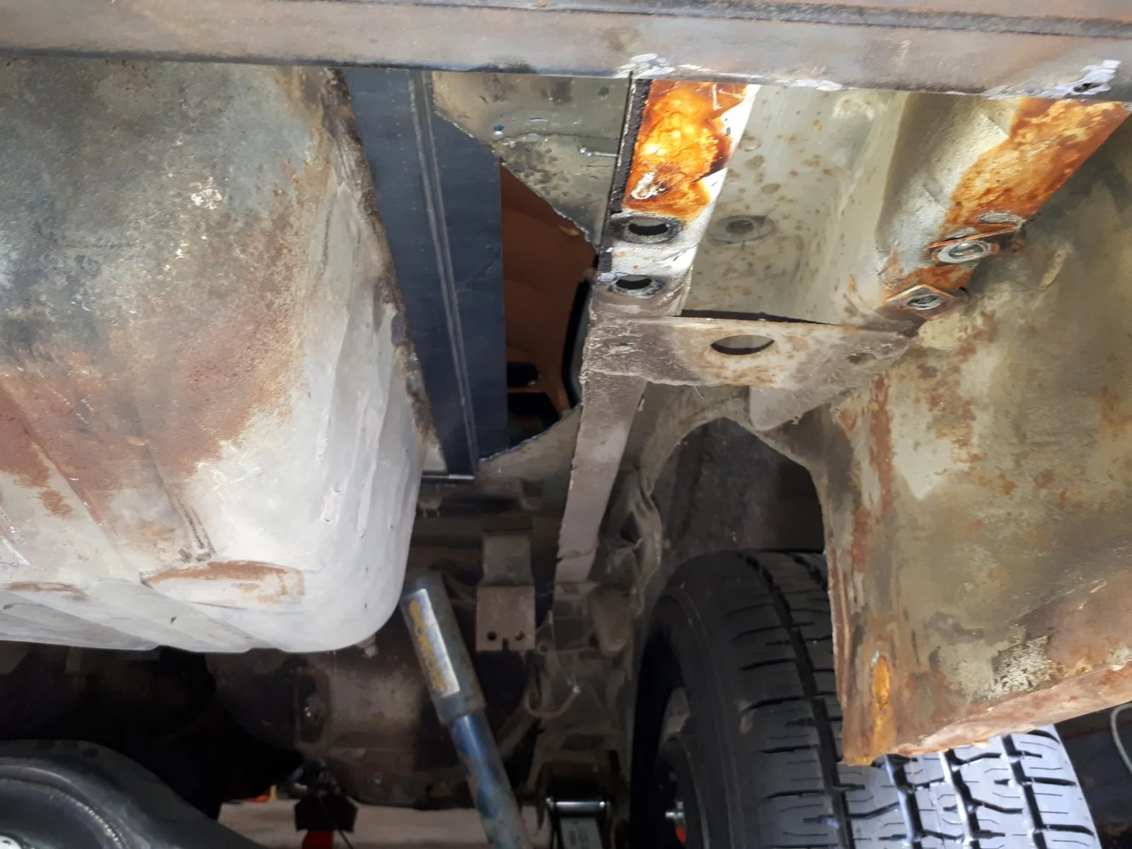

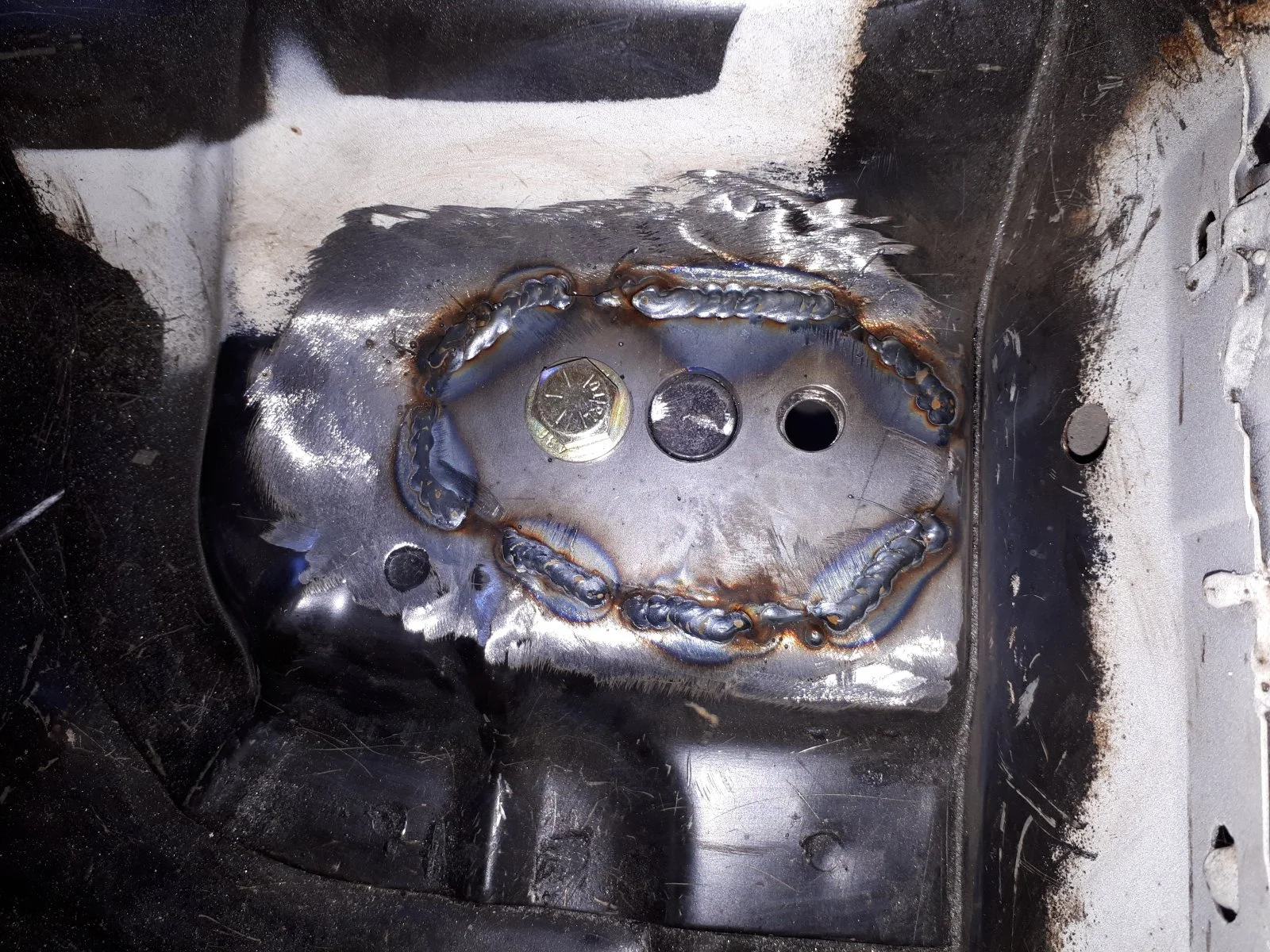

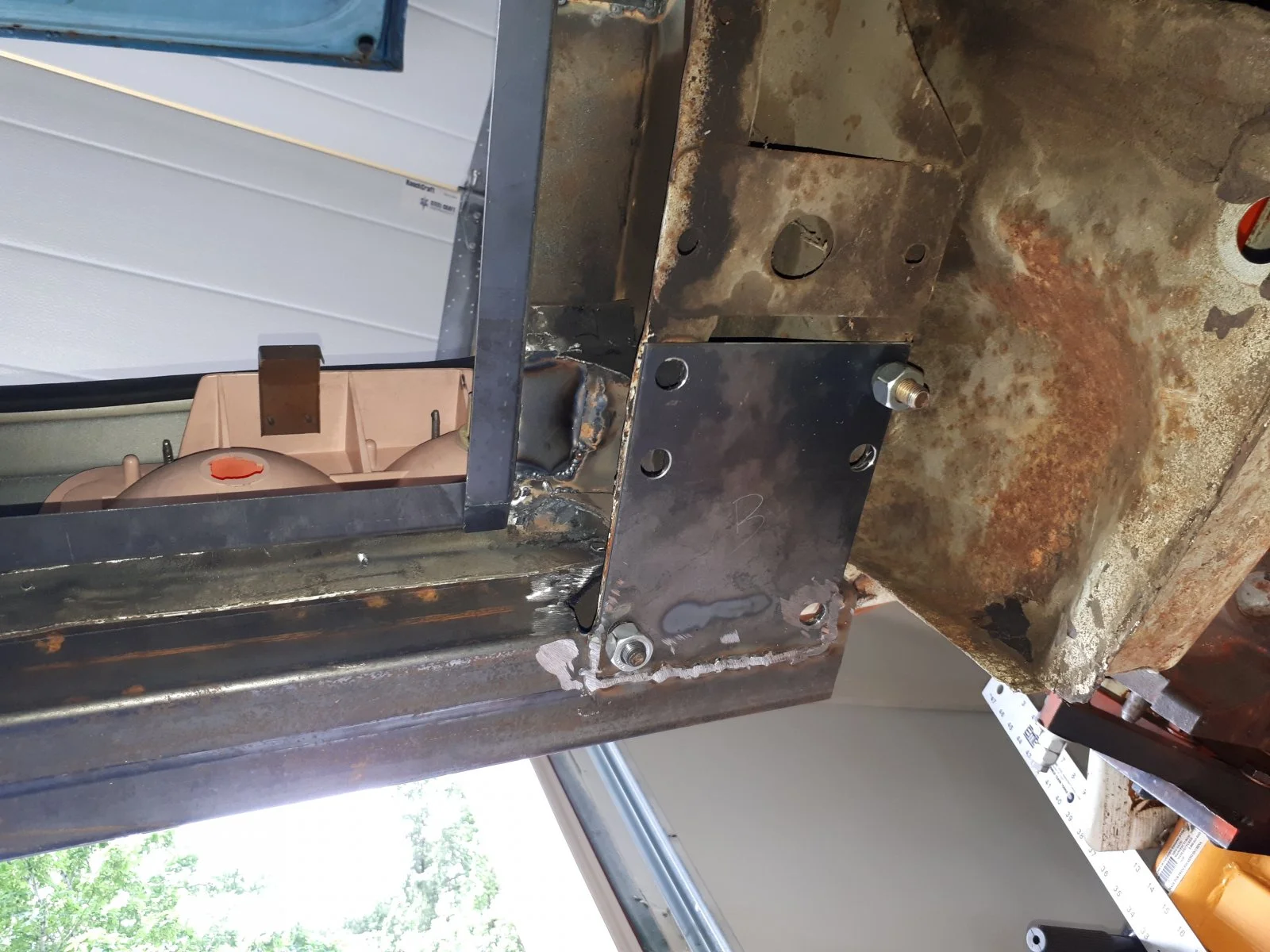

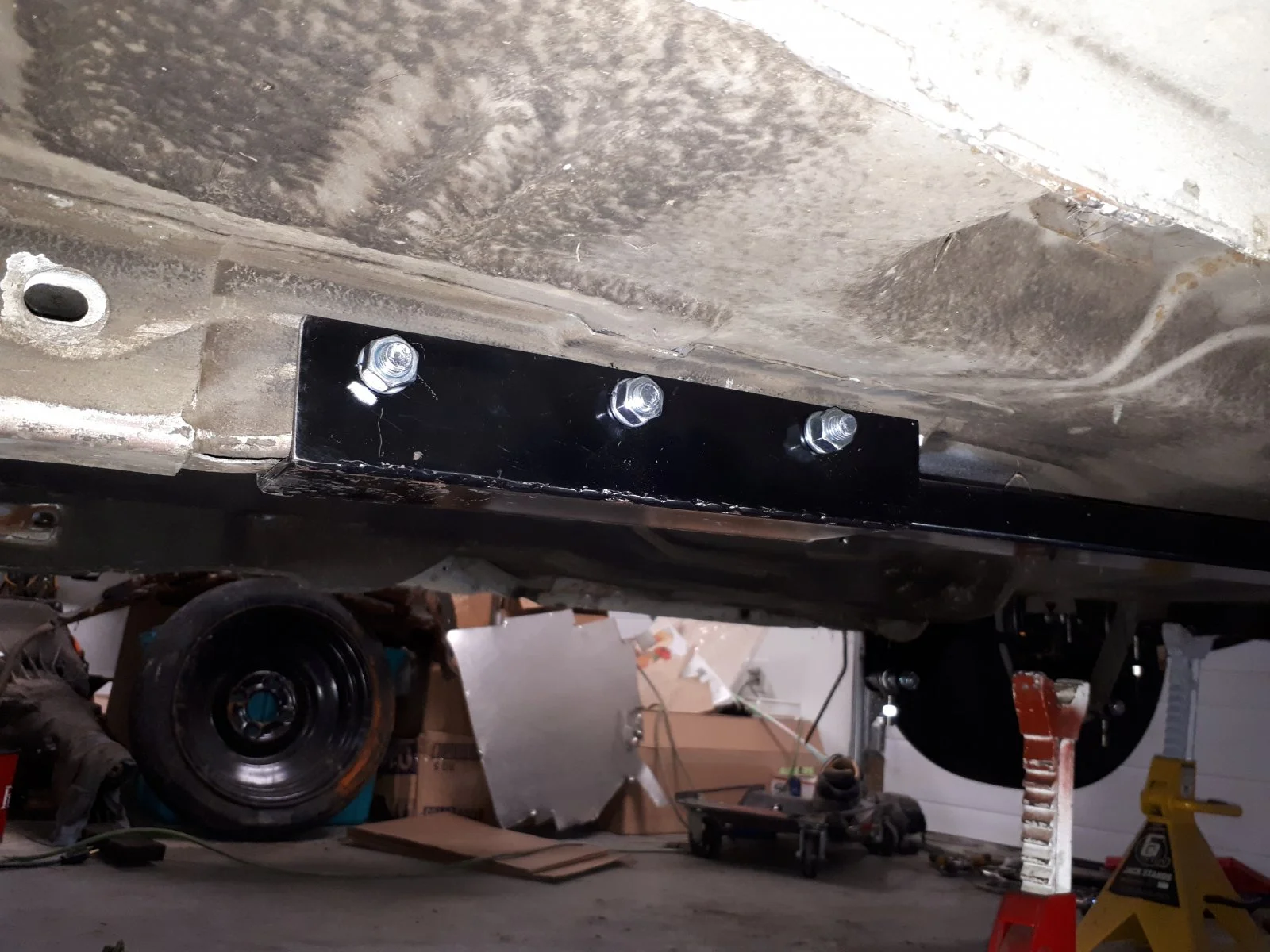

Working on sub frame connectors and torque box reinforcement today. I am surprised how beefy the torque boxes are on these cars actually.. I think it would be difficult to damage them even the way they are. Of course I am adding plates to them because I like to overkill things, but I think these would actually be strong enough anyway. Once you uncover them behind the 20 lbs of sound deadener you can see how substantial they actually are.
Reactions: 2Blue2

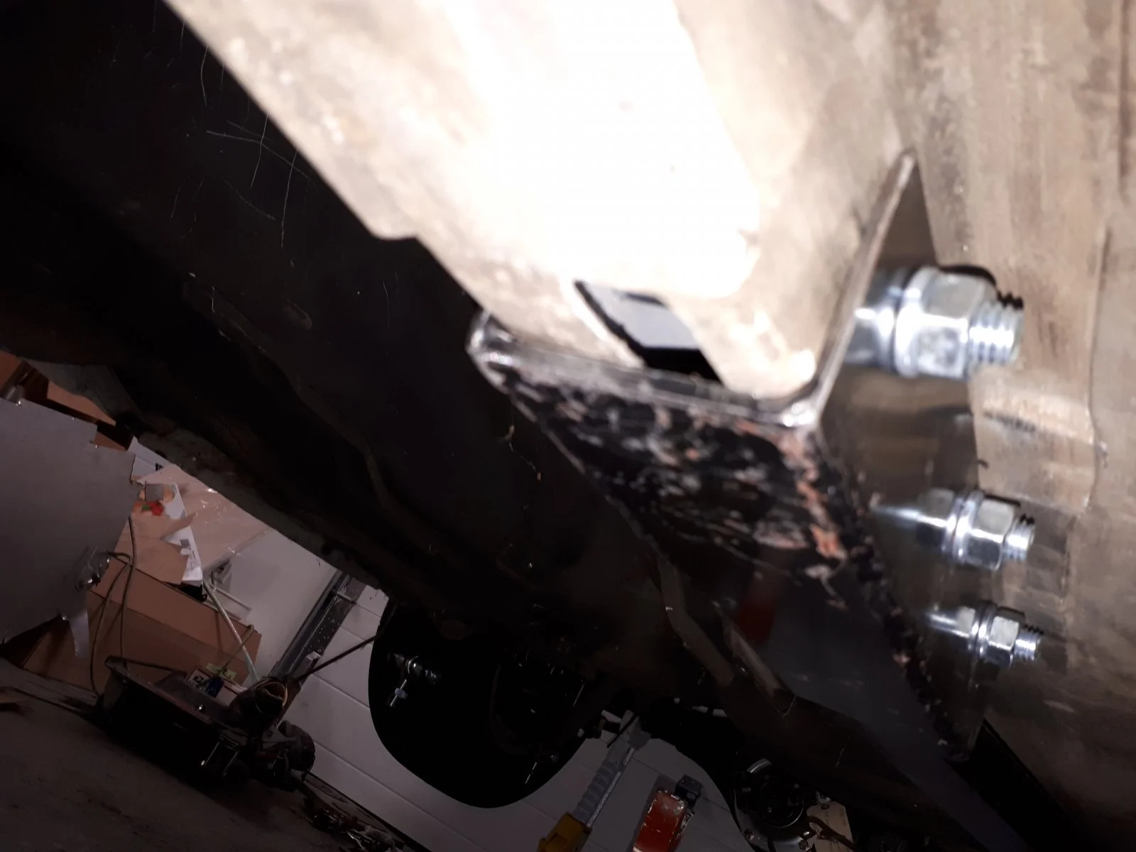

I am basically just making rectangular 3/16 plates to reinforce where the bolts go through, and that is all I think is needed here. I may have to reinforce the frame connectors themselves though, as I mentioned a while ago, as the box material seems pretty thin at 1/8 wall.
Reactions: 2Blue2

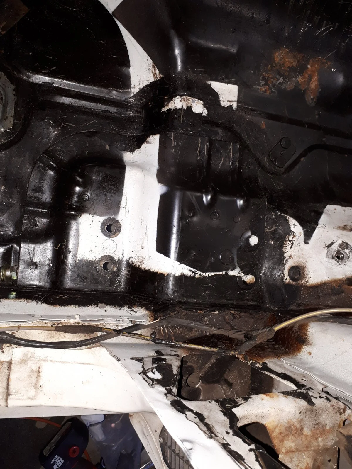

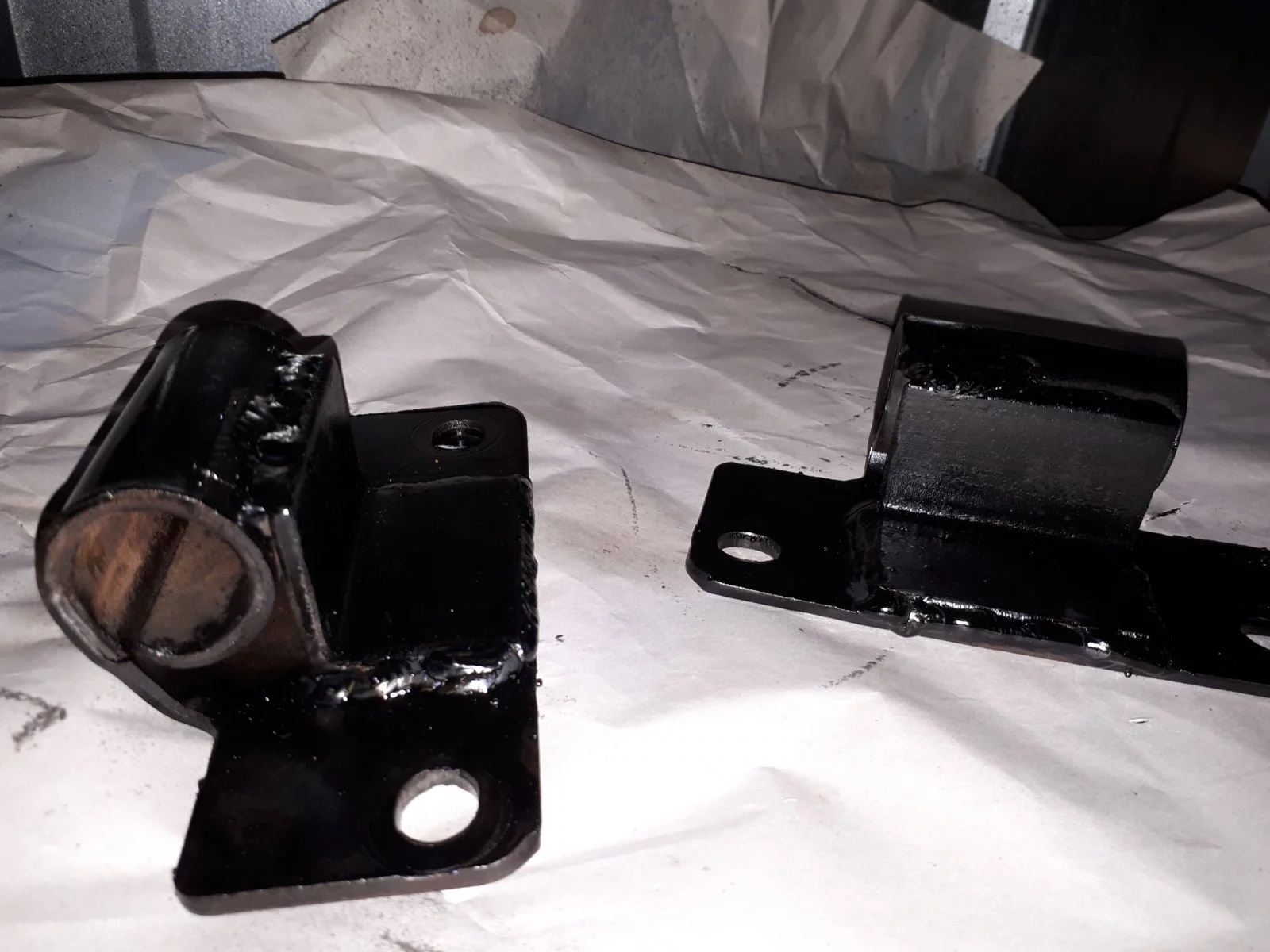

You have to trim up the bump from the rear of the subframe in order to get these to sit up flush with the bottom of the sub frame. I cut it off, flattened it and made new bends so it fit inside the subframe again and welded it back in. Then I put the sub frame connectors on top Not sure if I needed to weld it back in , but it seemed like it needed to be by looking at it.
Leaving them bolt on. It's easier than building new ends for them to weld on. They would have to mount under the perch, so quite a bit of fabbing to do there if you ever want to be able to take off the spring perch for any reason.
I also checked the roll bar mounting on line and it mounts further back where the next two perch bolts are.
Reactions: LILCBRA and 2Blue2
Thats looking great! Especially i like the reinforcment of the rear spring perches.
At the moment my carpet is removed from the car and I'm thinking of tack welding the two bolts of the front spring perch, that I'm able to install the subframe connectors later on without removing the carpet again.
Is the stock bolt length suffiecent for the subframe connectors? Or is there a longer bolt with the subframe connector?!
