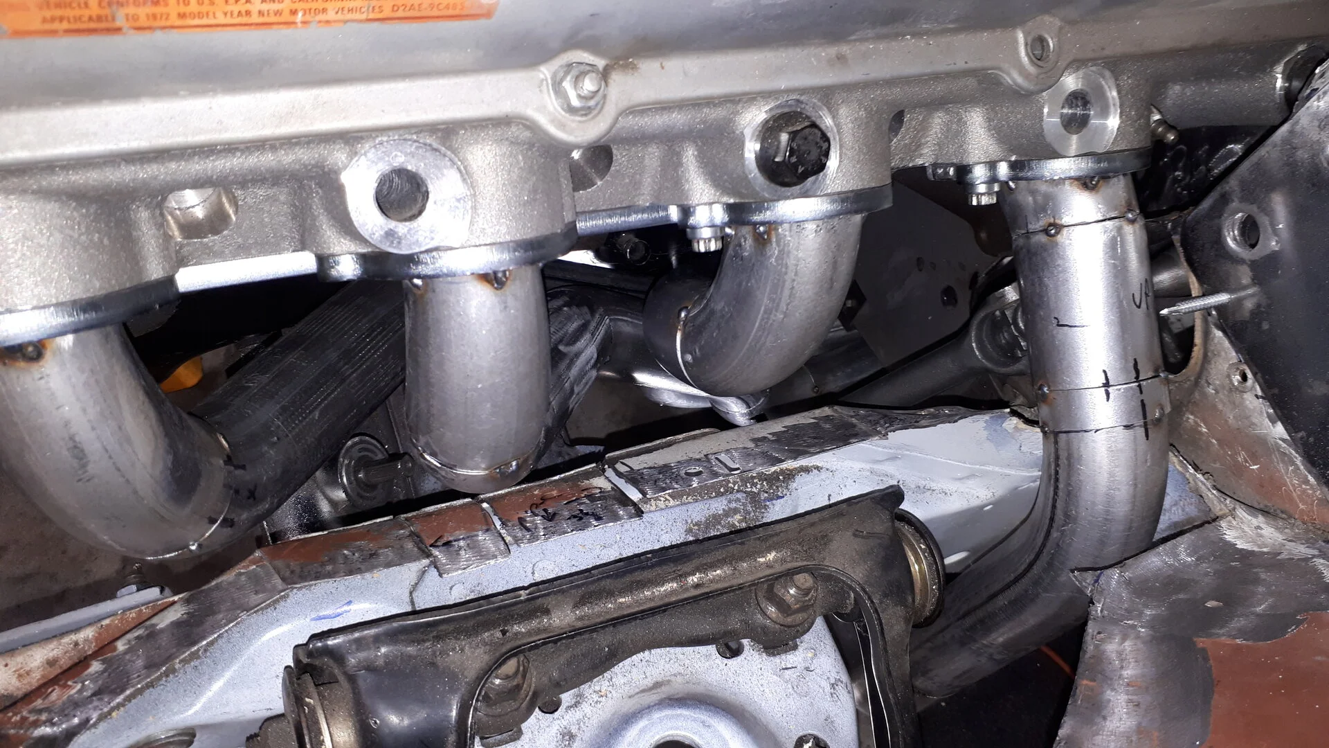

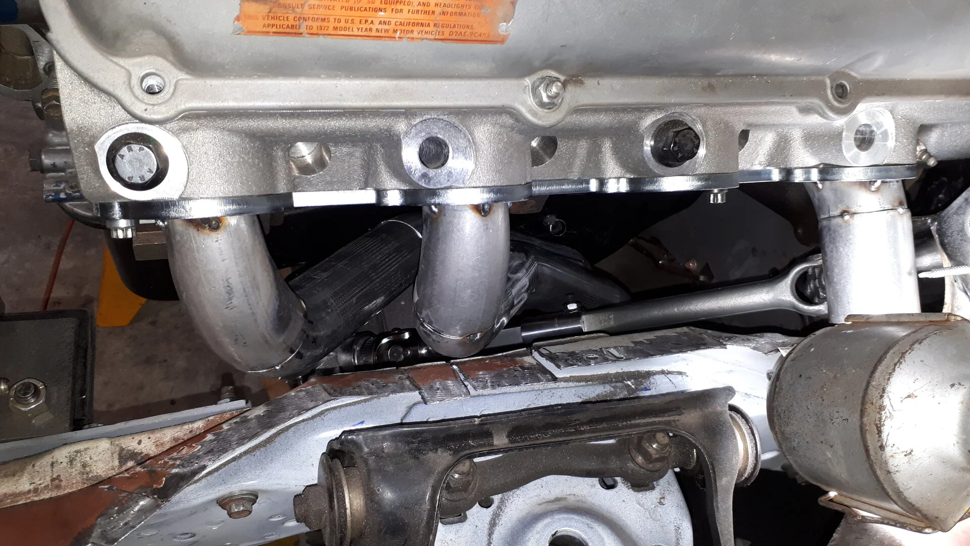

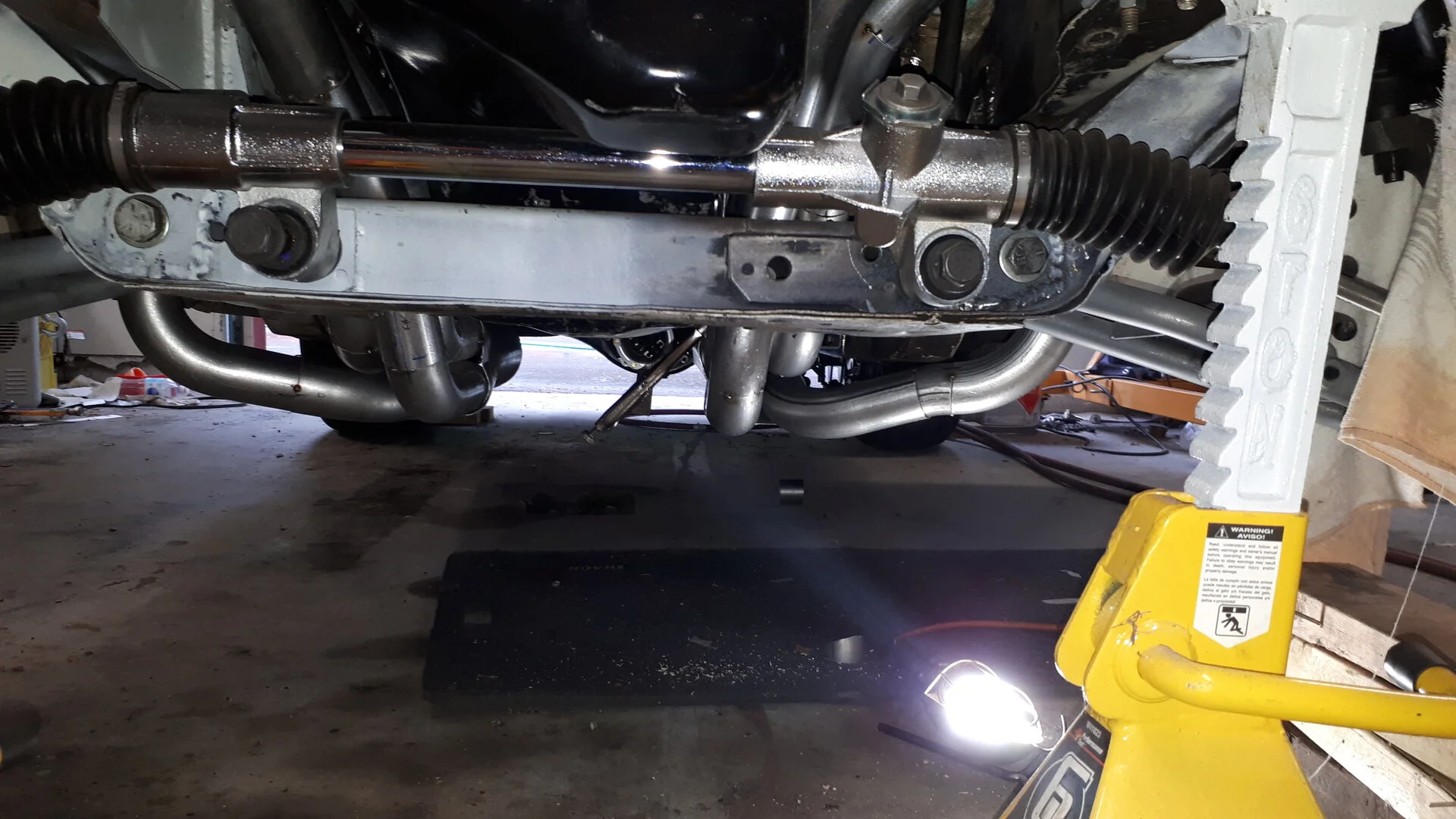

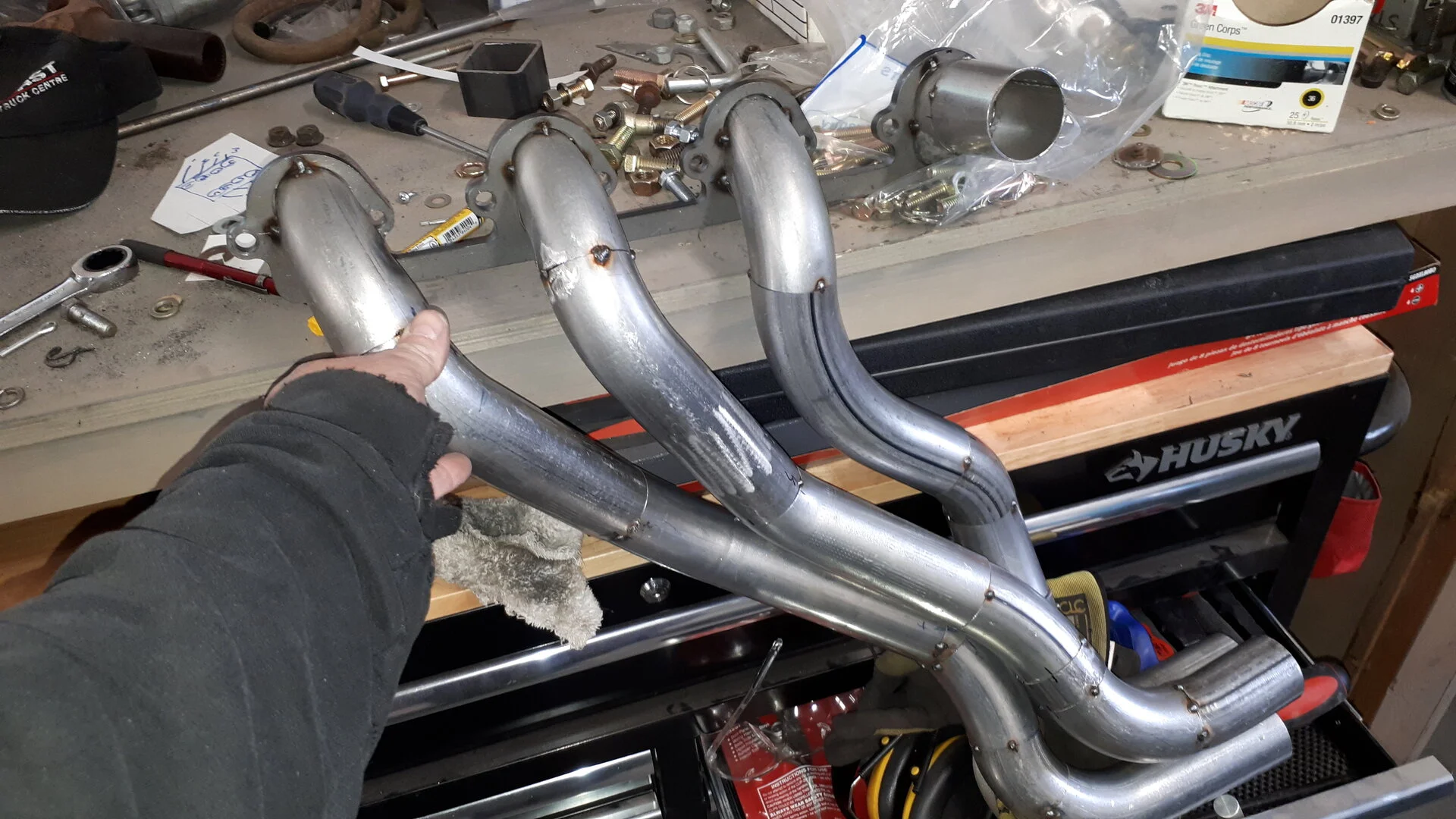

Got three of 4 pipes done on drivers side header this weekend. pics to follow.....

May 30, 2020

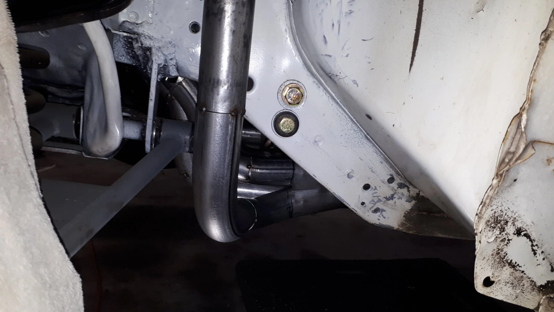

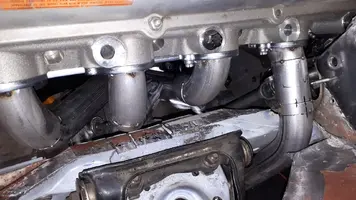

4th and final pipe tacked in. Whew....that was a lot of work and they are only just tacked together lol...
Reactions: Enzio, extra_stout, Olivethefet and 1 other person

This pipes look like they hang pretty low - now I can see exactly why the Sudden Death II sat like it did!

Whoa talk about threading the needle
Is fun to see it happen thanks for posting on this.
Can't wait for sound bites in the future!
Carry on!

The pipes look lower than they are. Still above the scrub line. But yes a tight fit for sure...I am starting to fill in the holes now...
