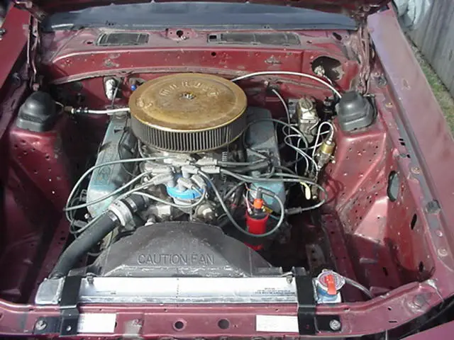

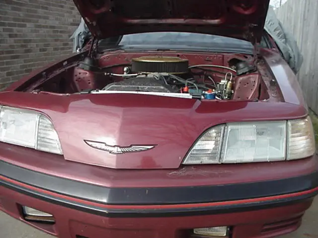

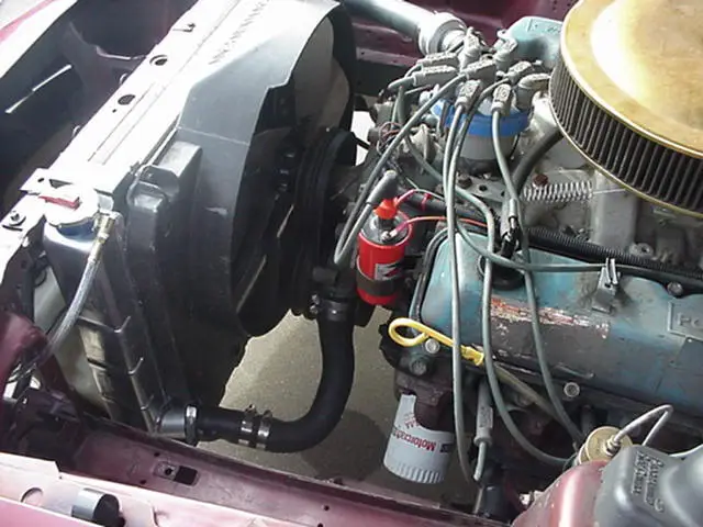

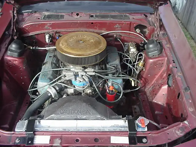

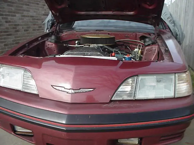

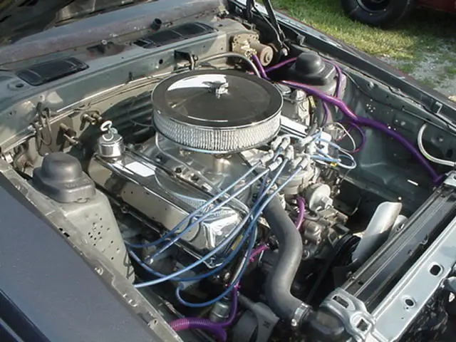

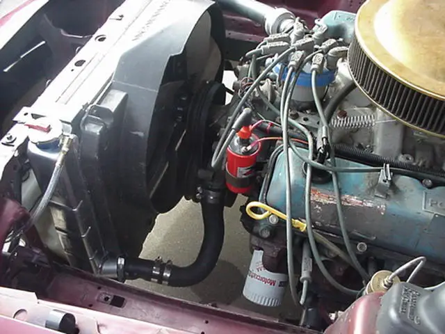

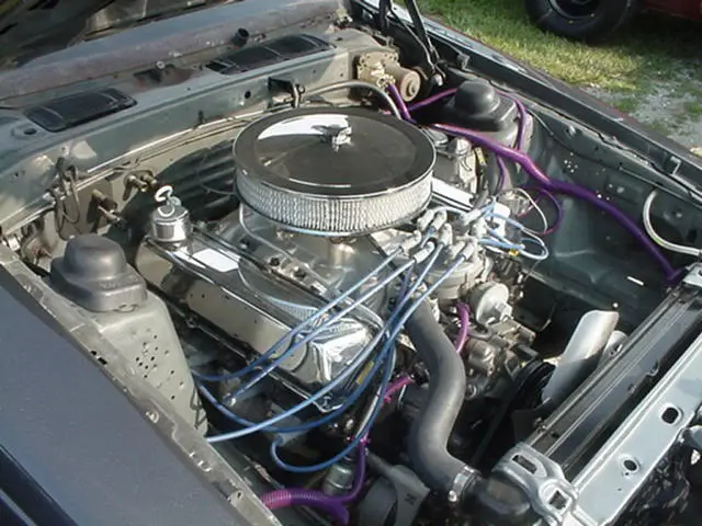

As far as space in the engine compartment, check out the photos of my 87 Maroon Turbo Coupe 460 install and the 460 in our 83 Gray T-Bird.
The TC 460 sits one inch lower in the car than the Gray Bird.
Of course the TC has one-off special solid mounts and 1/2 k-frame spacers.
Clears the TC hood by 1/8th inch !
