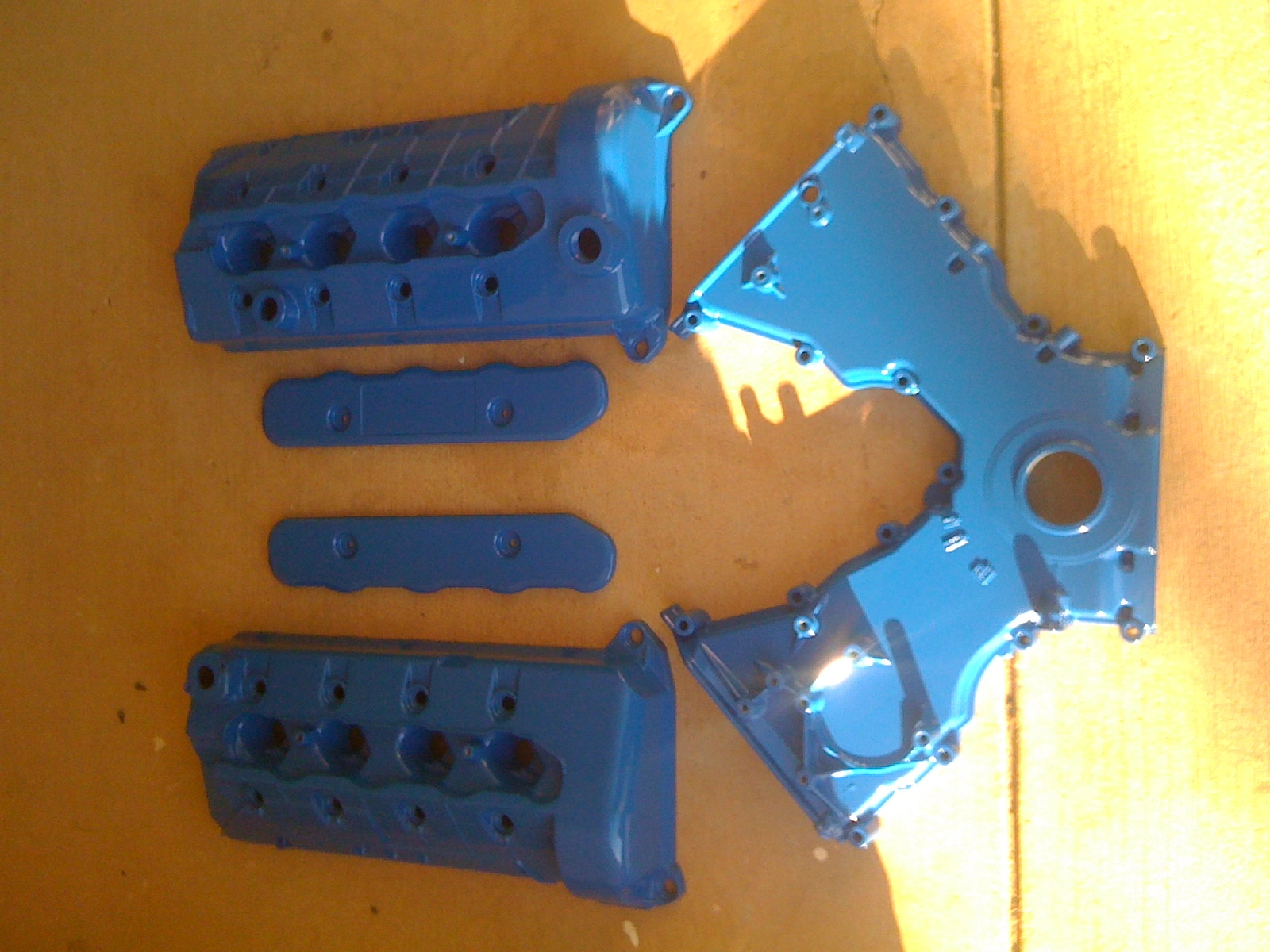

Just dropped off cam and timing covers at the powdercoating place yesterday...should have them back by end of next week :). They didn't have any wrinkle finish available, so I went with Signal Blue.
...couple pictures...

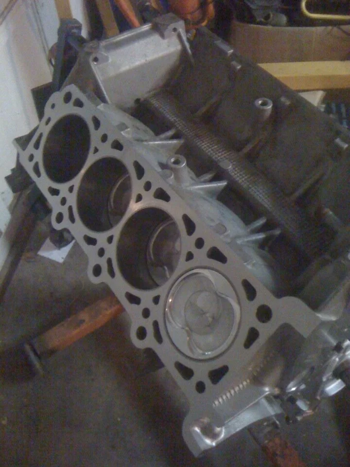

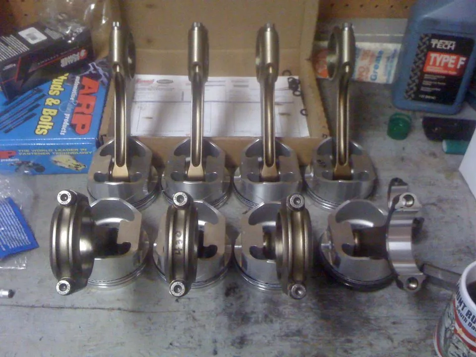

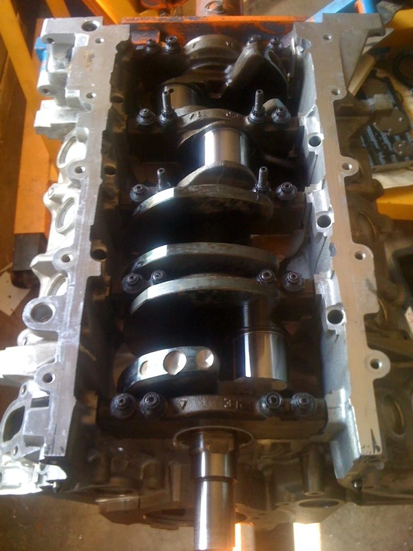

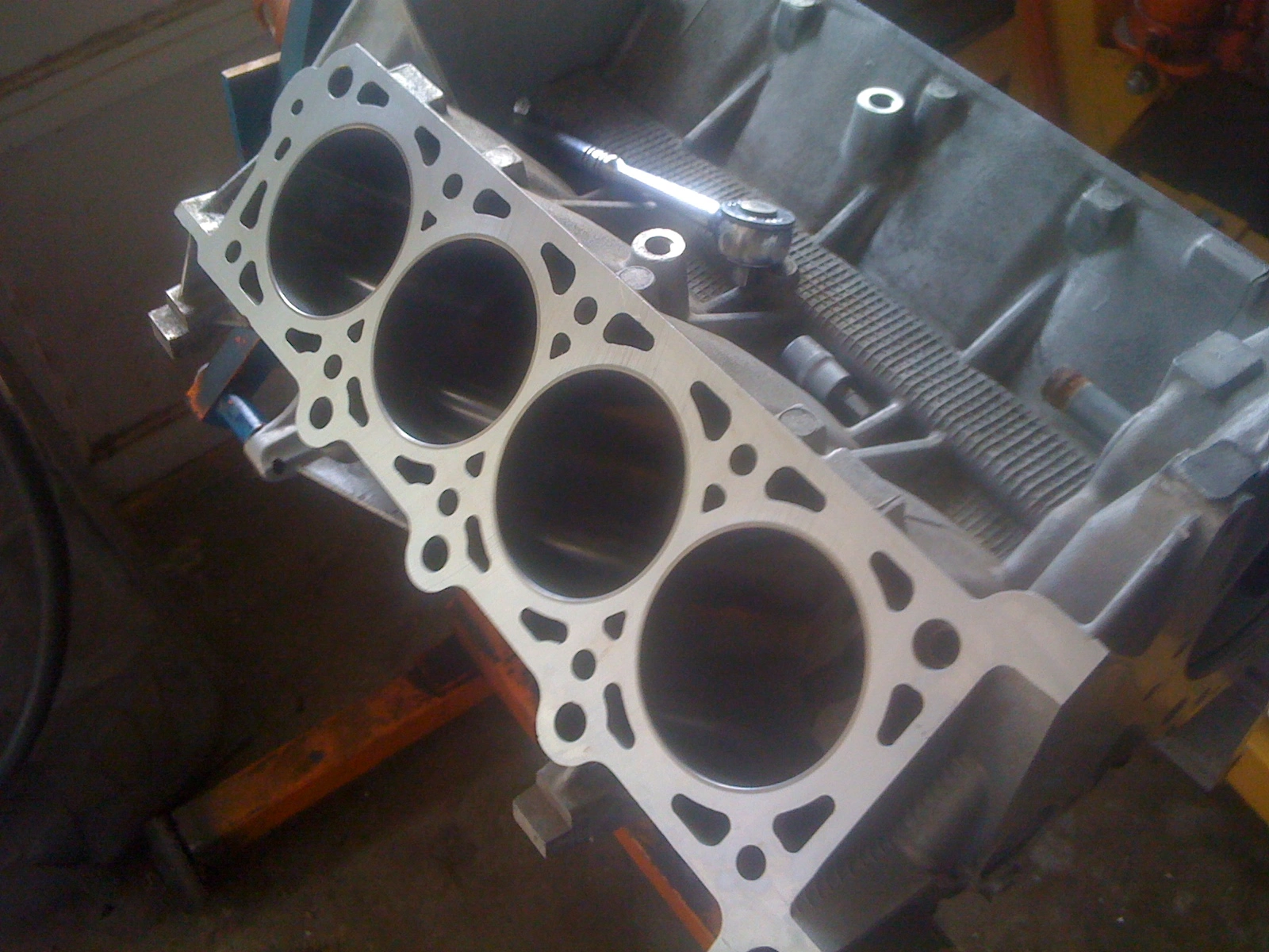

This is from earlier today. After talking to Rick, I pulled them back apart and relubed the pins since the engine will likely sit for a few months before actually being fired up. So far, I have two sets of rings filed and installed on the pistons. Depending how awake I am, I might burn some midnight oil and get the rest of them knocked out tonite.
55lb-ft on the rods with ARP lube, 0.021" top ring, 0.025" second ring...everything rotates nice and smooth. I just need to police up some miscellaneous fasteners and guide pins. I bought all the big parts piecemeal as opposed to buying a complete engine, so I gotta find all the hardware...grrr
I should be able to source most of it locally, but it's still frustrating to have to stop progress on the engine because of a lack of fasteners. Rest assured, if I need some pieces parts I can't find, you'll be the first person I contact.
