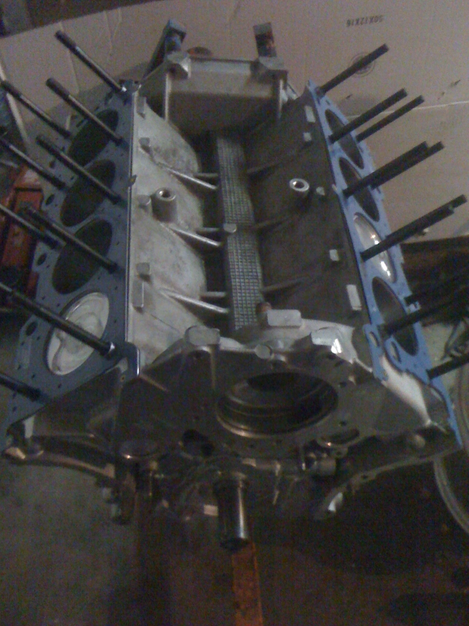

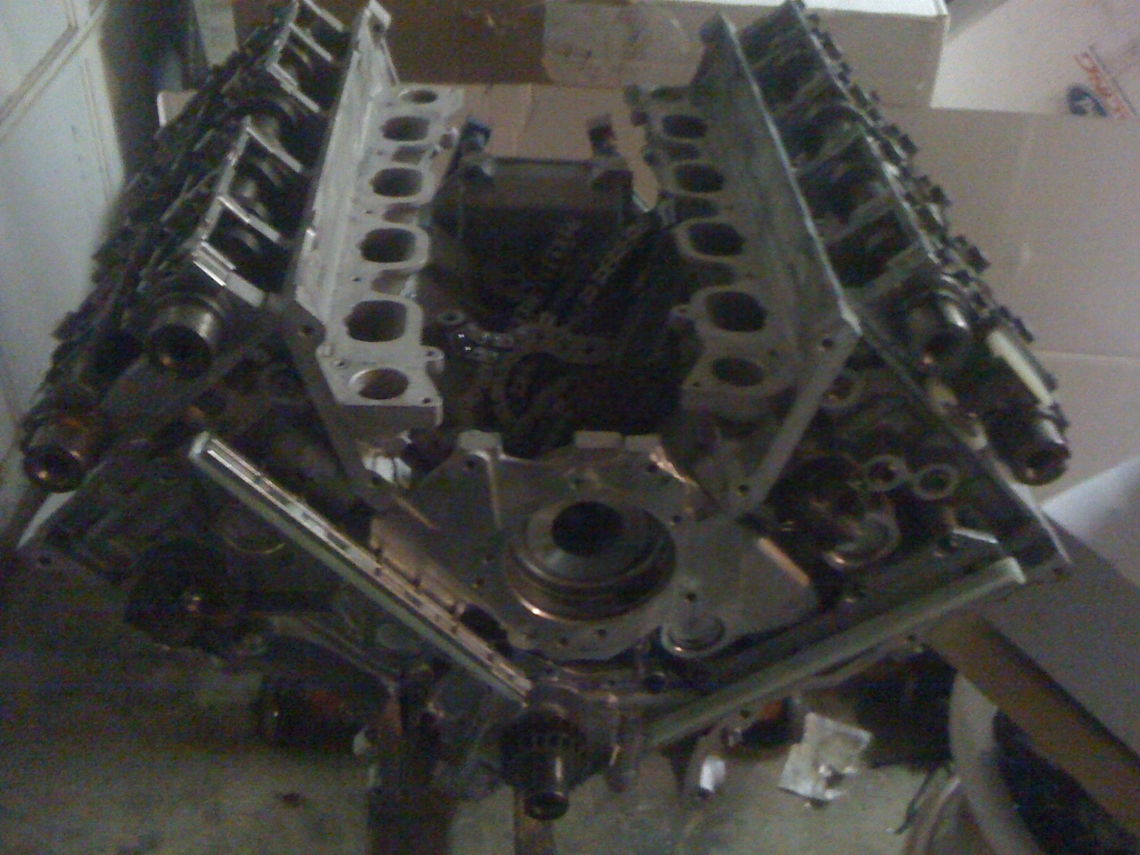

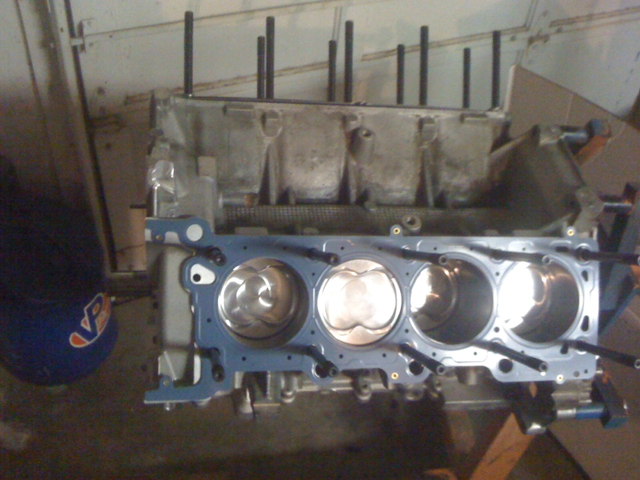

...couple new pictures. Funny thing I noticed. I bought these believing they were '99-'01 Cobra heads, and I'm usually not too suspicious of this sort of thing, but I found a part number on the right side intake cam and wanted to bump it with a chart I have...turns out, they're Continental cams; from what I gather, they're the same as '03-'04 Cobra/Marauder/Aviator cams. Way to pull some wind out of my sails there. Anyone know of a set of either B cams or aftermarket cams I could get to liven up things a little without having to swap springs?
oops?? The stock 96-98 cobra cams do work well with a tuirbo... I have a set but I hesitant to unload them yet since I am unsure about these SHM cams I currently have....although if I pull them Ill probably just design a custom set. I replied to your email ;)
I don't blame you for that-MPS has a set on eBay I've been eyeballing all night-they're split up intakes and exhausts. I also looked at the SHM grind numbers when I went looking for turbo friendly bumpsticks last night-the duration numbers were kinda different from what I'd expect for turbo cams though. I thought most turbo cams ran a reverse split pattern...but, I know next to nothing about cams when turbocharging is involved-especially with a mod.

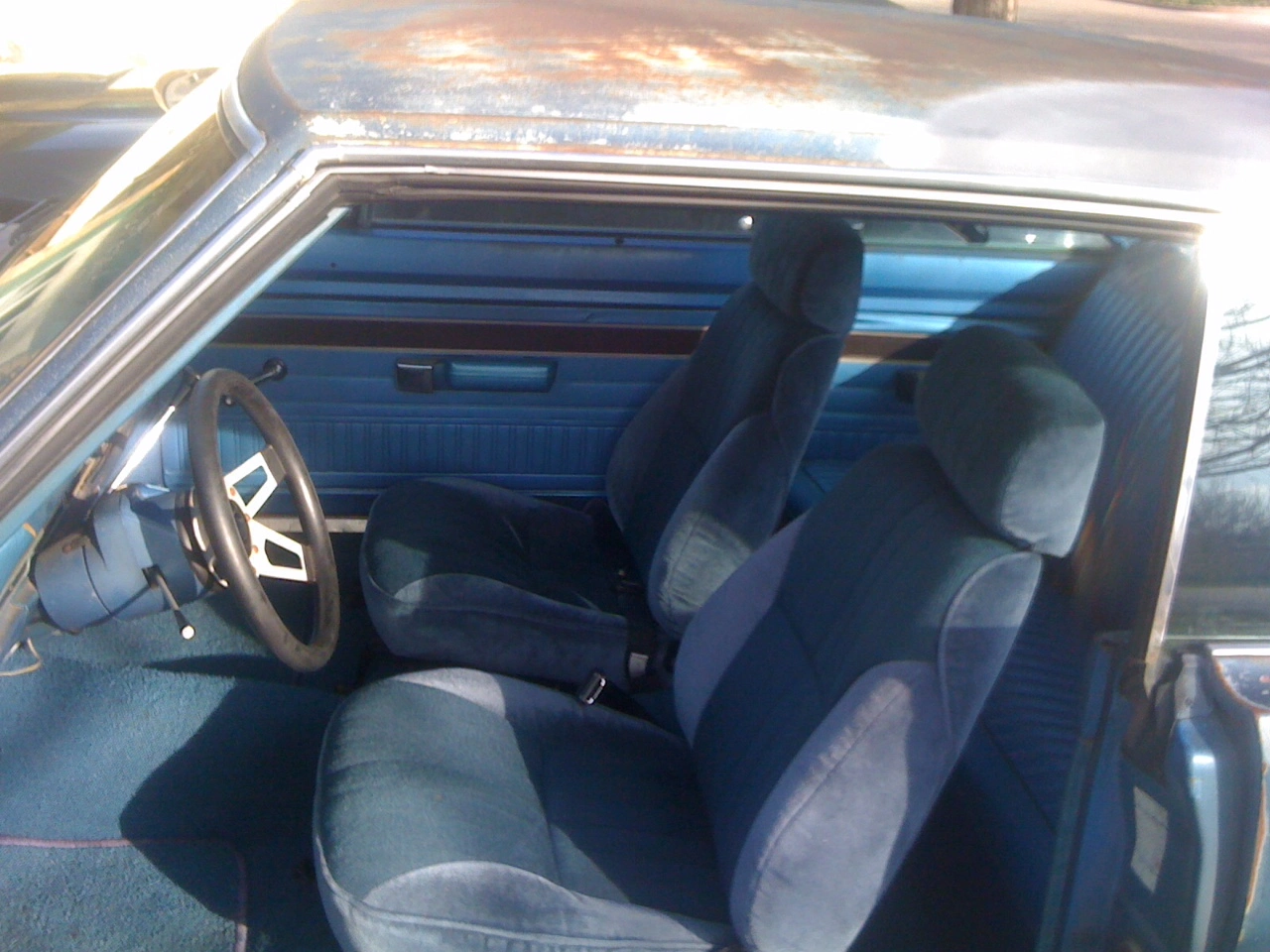

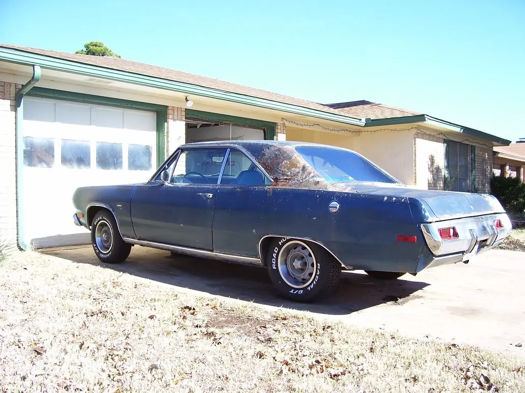

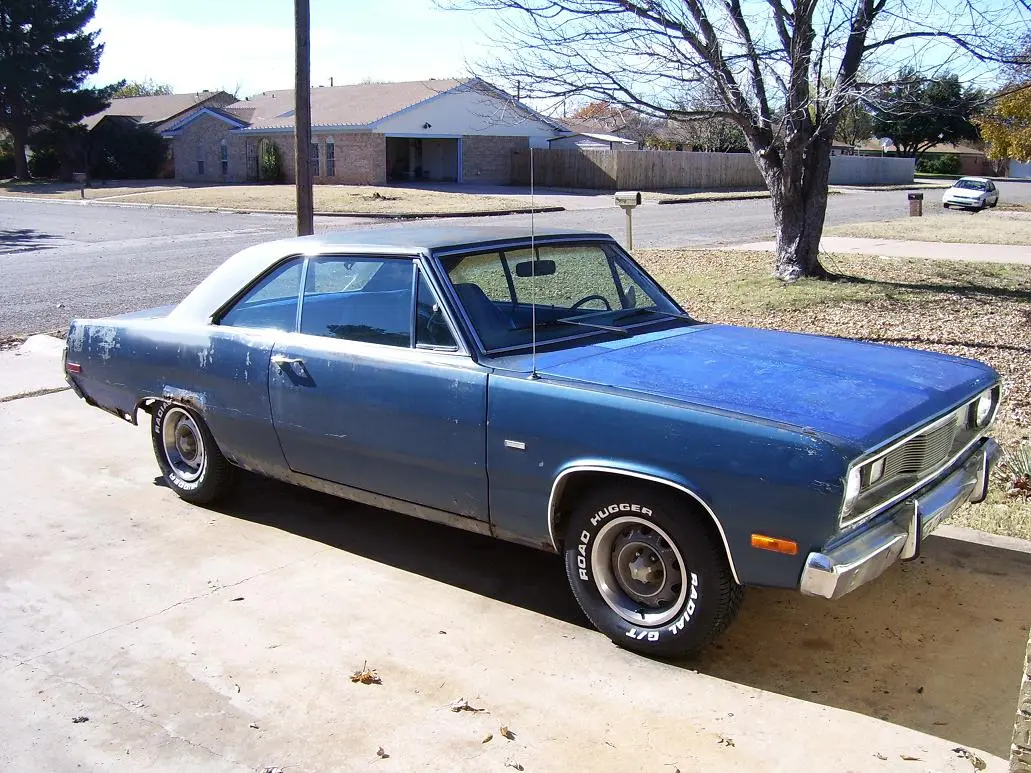

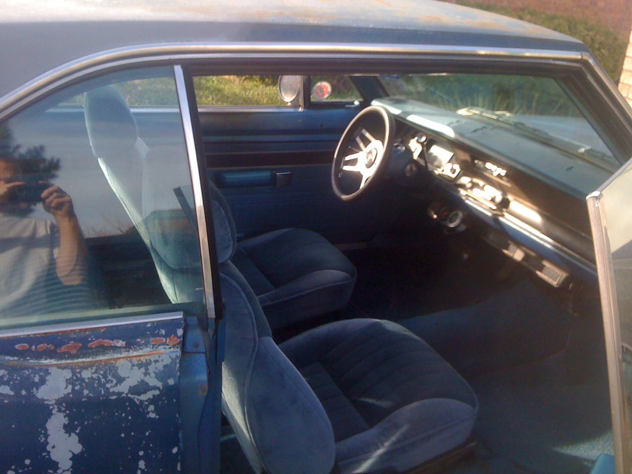

Here's a couple pictures of my poor beat up old mopar...
Reactions: 2vNotch
Thanks! I hope it turns out well. Unless I find time and a body guy, it'll still be half-primered by the time the engine does finally go in, but I have to fix a couple issues with past body cancer (little ones, but still need a good fix). I agree wholeheartedly about the lack of bore spacing in the modulars, but there are tons of folks making great power with them and relatively cheap parts are still very available.
Heck man, I love it! It'll actually be kind of cool to have a modern engine in that car in the condition it's in. I'd be half-tempted to leave it as-is, but some of that cancer does look pretty far along...
Oh-the reference to small bits of cancer was about my Mustang-I have to patch the roof where it meets the hatch; no idea how that part was rusted through and nothing else was.:shrug:
The Scamp OTOH...yeah, it needs a bunch of bodywork. I have a quarter panel from a parts car coming in from Florida in a while, and I'll probably buy a new trunk floor and the trunk drop panels whenever I get the quarter cut out..might have to cut out a section of the driver's quarter too-dunno yet. What you see in the picture of the driver's side is a poor attempt at a fiberglass repair (thanks Dad) that was never worked aside from laying down the glass and rotted in the Houston elements. I took all that crap off and the amount of cancer underneath wasn't that bad...nothing that some grinding and rust cure wouldn't fix. The passenger side though...man that side was downright ugly. The body joint was/is completely gone. I welded in some small patch/joiner panels, but they are in no way intended as anything more than a temporary restoration of unibody integrity. Which is why I hope the guy who's cutting up his parts car gives me all I need to fix it, otherwise I'll be doing some fabbing. The door skin and the fender I can patch with junk yard cutouts...sawsall is your friend.
The only pix I have of my '84 are pretty old or really small (avatar)-I'll have to dig up a couple when I get off work. I need to get the Scamp fixed so I can roll the Mustang out and take a few up to date pix...
