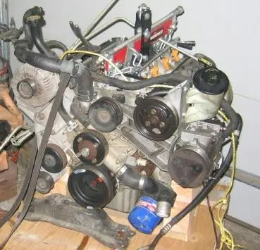

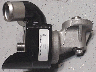

Seems like a cheap simple way to install an oil cooler and install the filter at a different angle.
I'd imagine you'd need two new lower radiator hoses as well, but looks like it would work out. Anyone try this? I know it uses a smaller filter than the fl-1a.

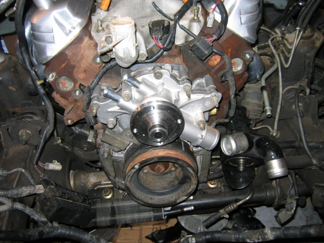

I used one on my car for a season or two. I came to the conclusion that it's better as an oil pre-heater than it is as a cooler ;)
It requires a different, and very hard to find, lower rad hose. I had to improvise. It might also need new o-rings, some of which are proprietary IMHO. Lastly, it needs a proprietary mounting bolt for the block, and the old one can be a real bugger to get out.
My oil temps are 20+ degrees cooler on track with the FRPP stacked-plate oil cooler hanging out in front of the condenser than they were with the explorer cooler IIRC.
