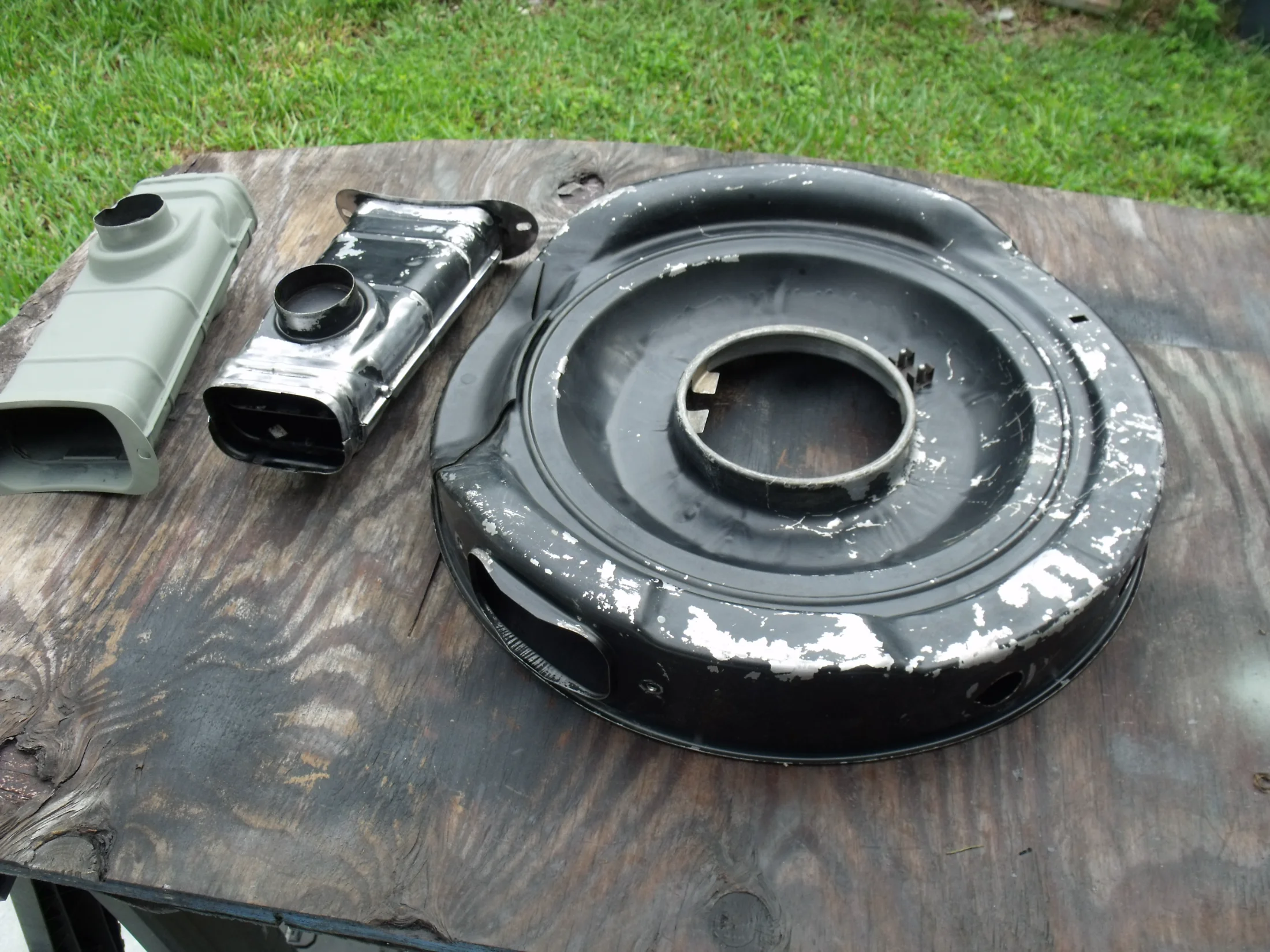

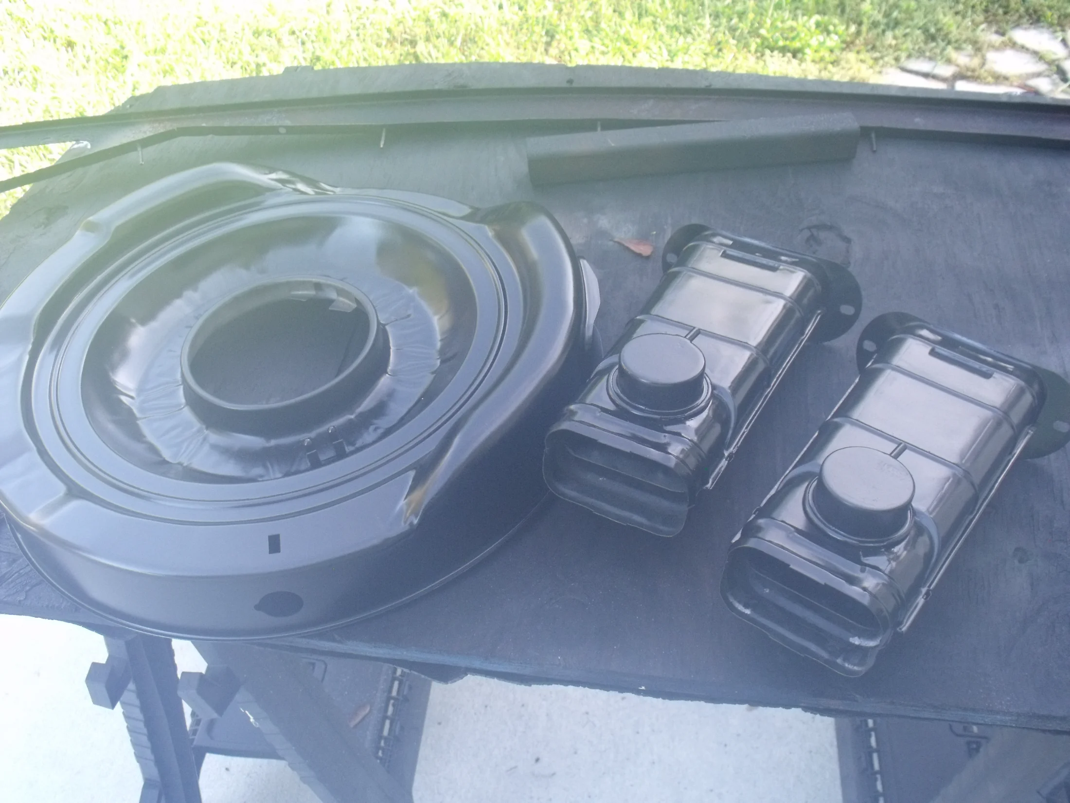

Some " restoration" pics of mine....
That looks nice, well worth the effort considering what those things are going for these days. I was lucky, I wanted to run one on my car and a buddy had one that he gave me.

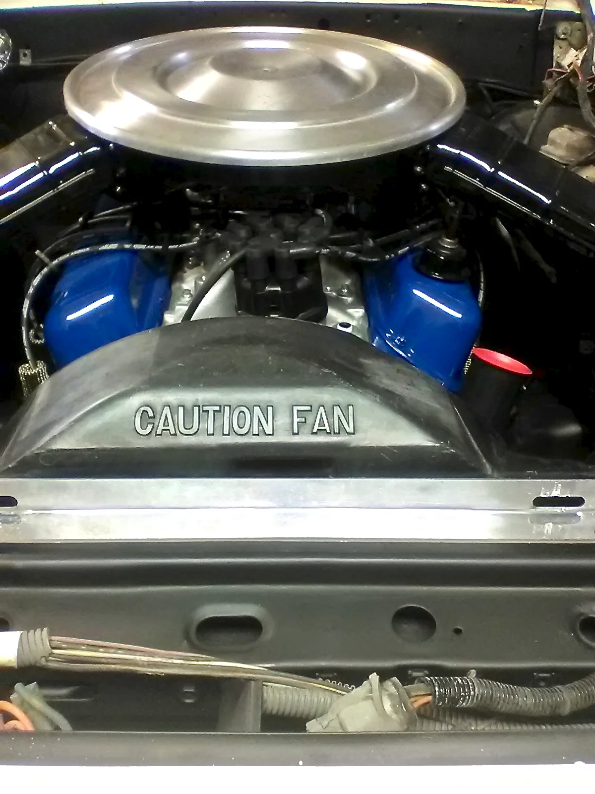

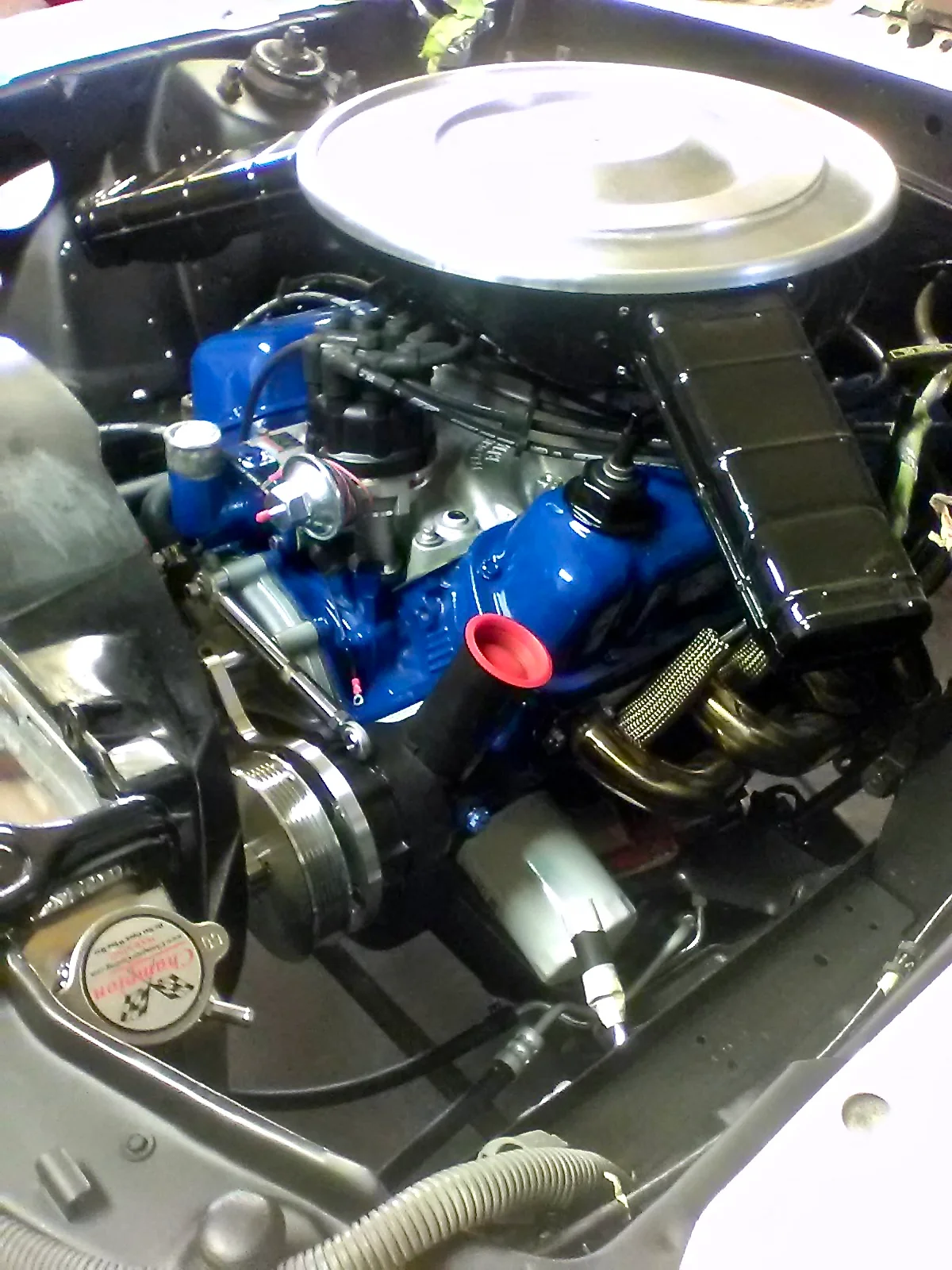

i looked into this a lot. car craft ran one on a mid 12 sec car. it gained a tenth over an open element. ford thought it was worth it and so do i. i'm sure it helps cool the whole intake system and gotta have a little ram air effect also. fits under the hood with the perf rpm, 600 holley and 1/4 inch thermal spacer no problem. not to mention it's less of a fire hazard and looks cool as hell. i took the the heat door plumbing off mine since it's a summertime car only
Reactions: 85GT4V

Details please.
drill the heads off rivets holding them on, cut some sheet metal pieces bigger than the holes, sand the attachment areas to bare metal. few tack welds to hold them in place. used regular jb weld as filler, let dry and sand them smooth.
