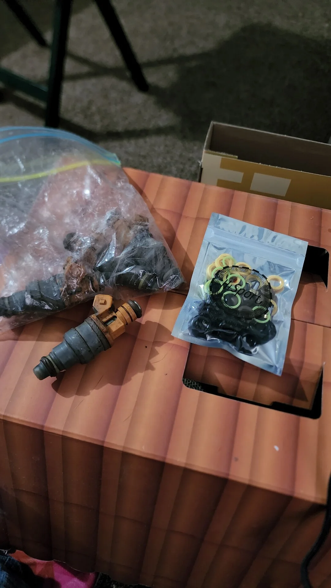

I bought these 5.0 injectors and was planning on putting them in my 2.3l today but im hesitant and need a push in either direction. I see some saying this will make the car run a little better, some say it'll slow it down and others that it'll fry my ecu. I've not got much done to the car except upgraded fuel pump, ignition and open exhaust. I don't mind wasting some fuel while I get more done but I don't want to risk damaging anything either.

Why would you need bigger injectors on a 2.3? Without some kind of tuning you will run very rich (assuming this is a NA 2.3).
If it is not running right, give it a full maintenance tune up.

Well I have replaced the entire ignition system, everything in the fuel system except the lines, injectors and pulse dampener, new cooling system, oil change, new tfi and ignition switch and timing is perfect. I figure the only thing that could still be wrong is one of the stock injectors are clogged or malfunctioning. Since I am going to eventually need the 19lbs I was just trying to avoid buying the stock injectors by putting these in now. I'm good with it running a bit rich for a couple months if it doesn't damage the ecu or anything else.
The first thing I read said they did it to theirs with no tune and it was a big improvement. After I bought them though I started reading more forums of other people saying differently. Idk what to believe.

there is no sense in going to bigger than stock injectors unless you are turbocharged and adding even more air to the engine
installing 19lb injectors into your stock 2.3L will just foul spark plugs, make it run like poo, drink gas, etc. Probably even have to replace the o2 after a bit, as it will become fouled with carbon from a rich mixture generated by the "bigger" injectors.
You're trying to fix a problem by creating another.

And I am planning on porting my intake and getting an upgraded head in the next month or 2 so figured I would need the 19lbs for that.
You can’t just throw 19# injectors into a 2.3. I believe the 2.3 uses high impedance injector drivers and it will damage the ECU trying to drive the low impedance 19#ers.

These 19s are high impedance as well. I did an ohm test yesterday to be sure.

You can buy a set of fuel injectors on ebay for your 2.3l for very minimal cost - ~$25 .
I did this on my own car which suffered from clogged fuel injectors after sitting for a long time.
What I would NOT do is add another variable into a car that isn't running well. I understand wanting to save money, but unless you are doing a full engine swap I would focus on having a running car before starting down the upgrade path.
