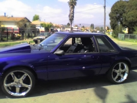

this is my first time posting. im having a couple issues with my car.
1. seems to backfire once in a while from somewhere around the engine bay, while on the gas at low rpms.
2. takes longer to start when engine is running or driven for over 30 minutes, cranks for a couple seconds then starts, but if i let go of the key while cranking and then try to start again it wont start. sometimes it seems as the starter cranks very slow as if it had lack of power.
3. and finally my coolant keeps dissapearing, might be because the resorvoir is cracked, but doesnt seem to leak, also the water always seem to be rusted i was told it could be the chrome stainless instead of a hose, so i flush the water fill it up and the about a day later its orange and starts dissapearing.
i would really appreciate any help anyone can bring and would like to give thanx in advance.
