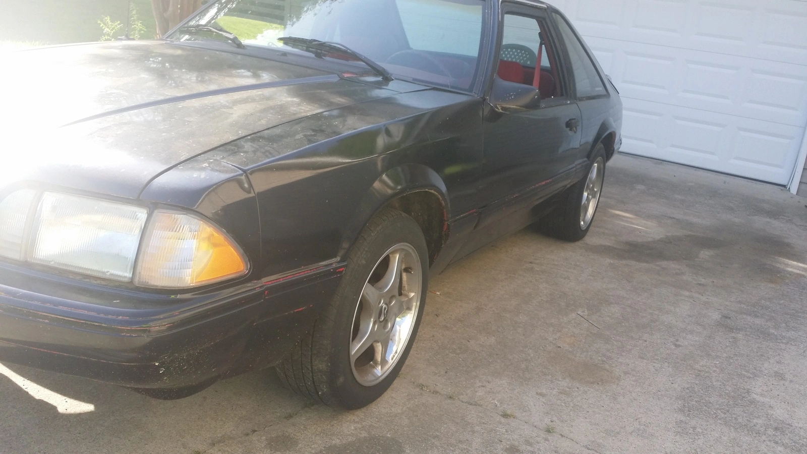

Hey hey..im kind of new to the mustang world so I'm looking for some advice/tips.
I have a 92 mustang...it came with the 2.3l engine...but I just picked up a 5.0 ho that I got in good condition. The guy I got it from pulled it from a Lincoln mark 7 which was his old car.
I know I still need the t5 5 speed transmission, torque converter, bell housing and wiring harness. Everything else is still there.
What else should I change out on it?
Any input is welcome. Thanks:flag:
