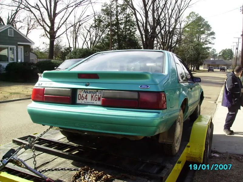

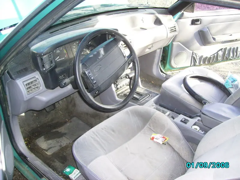

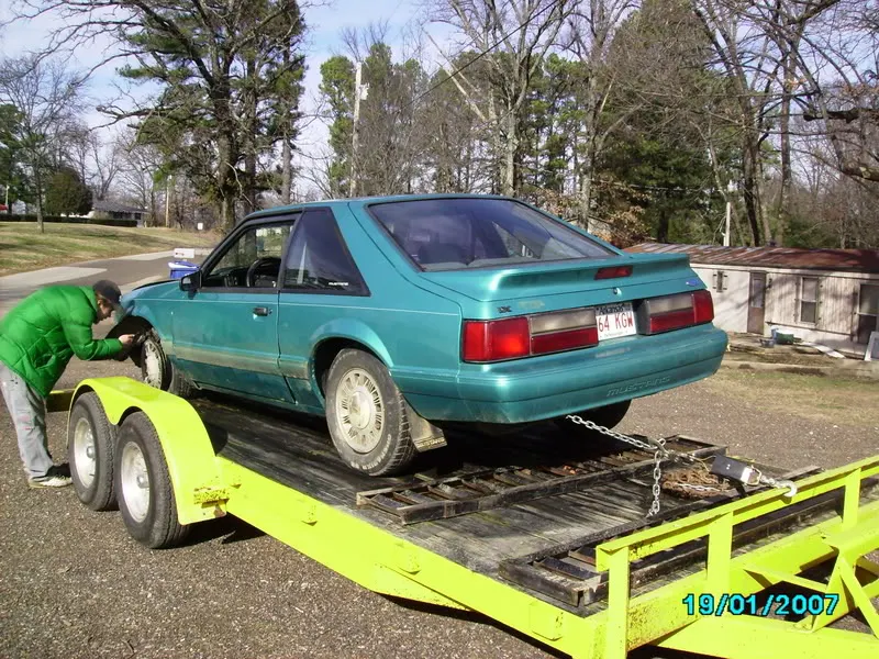

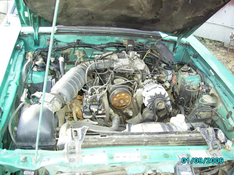

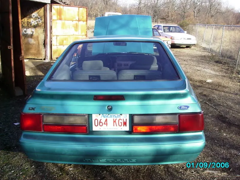

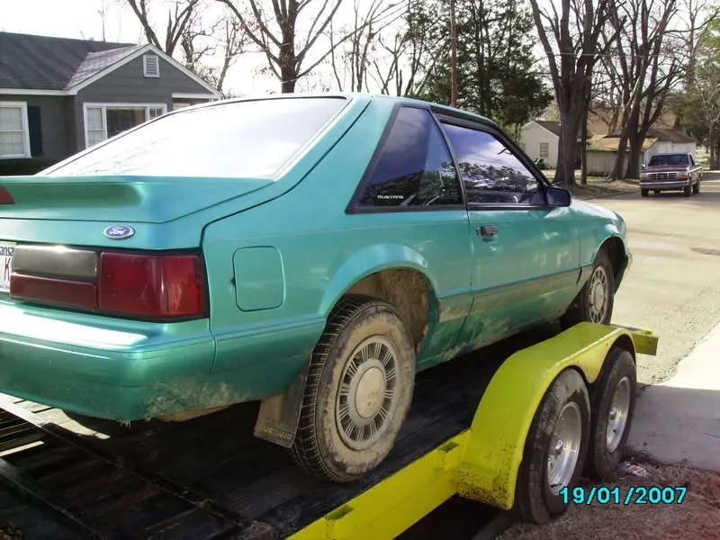

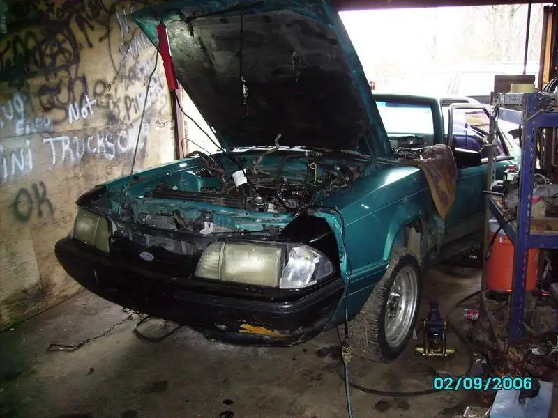

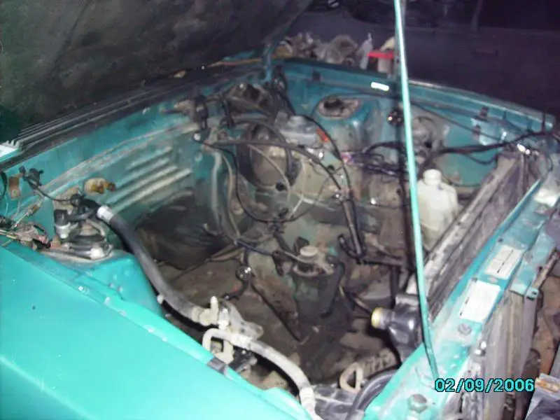

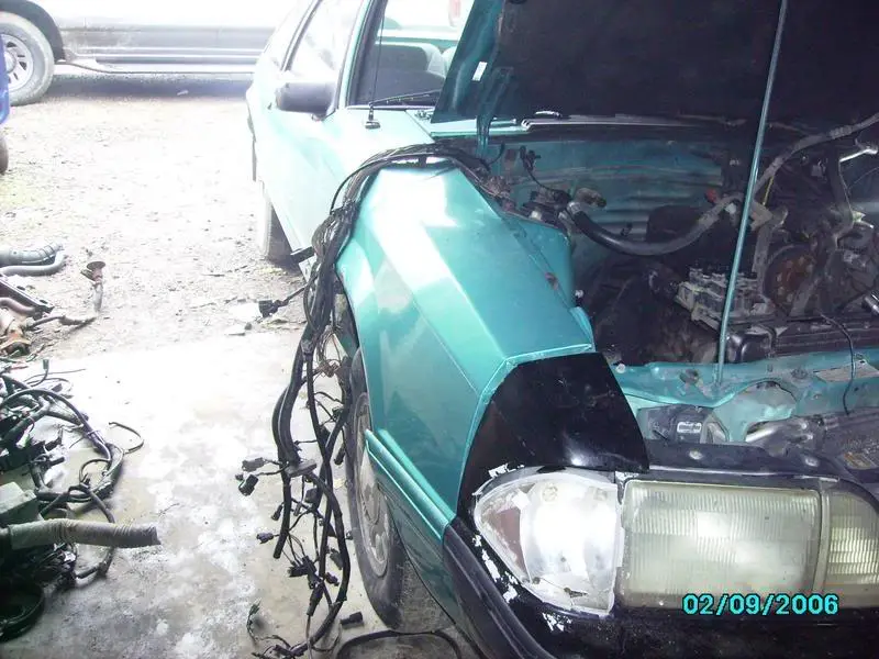

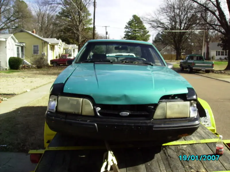

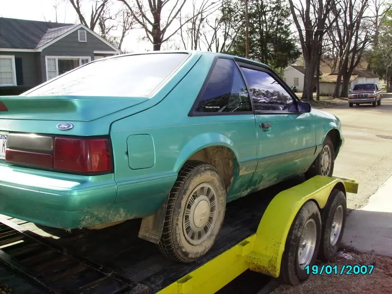

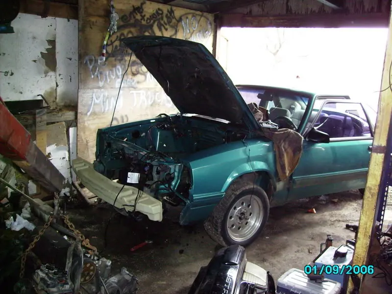

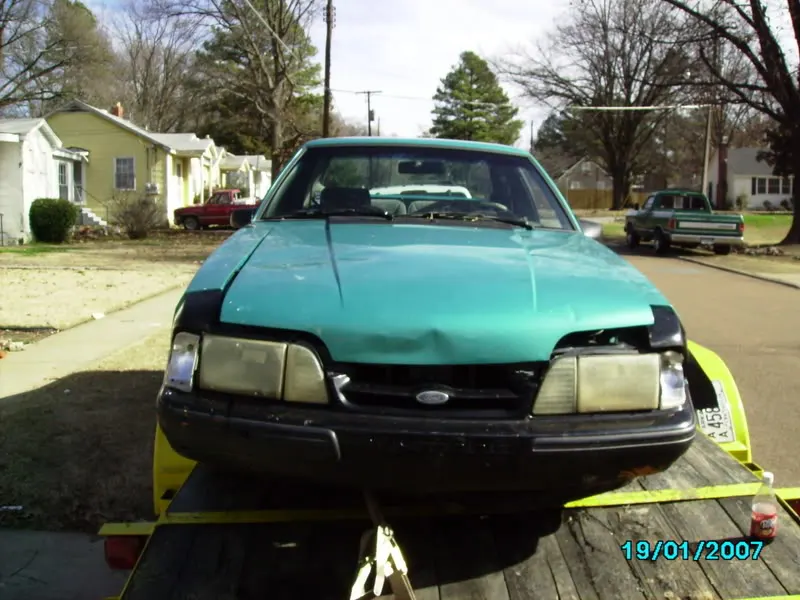

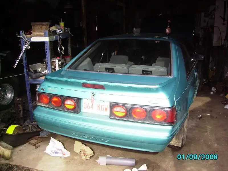

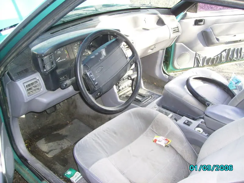

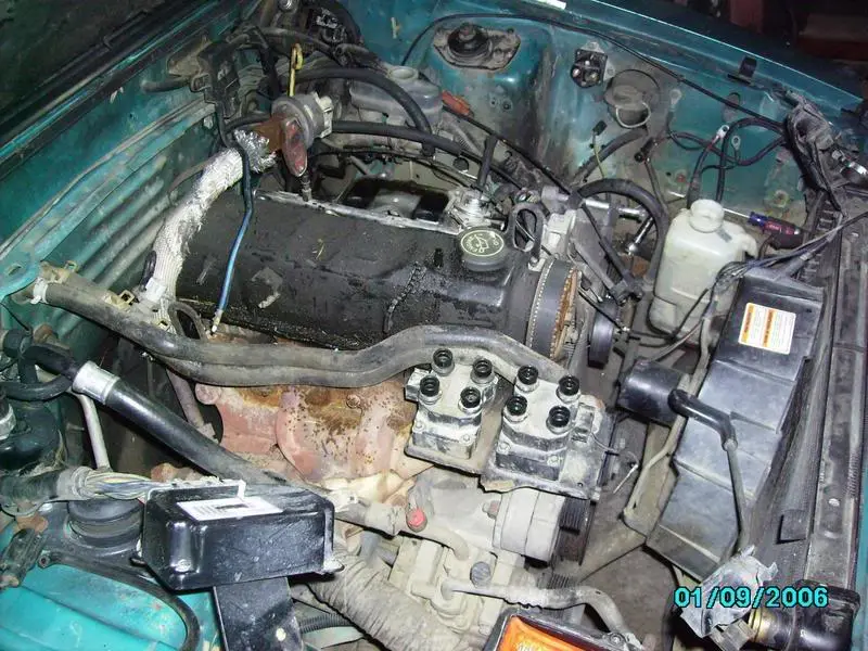

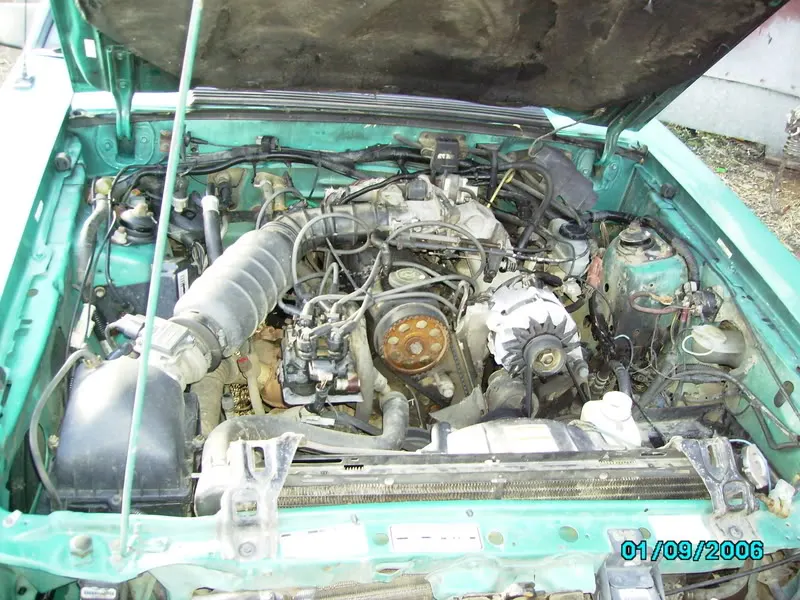

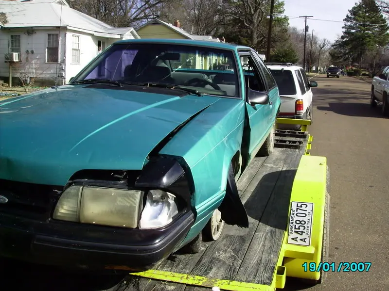

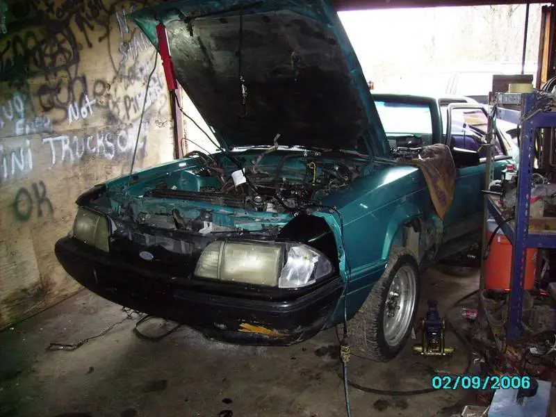

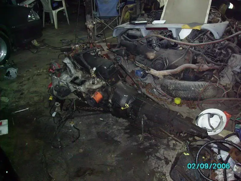

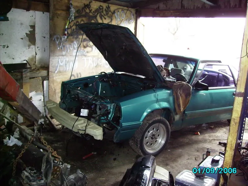

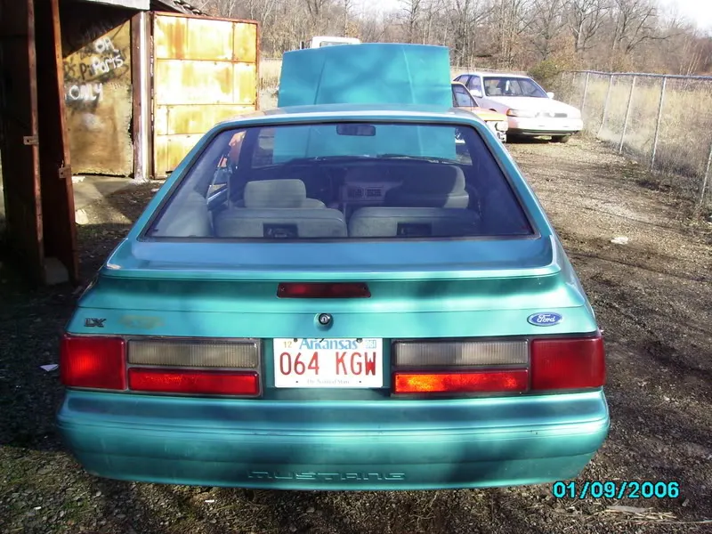

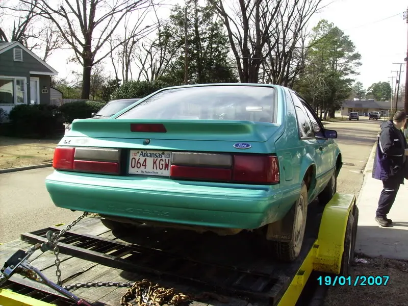

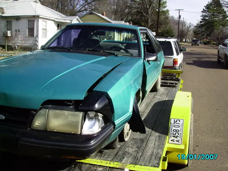

well i bought a 93 mustang lx hatch today with a great interior and besides needing a front cap its in great condition, down fall its a 4 cyl auto so as of tomorrow im starting the swap, iv got the motor trans pedals spindles rotors correct gauge pod. and the help of a friend that has done it a few times but i do have one thing im not sure of..... will a 87 motor harness work for the swap.... here are some pics of the car ohh and by the way it was only 200 for it

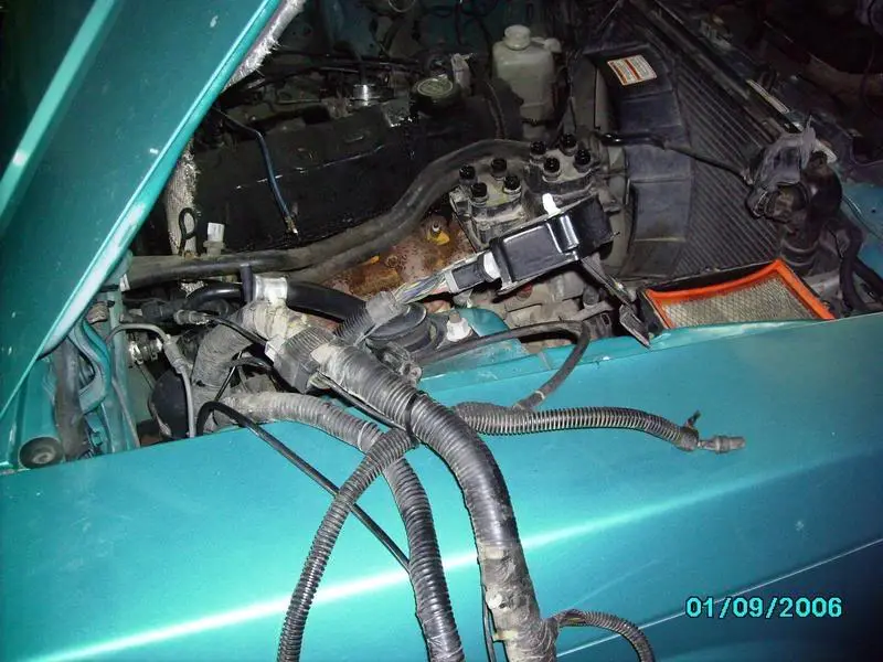

87 harness will work. YOu just won't have Mass air, unless your old car was converted before, but if the motor is gonna stay realtively stock, speed density does seem to make a few more HP.
Nice buy BTW, good luck with the swap!

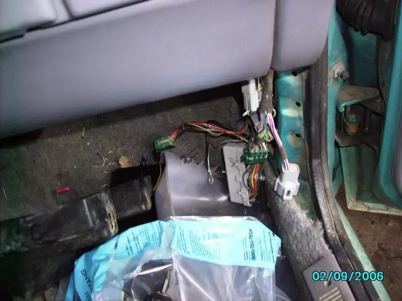

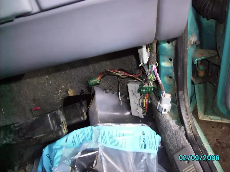

iv got a maf and the pigtails, and direction so if i can find the correct ecu it will be mass air. so ur certain the 2 ends on the motor harness will plug into the main harness and the green plug in the kickpanel will plug into the dash harness
dont have the money currently for that and have a feeling i would still have problems with other electrical items do u know what happened to the thread a couple years ago were the guy did a whole swap with pics and all

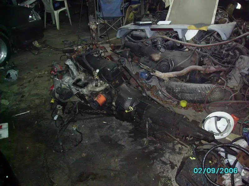

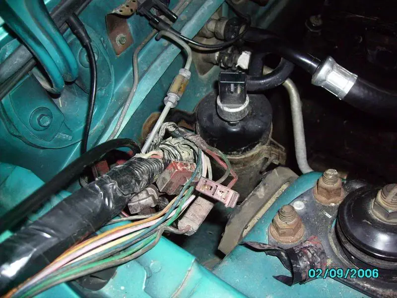

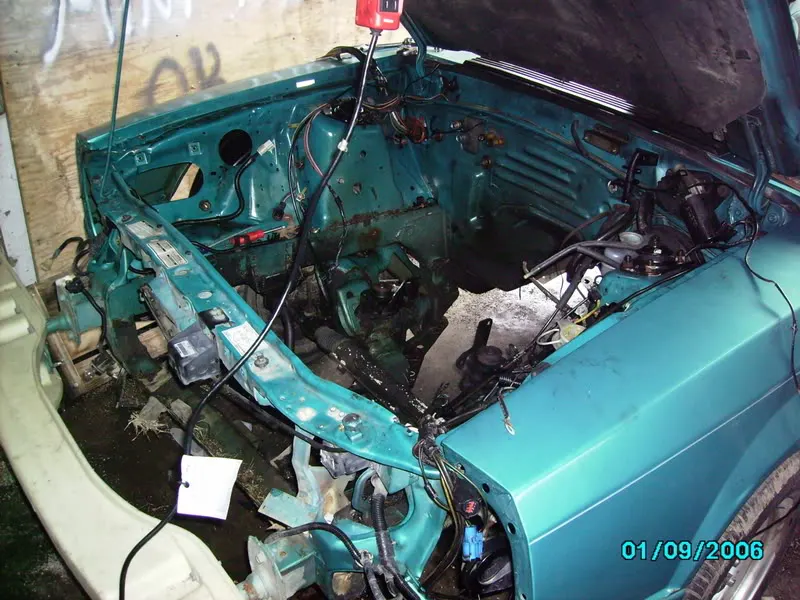

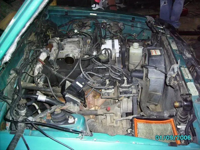

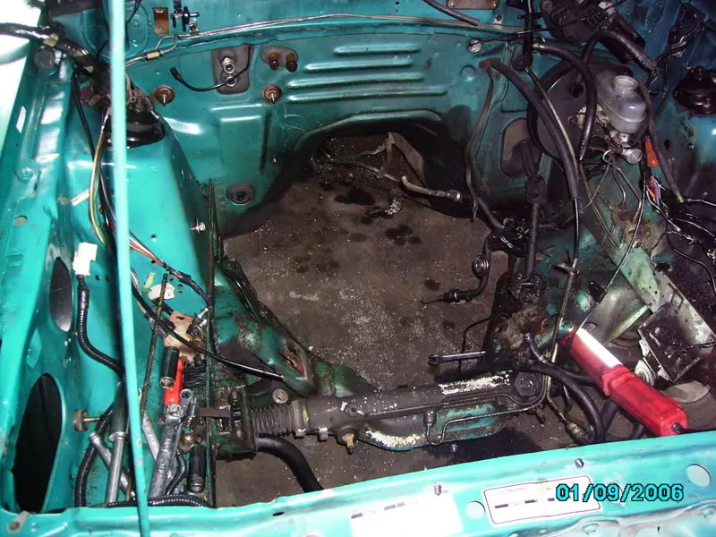

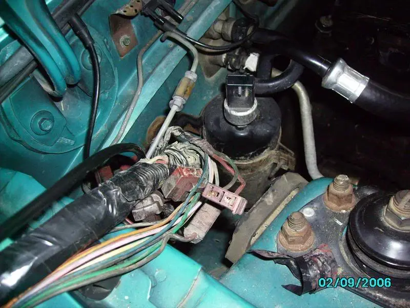

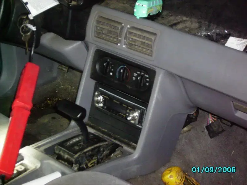

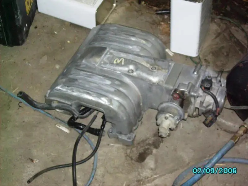

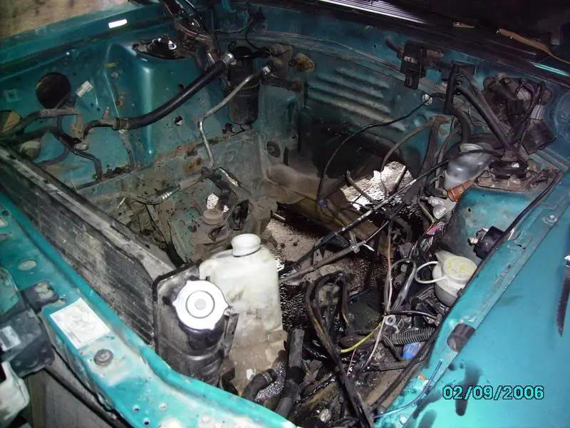

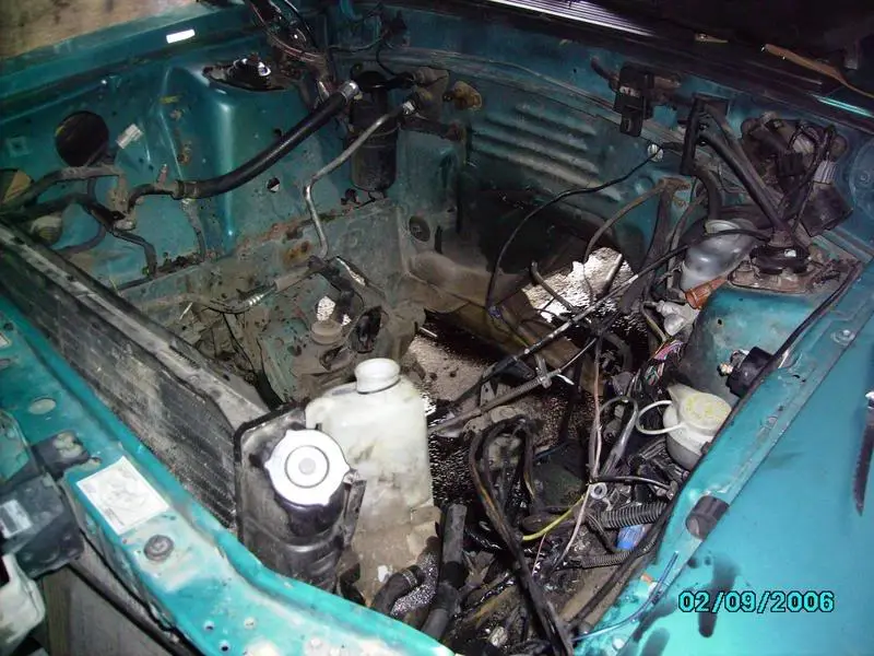

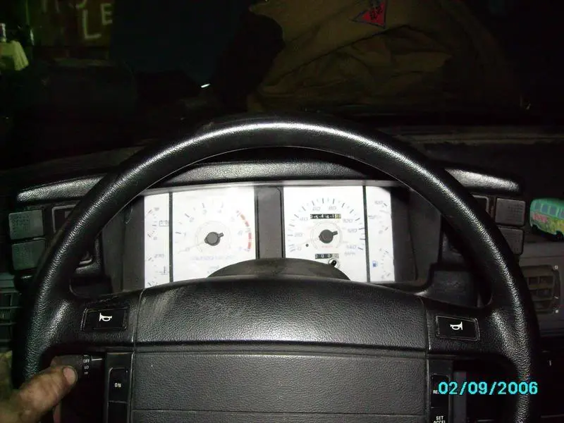

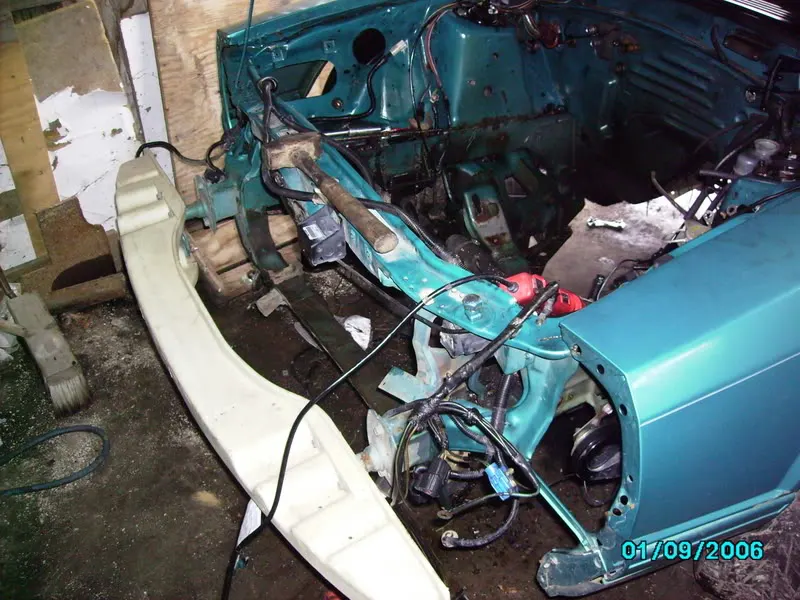

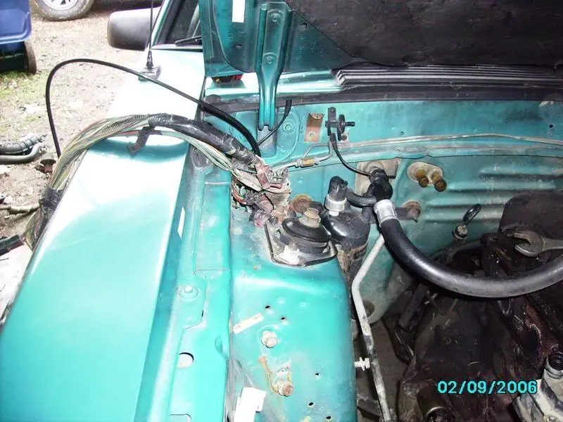

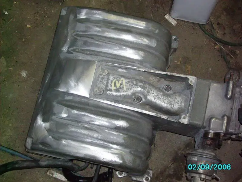

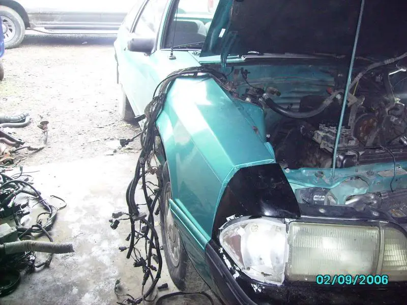

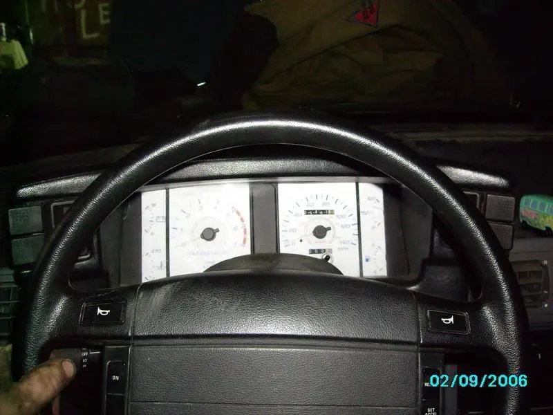

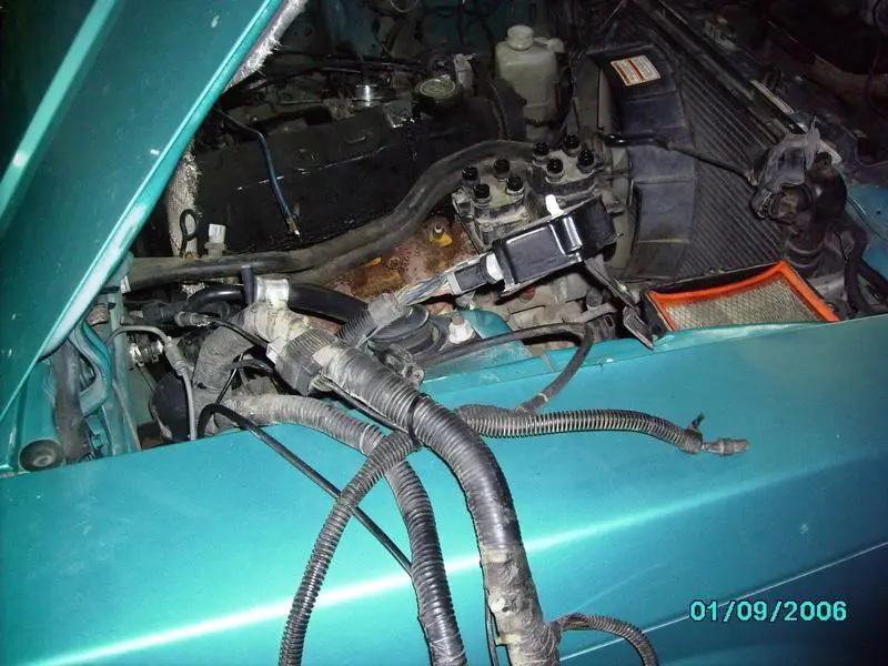

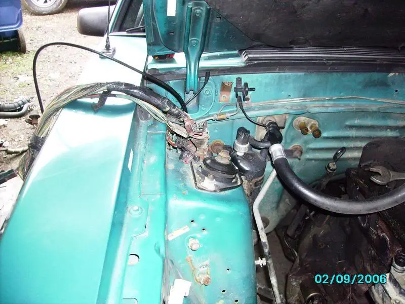

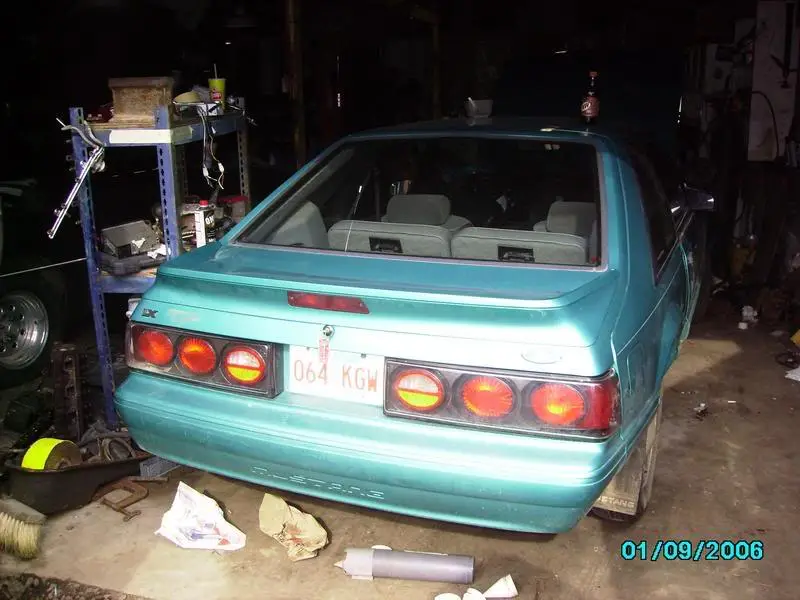

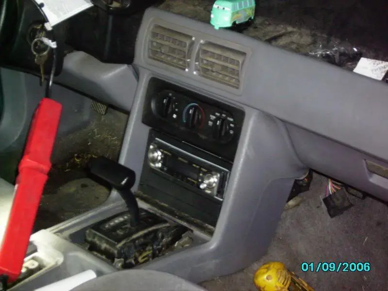

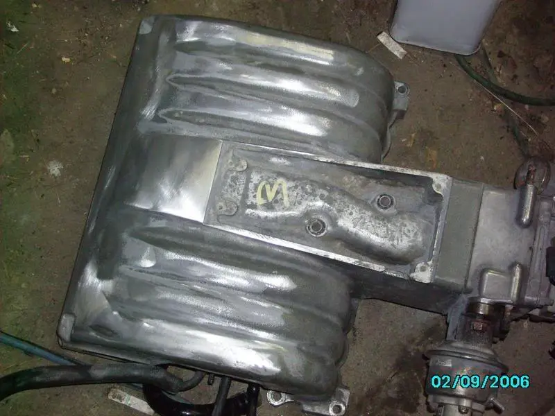

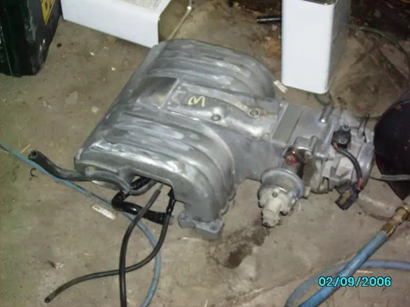

here is what i got done old harness out new one in motor pulled 140 speedo and the correct tach on went ahead and threw a set of white face on i got the wires under the hood that were damaged by the minor fire the car had due to its previous owner fixed also found out i have to replace the rack an pinion due to the fire melting the seal on the drivers side and a friend wanted to help so he swapped my tails and went ahead and put the radio filler in, also started polishing my intake

looks all too famliliar. From what I remember is the under dash wiring won't work from a 87-93. Don't remember why though. All my stuff was from a 89gt into my 88lx. good luck with everything. I got it done in about 3 days with a buddy of mine. (only because HOA didn't like a parted gt in the front driveway)

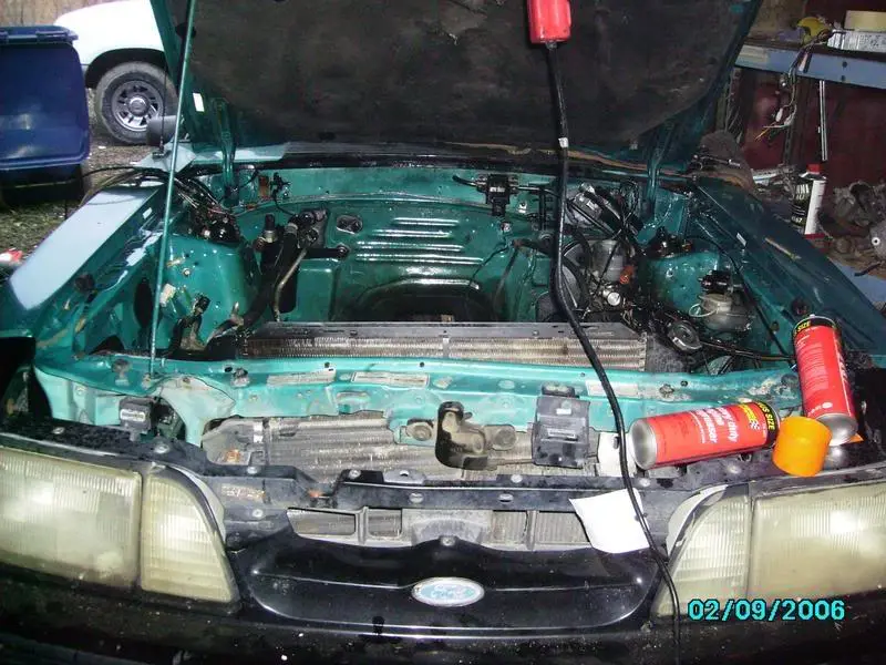

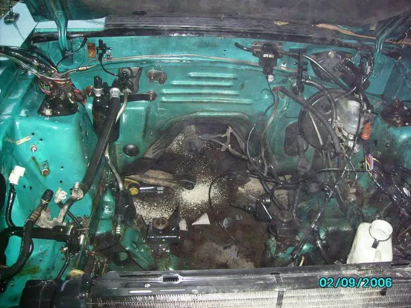

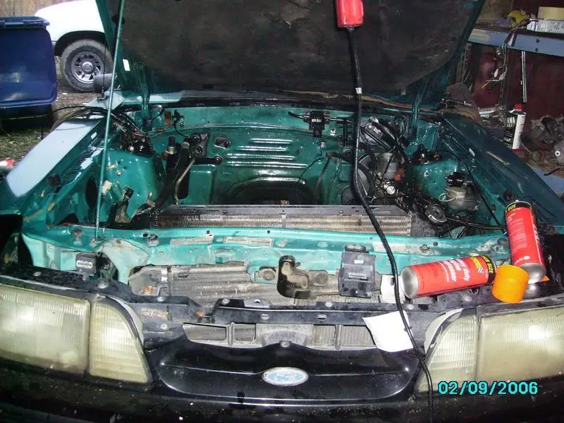

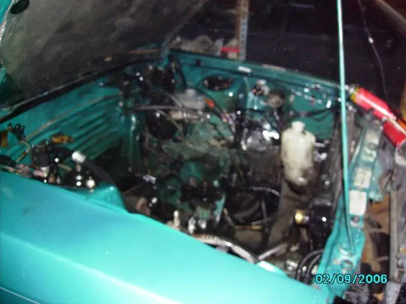

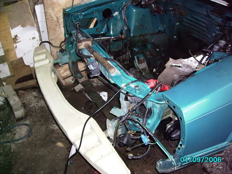

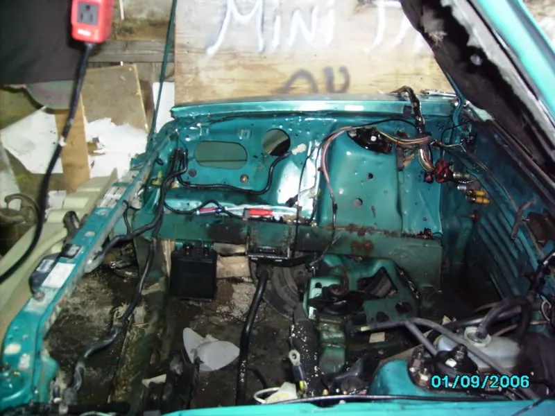

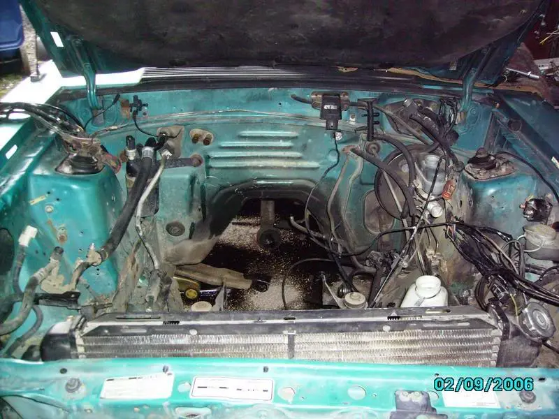

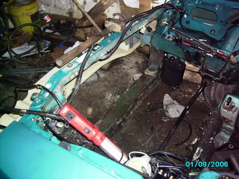

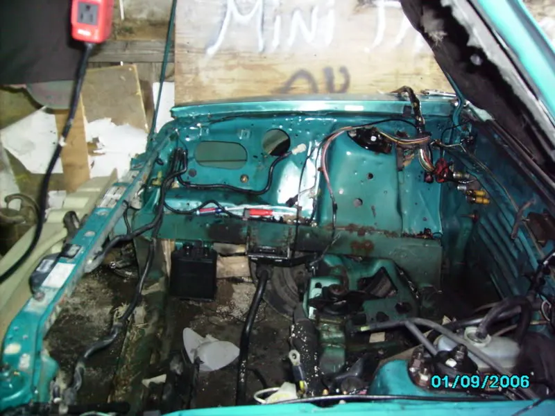

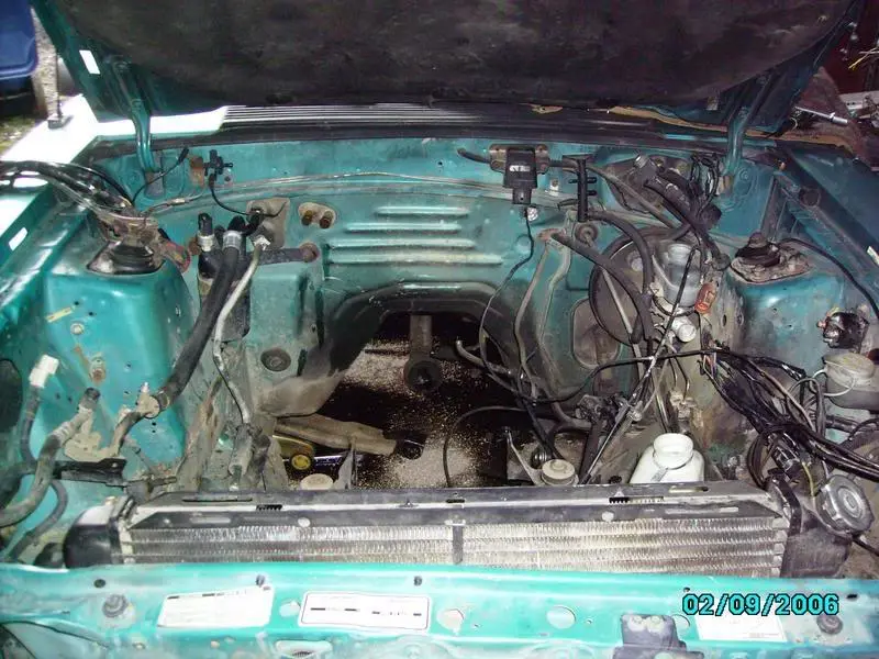

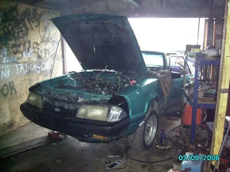

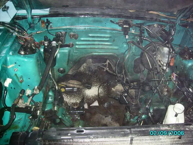

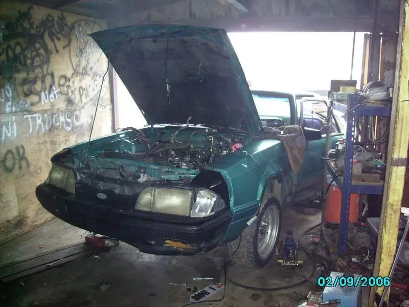

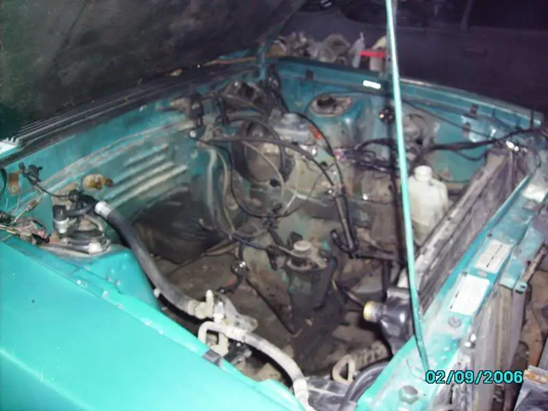

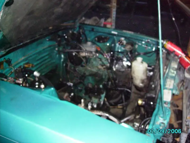

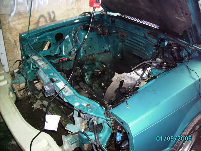

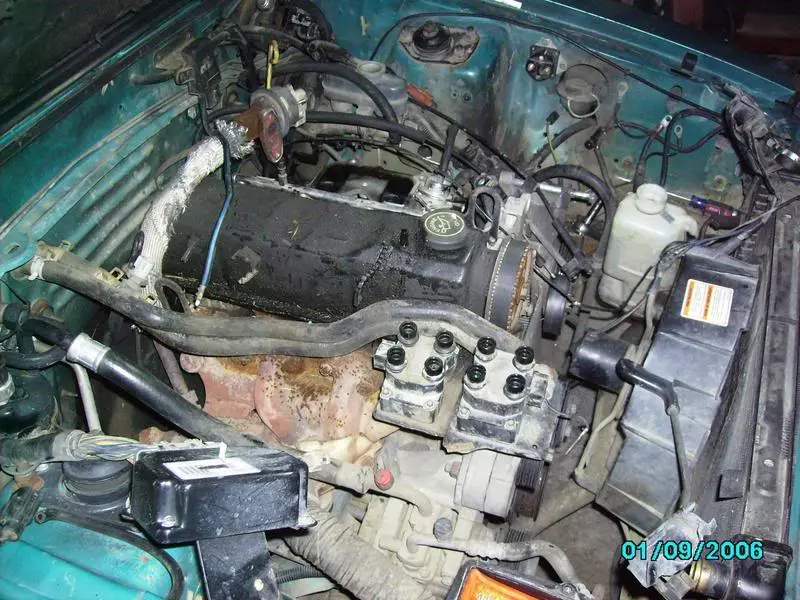

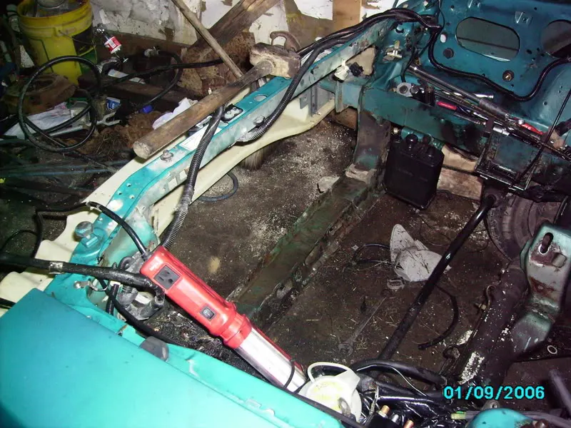

ok pics of the engine bay a lil cleaned up the radiator support bent back into place and the rack and pinion about to come out tomorrow i plan on sanding and cleaning the bay a lil more so i can give it a fresh coat also i went and picked up my clutch/ brake assembly gonna try to get it in tomorrow also took the front bumper off probaly gonna go get fender and new one on friday
here are some pics of a lil of the work u cant tell much has changed but it has been a lil sluggish the last couple of days
