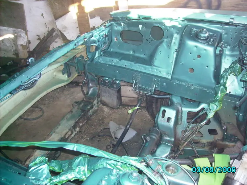

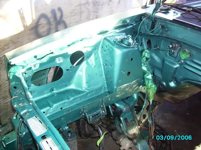

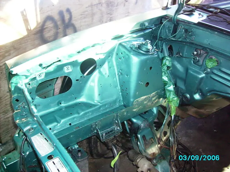

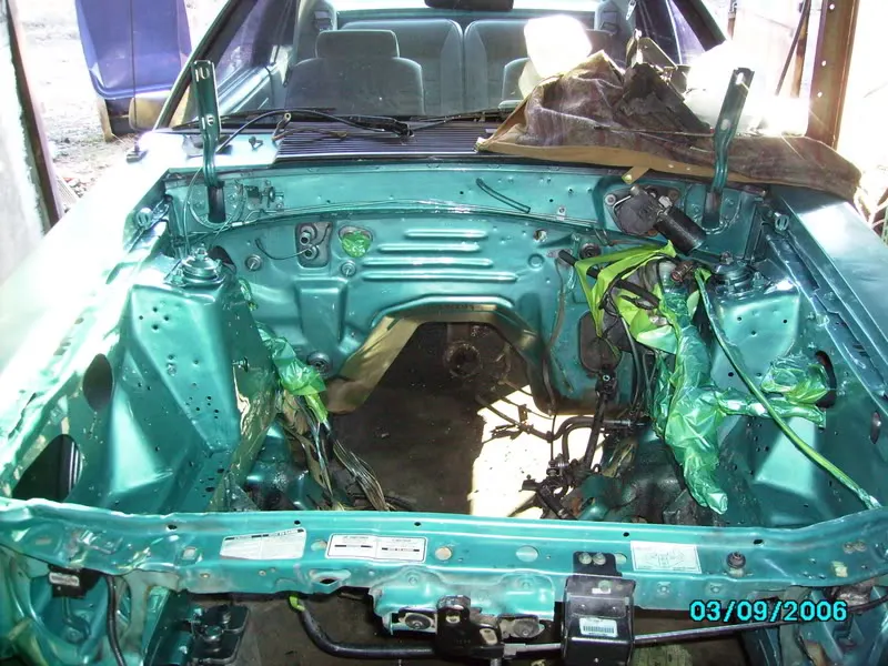

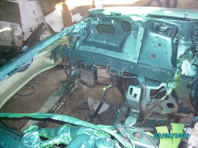

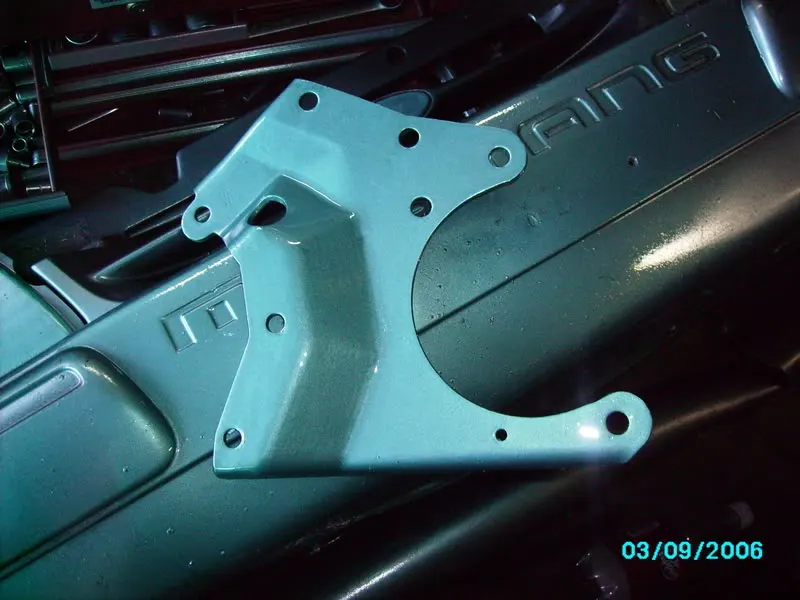

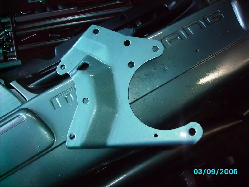

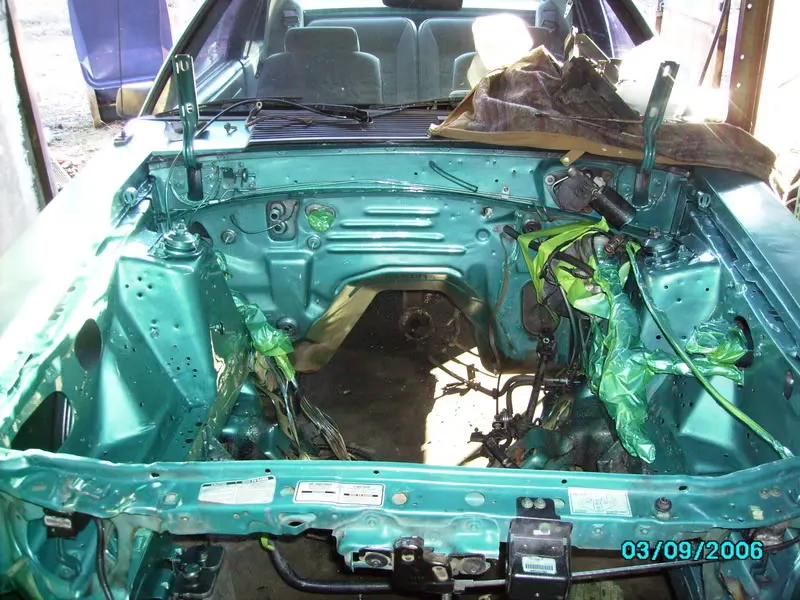

engine bay is painted here are the pics i also decided to paint the ac bracket the same color

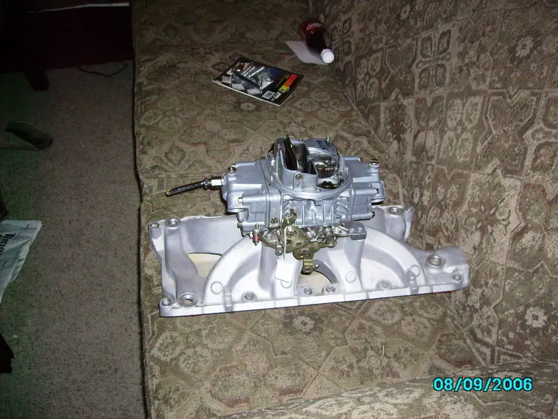

ok engine bay is done pedals are in(boy was that a pain) still have to get the rack and pinion done then im gonna set the motor in.... ill have pics tomorrow. and probaly gonna go with carb insted of efi so if anybody wants so efi stuff give me a pm

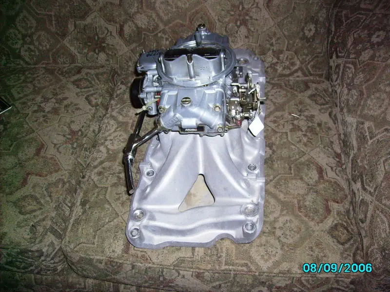

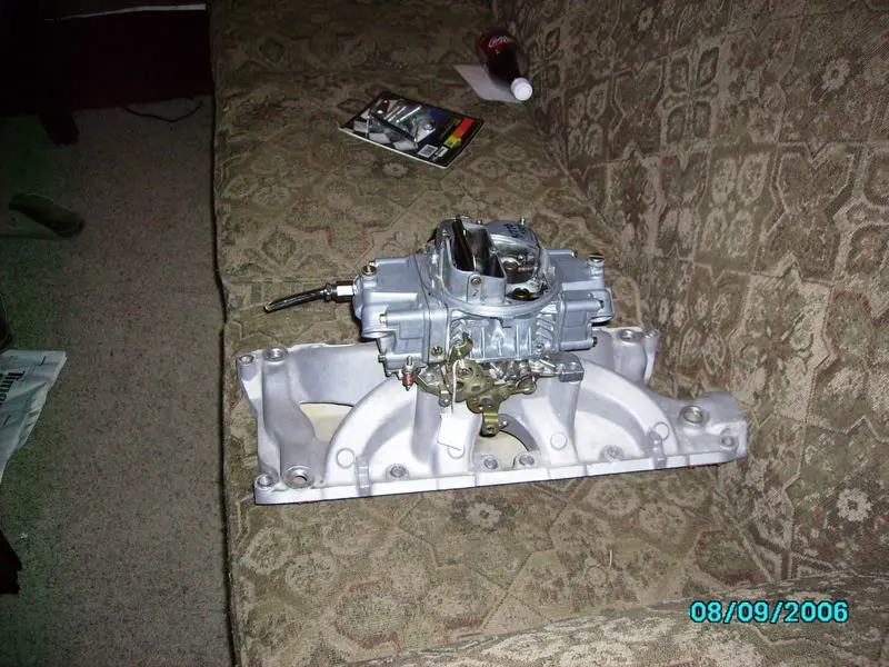

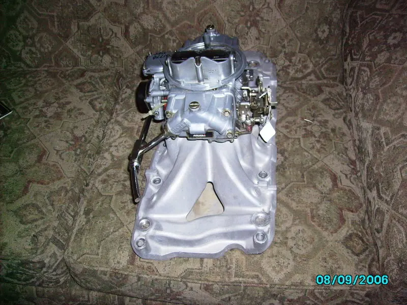

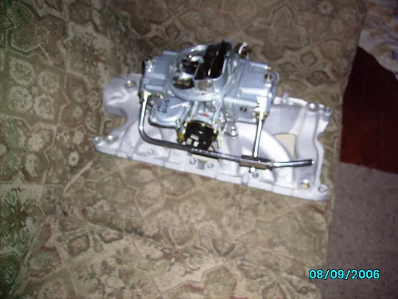

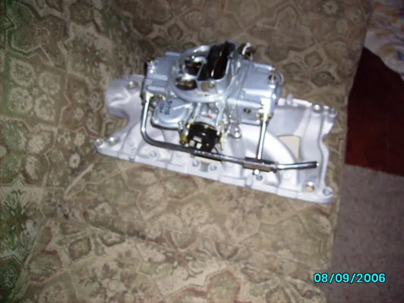

ok i got a couple of my goodies today..... 300 i got 750 holley with elec choke fuel line spring kit and intake well here she is

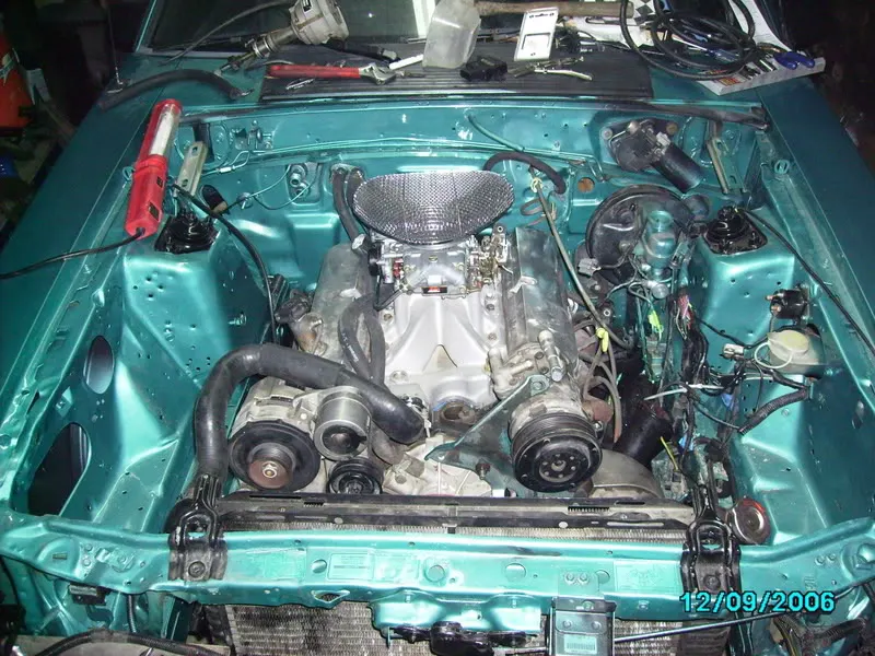

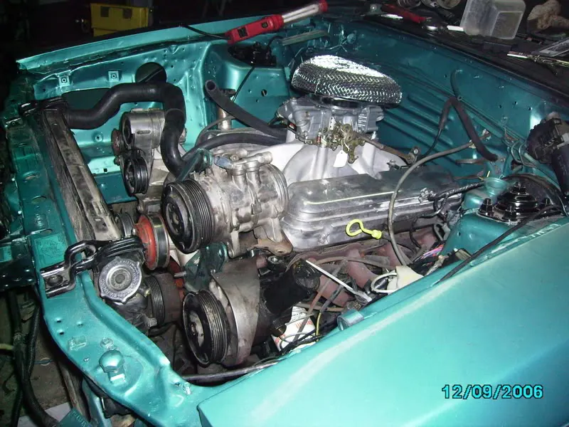

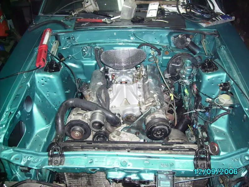

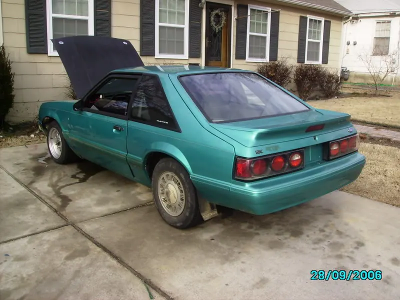

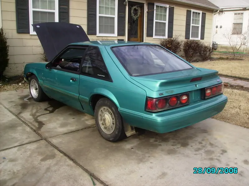

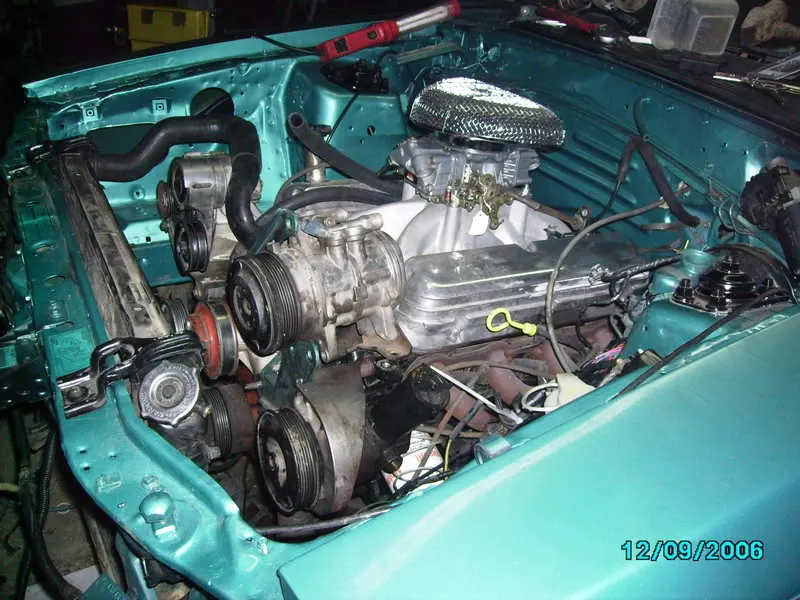

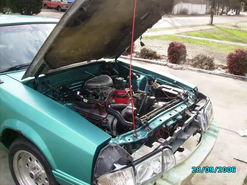

here is what i got done as of saturday iv done a lil more since then and thanks to the wiring diagram for the wells box i got off here i can crank the car tomorrow here the pics more to come
my 0.2 cents
1. those euro taillights need to go! :ban:
2. Clean up the overspray in the bay :nice:
3. Less progress you make me feel useless :bang:
looks good you have made more progress than me and i've had mine for almost 1 year.

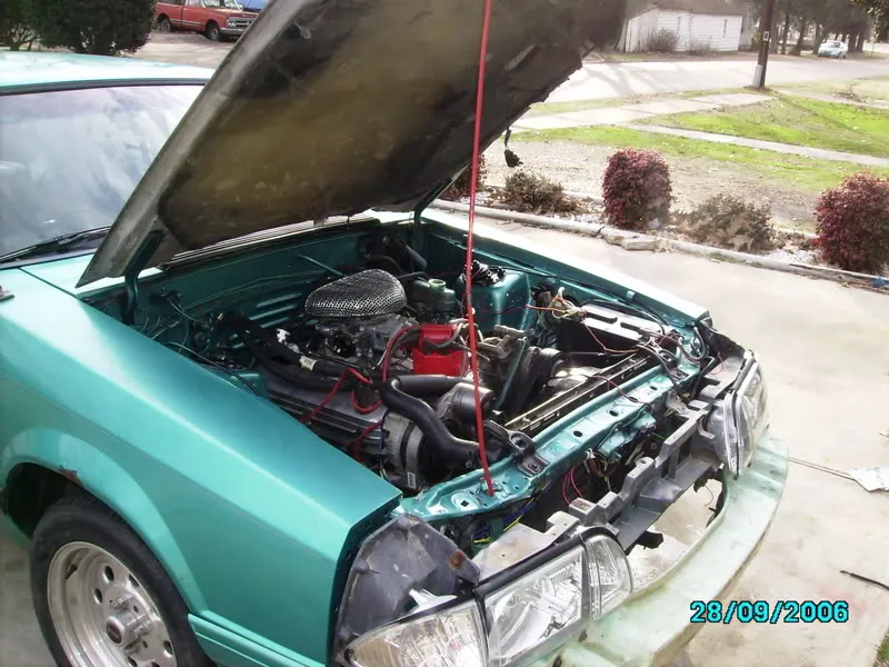

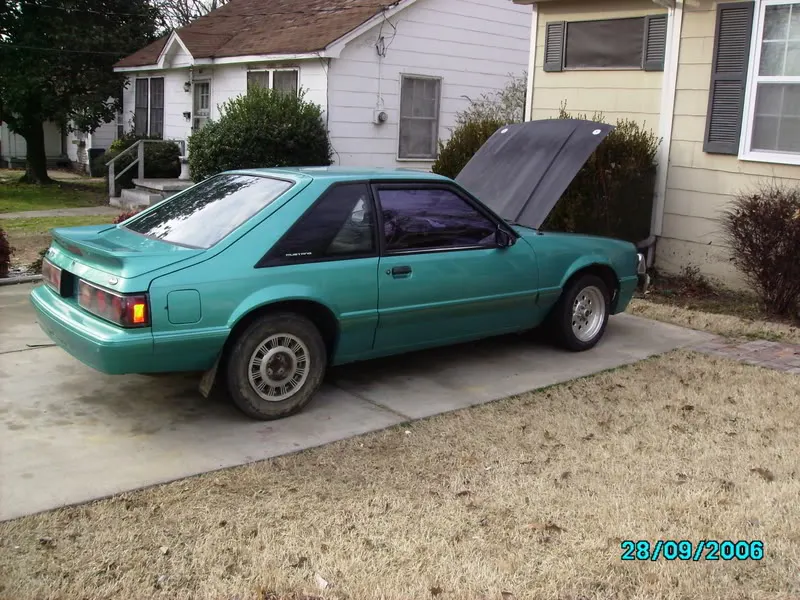

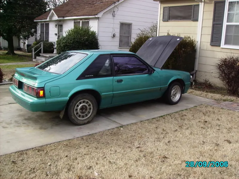

itssss alllivveeee.... ok well sorta iv still got a few lil kinks to work out and then she will be fine, but anyways besides the one legging 4cyl rear end and narrow tires she is pretty quick for the time being im just gonna put a stock cutout hood and a 82 gt hood scoop on it because of clearance issues but anyways ill get more pics and some better quality vids tomorrow but here is a lil shot of what she sounds like
i used a rebuilt 5 speed out of a 95 gt with a new mini starter and ford racing lightweight flywheel and a ram clutch topped off with a steeda tri ax, the fuel sysetem consist of dropping the tank and removing the pump and replacing it with fuel line, inserted a carter in line pump after the filterused factrory hard line up to the drivers side fender well where i routed it up to the regulater and then to the carb, ignitiong system i just got rid of the duraspark box and went with a pro comp hei box makes it easy all u have to hook up is the power, exaust hooker headers flowmaster off road h pipe and mufflers, the motor is a 306 stock heads and a mild cam forged pistons and pretty much mostly stock, 150 shot of n2o, and thats all i can think pf but ask away
