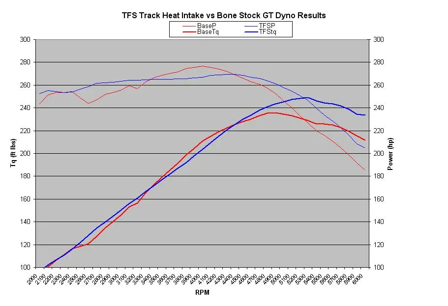

I plotted it for you folks. Makes power after 4400rpm. Pretty good really. Hope the dyno numbers aren't fudged. I will be buying one if not. Will the steeda strut brace clear it i wonder?
