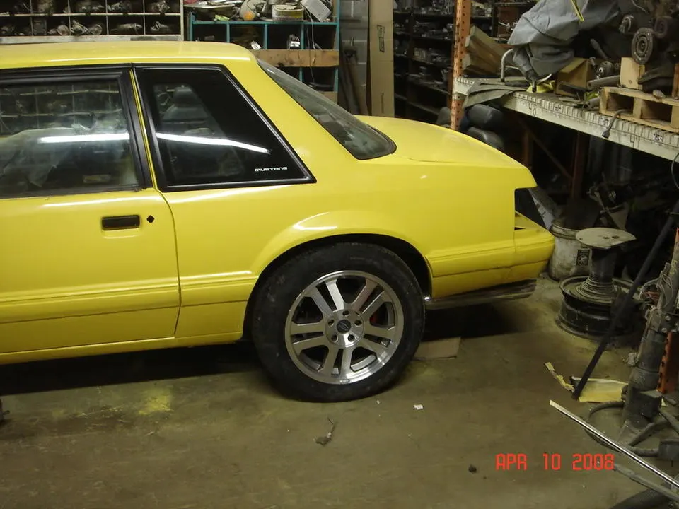

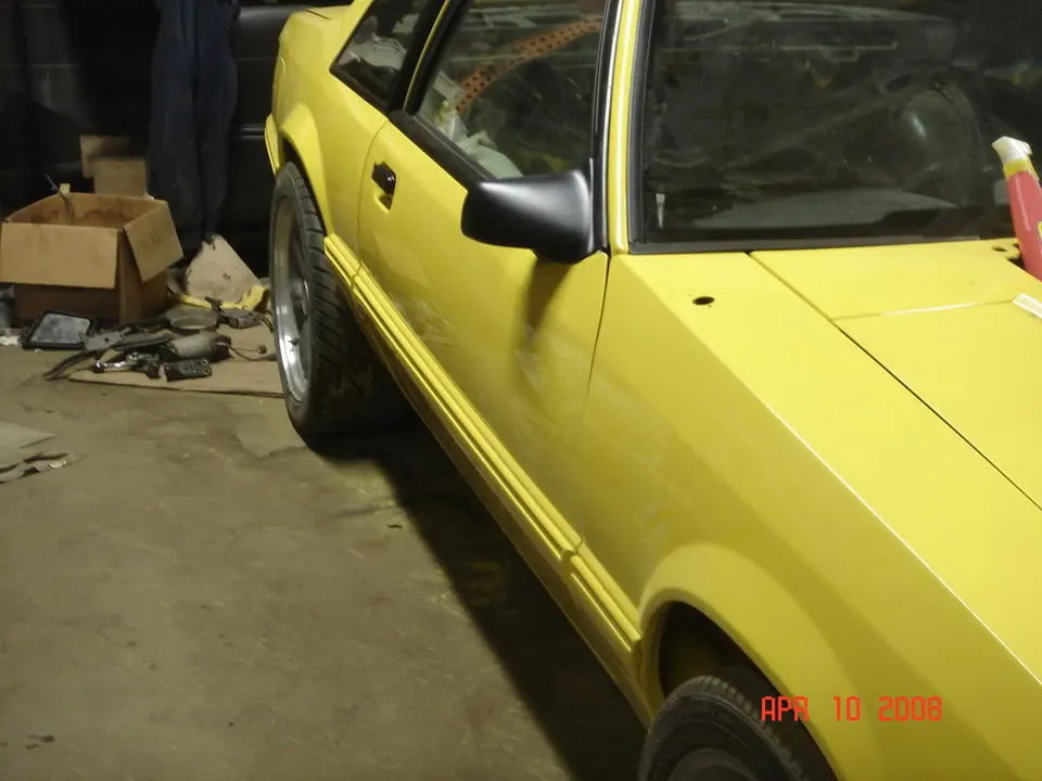

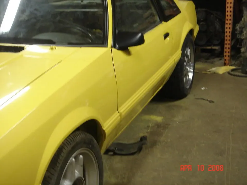

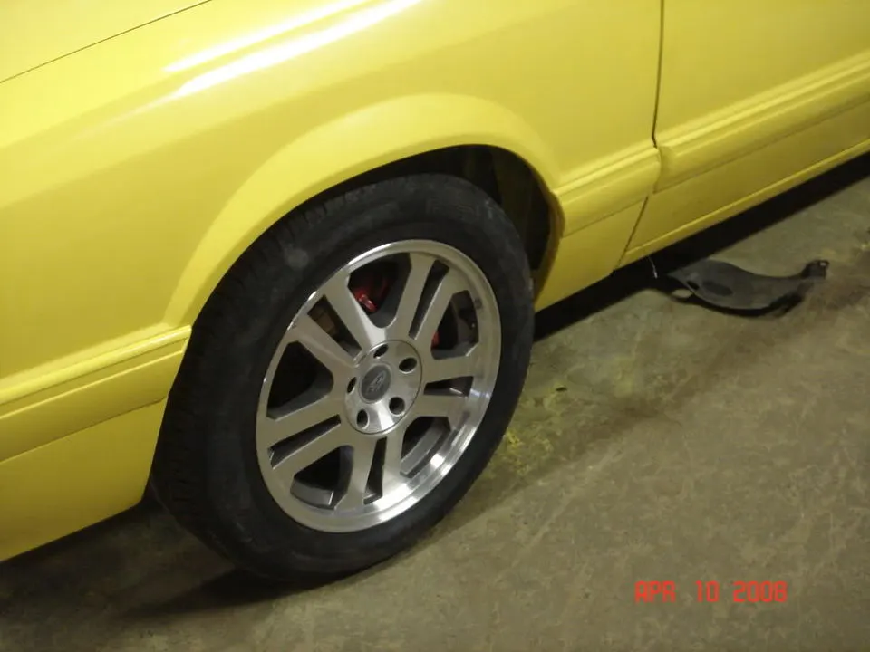

Yes, the 05+ 17X8 wheel and 05+ 17X9 wheels have the same +45mm offset. But see, if you jump to a 17X9, even though the wheel has the same offset, you have to add that additional inch in width, which puts the outer wheel back where you started with a 17X8 30mm offset.

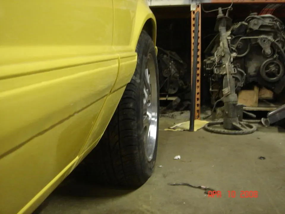

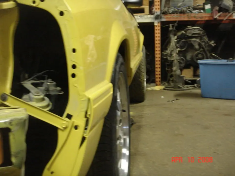

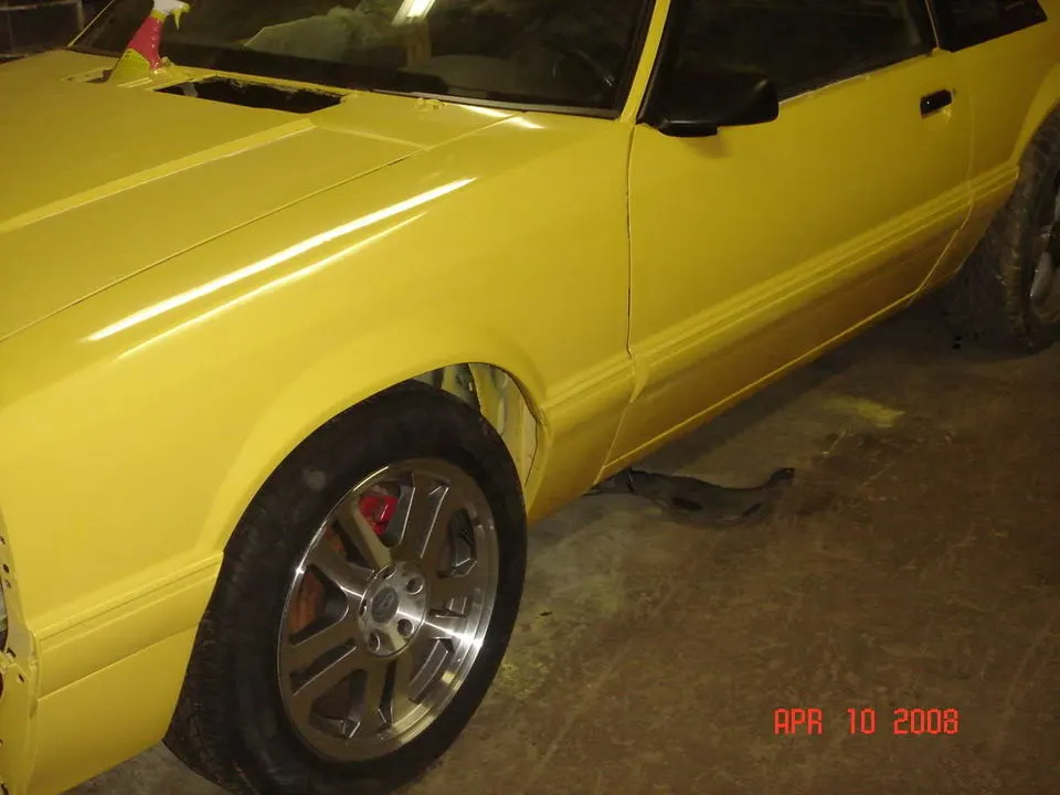

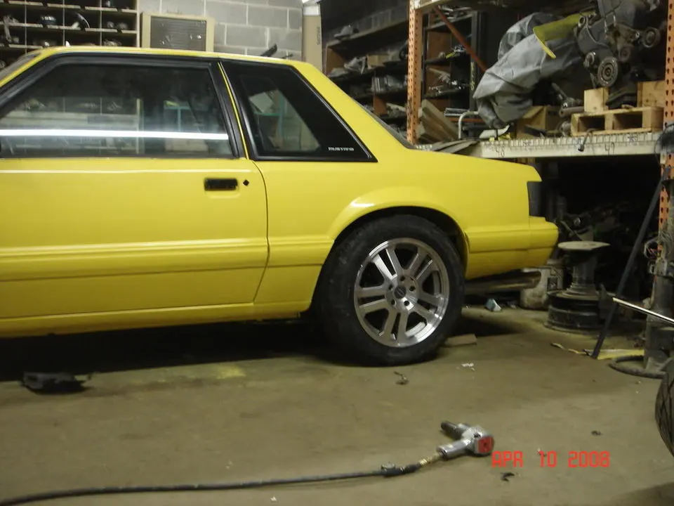

I have 05 wheels, and I put them on the back of my 81....BUT....I have the 2001 axle, which is 1-1/2 inches longer (on each side) than the fox.....which is 3/4" longer on each side than a 94-98 rear end. So....I will show you these pics, but your wheels won't be here.....they will be inward 3/4". Also....these are the stock 235-55's so the tire makes it look as if it is sitting out more than it is. A 245-45 is more even with the wheel than the 235-55's
Compare the above shot with this one. This has stock 17X8 30mm offsets.

So in theory my application (17x9, 94-98axles) should be similar to your #1-4 pics. I definately don't want to run a 17x9 sn95 with my axles as I don't like that pushed out look (realize your last pic is a 17x8 wheel but with axle difference should be about the same appearance).
With your 05 wheels and 01 axle combo did you have to roll the fenders?

In theory, yes, a regular 17X9 (+24mm offset) will be close to pics #1 and #4. They will be very close to the edge.
With my 05 wheels and 01 axles, IMO, the fender lips will still have to be rolled in. Maybe not for straight line driving, but if I took a hard corner, the body roll would make mew nervous. BUT.....with yours being 3/4" inward, you will be fine.
A 235 up front and a 255 out back will work, but 255's on 9" wheels are stretched. I recommend 275's. Let me show you the front pics of my car. I have early fenders too, and with both 17X8 245-45-R17's up front, I still have clearance. I even had clearance with 275-40-R17's on my 17X9 +24mm Cobra R wheels up front.
17X8 +30mm offsets
17X8 +45mm 05+ wheels..Keep in mind though the tall 55 series tires. (This PIC also has the +30mm wheels on the back, so don't let that throw you off thinking the rears are the 05+ wheels....they are the stock 94-04 offset....just look at the front....
