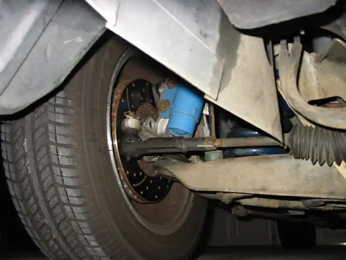

Before you start putting the new stuff on the front, check the shock to spindle fitment. When I went to put my Tokico shocks on the 96 spindles I could only get 1 of the 2 bolts to line up. I ended up having to grind the spindle a bit.
Nothing major just saves time/frustration.
Also make sure you have the right flare wrench for the stock brake lines. And they will be a bitch to get off.
And one last thing. You bought the brake line adapter for the passenger side hard line right?
What year spindles are you using? If your using 96+ spindles you will need some washers on top off where the ball joint mounts to for the nut to tighten.
Yep, got the maximum adapter. Bought a few flare wrenches from autozoo, it's probably the same size as the rears I would assume?
That doesn't make sense about the spindle. Those struts are for 94+ cars, so they are designed to go on that spindle. Are they the same struts that I have?
Ok if your using SN95 spindles you wont need to add spacers to the top of the ball joint.
You cant see it but once the spindle goes onto the balljoint the joint is too tall and needs spacers for the nut to work right.
As for the shocks, I reused the Tokico's that were on the car when it was 4 lug, so you might not have the same problem. But why not check anyways before bolting everything up. The "ear" that the shocks mount to on the spindle was hitting the shock before both holes lined up.
