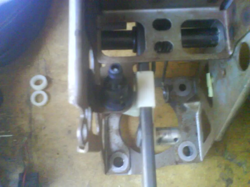

i am swapping my pedal assy. for my aod to 5-speed swap. i noticed on my aod pedal assy there is what looks to me like a vacum operated switch. And on the 5-speed pedal assy there is just a switch.
my question is, what do i do with the vacum hose?
94-95s have the vac switch and the 96-98 pedals do not. Any chance your pedals are not from a 94-95 GT/Cobra?

You mean the one in this picture?
That switch is for the cruise control. Just transfer the switch and any other needed parts over to the 5-speed assy. There should be a spot to mount the switch the same way it is on the AODE pedal assy.

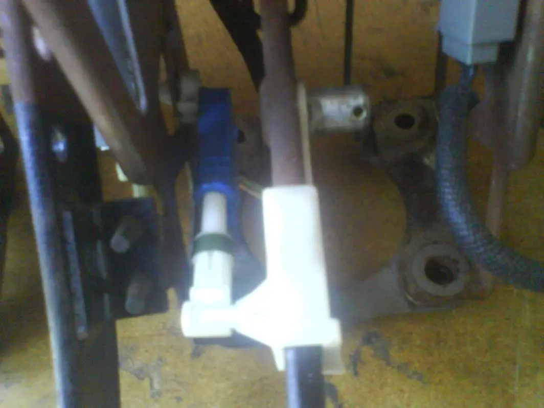

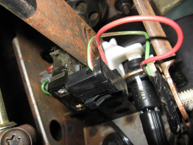

i have taken some pictures myself. i want to know if i have the right pedals. there is no spot to put the vac switch on my 5 speed pedal. is there a way to make this work

ok this sucks. i went and looked at a picture 94-95 pedals and turns out that i have a set for a new mustang. This really blows because i have to drop the car off in a few days and i need to have all the parts.
Is there anyway to make this switch work or am i screwed.
your the man. all is well now.
i hope you didn't dive under the car to take that picture on my account. if you did that was cool of ya. i owe ya one
Easy enough top take photos, just stick a digital camera under the dash - no need to crawl under there. :nice: Sorry to hear about the wrong pedal assembly, I don't know if you can swap things around and make it work. The best bet is to put off the swap and get the right pedal set. :shrug:
