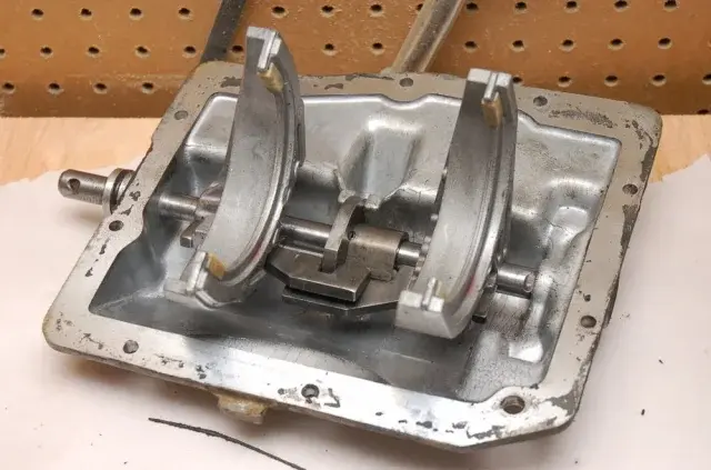

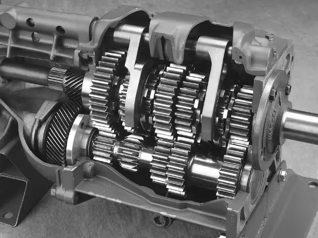

Shift forks attached to sliders (this is a modified T-5 but its the best I could do on short notice):
Shift forks attached to top cover on a T-5

See that little lip on those two forks. Those two little pads on each are all that controls the sliders when changing gears, when a fork breaks. That little lip breaks off the forks, its just a cast part, and the slider remains engaged to the gear... Its not extremely difficult to fix but the transmission must come out and be taking apart to do so if that is your issue. Simply putting the shifter in neutral and releasing the clutch should tell you if its.stuck in gear or not. There are plenty of YouTube videos on it out there. Its a 79 with a 5spd I am assuming some one swapped a t5 in at some point and its a cable operated clutch so no slave cylinder.
