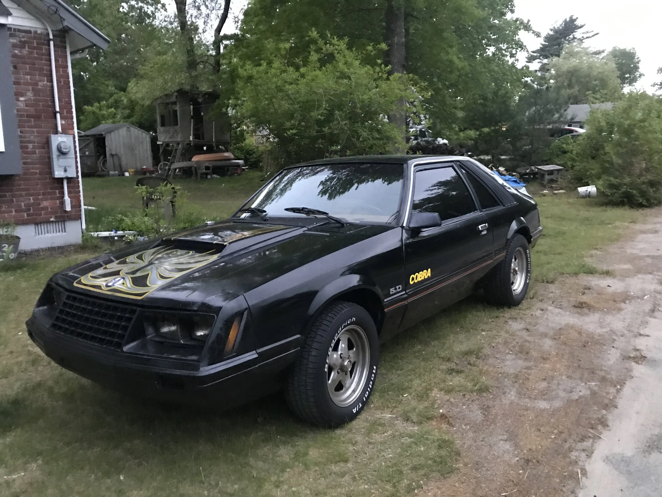

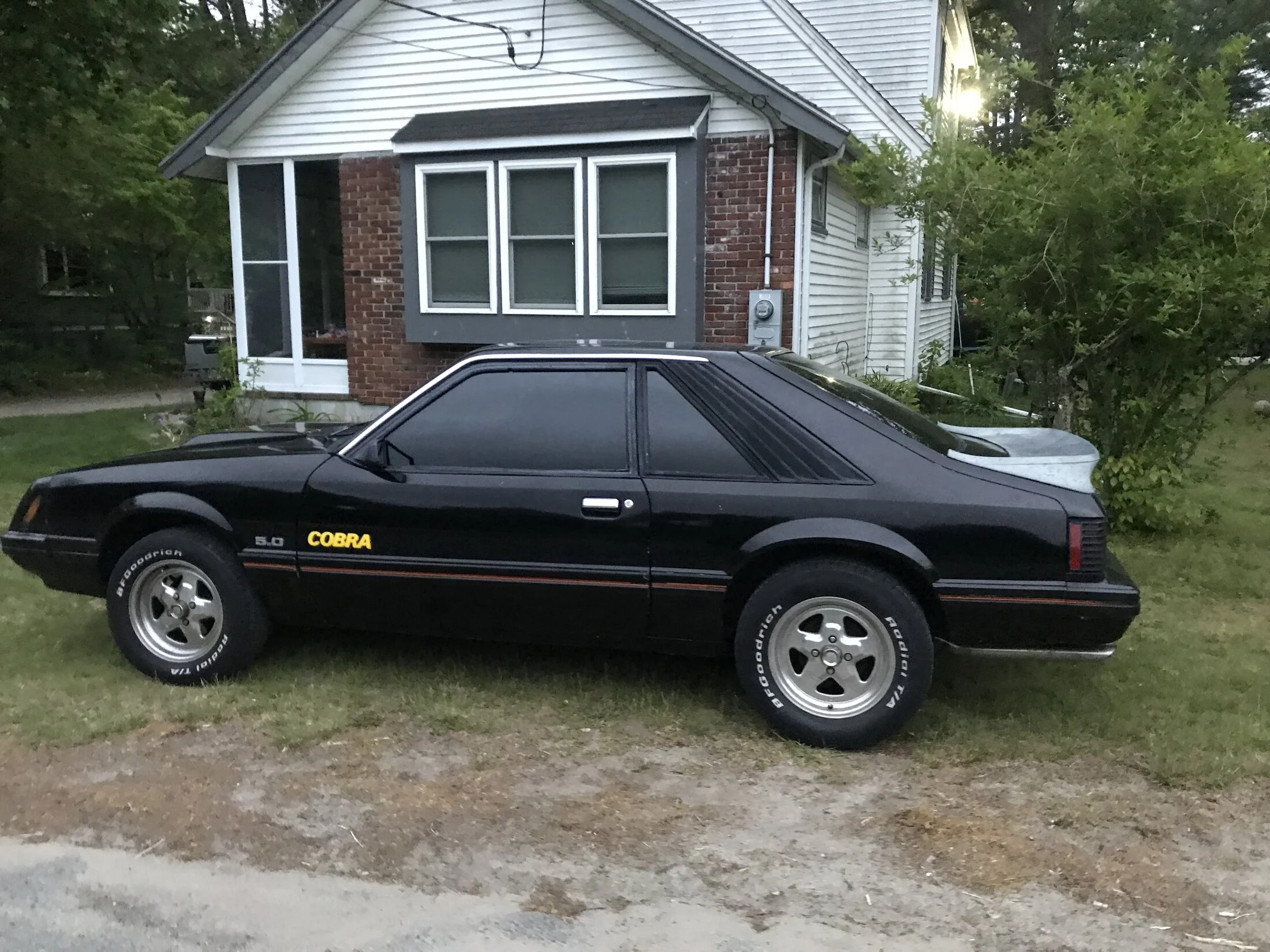

It is a 79 cobra with chamois interior so yeah that color has been to find. According to the seller, the body has 63000 miles on it and he put in a 304 that supposedly has 3k on it. I think he was pretty hard on it and liked to do burnouts and whatever but overall it is in fair shape. right now it needs dumb stuff done to it like the tilt steering replacement, e brake cables, reverse/brake lights not working but otherwise it starts right up and sounds nice but im worried about the transmission issue.
I had an 89 that I sold. ended up having to put about 2k into that and still made profit so we'll see with this one.
