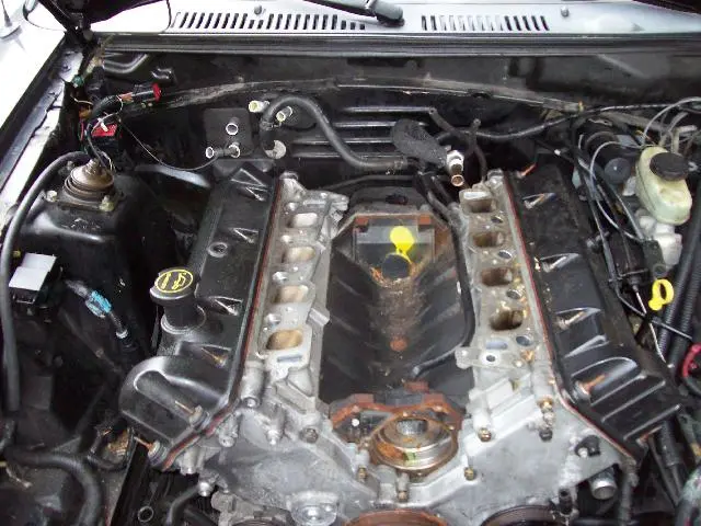

ok going to keep it going some changes i had to make to parts line up
just ordered and will take pictures of once they get here :
patriot stg 3 heads (1500.00) shipped
mmr 900 shortblock (3600.00) shipped (3 week turn around)
w/side bolts,arp main studs,upgraded oil pump,arp rod bolts
head change kit (117.00) shipped
new motor mounts and tranny mounts (170.00) shipped
will order in the next 3 weeks
cams comp stg3 blower cams or mph blower cams (600.00)
flywheel 8-bolt alum. (370.00)
upr upr k-member kit (700.00)
and a may need comp springs not sure if patriot springs will work with stg3 cams
ok i ordered most of the parts i will need for my goal
looks like i am going with the following parts so wish me luck
mmr900 shortblock
patriot stg2 heads ------( was told that stg3's will not work with motor if its not .020 overbore )
comp valve springs
mph blower cams
alum flywheel 8-bolt
head change kit
arp head studs
also going with cam sprockets
and a new timing cover
all the timing parts like chain and tensioner i will move over from my stock motor
i think every thing is covered as far as putting the motor together
tools i am using spring compressor tool,fuel disconnect tools and timing tool to make sure i get the timing dead on
going to hold off on the k-member kit atm
so i am now just waiting on everything to get here
its head tring to work on you car when your working long hours at your job and you dont have a garage :D
i sure as hell cant drop the tran and pull the motor in front of my house on the street so stripping the motor down as much as i can before i have it towed any ways i still need to get to the timing componets to transfer them to the new motor
prblem i cant get the dam crank pull bolt off the car has been sitting for months but when i go to turn the bolt even in gear the dam car starts to roll:rlaugh:
